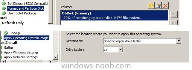

So here is what I'm trying to do: I have an old Windows XP with some user and users files and two logical partitions - C and D. What I'm trying is to Deploy Windows 7 with hardlinking (save all users accounts and users file) and do not touch D partition!
When I'm trying this with only C partition - everything goes fine - hardlining works, users saves, but when second partitions appears - nothing works at all! After deployment there is only only partition C and only Administrator account!

To left out(should not format)the other partitions like D,E .I removed the action in TS i.e format and partition disk bcz it does the job of formatting all the drives and make new drives and you have an option to install OS on particular Drive.See below the snap shot.
