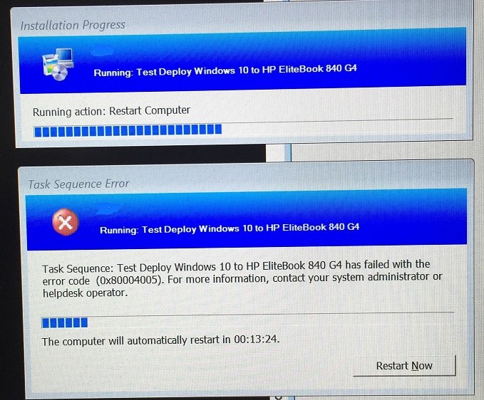

When i boot from flash, deploying started, but when deploymet come to restart stage, there are error.
OS is x64. SMTS.log lies in c:\_SMSTaskSequence\logs and has a futere date (for Example: deploying was 31.07.18 in 16:50, log have date 01.08.18 3:17).

What does your environment look like?  Do you have Management points that are a different timezone and those management points are alphabetically higher?     We have the same issue as we have MP in Australia, and in the US.
Management Point AUstraliaCM comes before UScm.
Edited by Crash
Crash, no. Timezone is the same. We have one sire and two servers. 1 have all roles, 2 - Distribution point, Mangement Point, Component server, site system.
Date is actual ib PC's BIOS.
