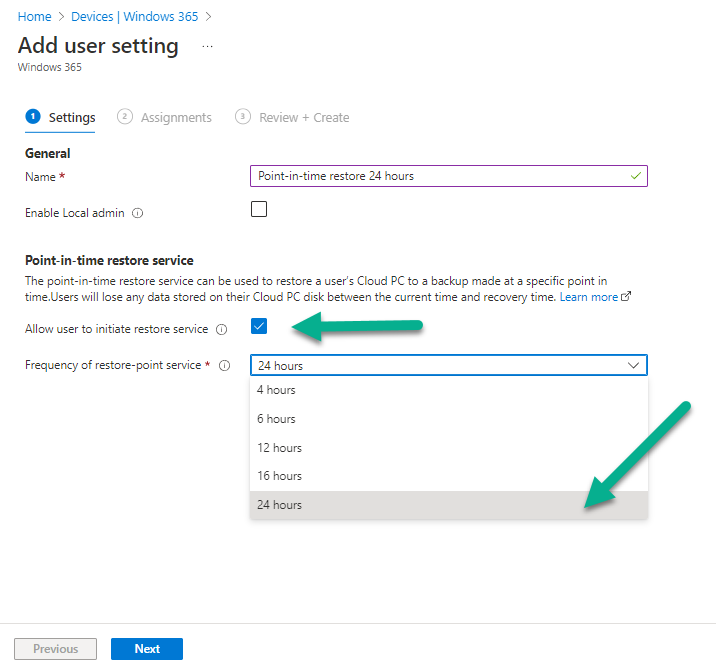

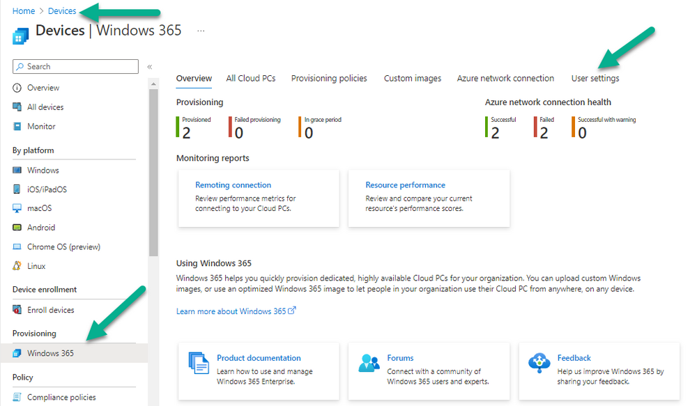

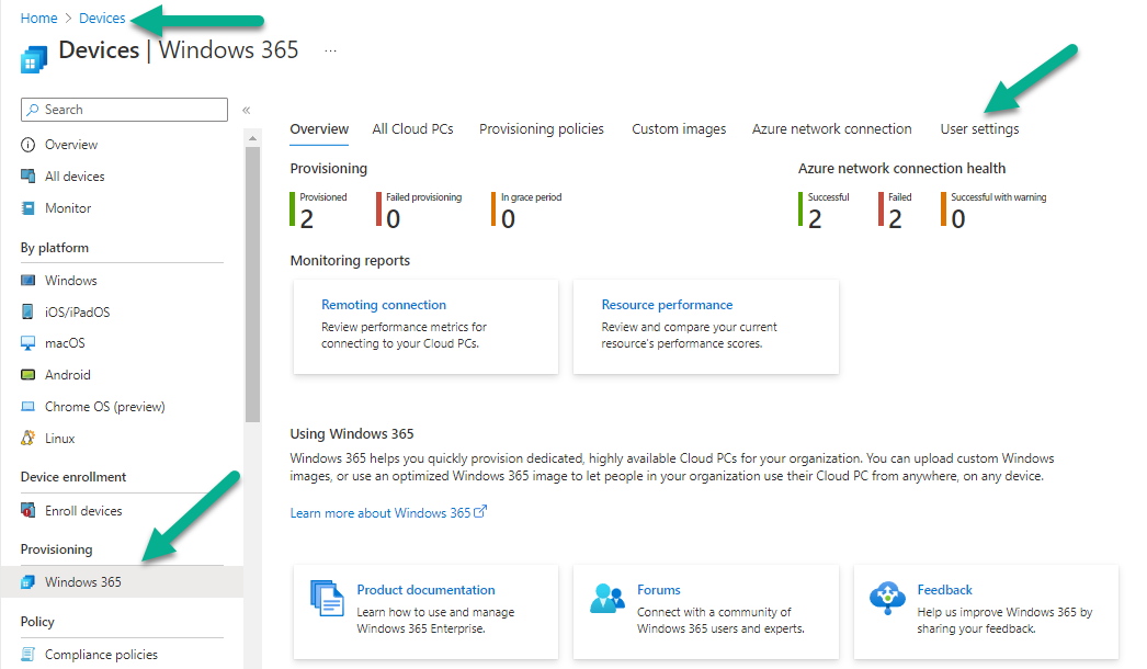

In Microsoft Intune, navigate to Devices, Windows 365 and click on the User Settings tab.

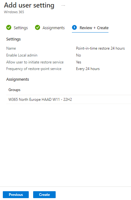

Click on Add + and give your User Settings policy a suitable name, keep in mind that if you have multiple policies targeting the same users that there is no way to currently enforce one over the other. In this example we'll configure the restore points every 24 hours (the default setting is every 12 hours), which means one restore point every day. You can also configure whether the user is allowed to restore their own Cloud PC via the Windows 365 portal and you can additionally configure Local Admin Settings.
Click Next and then add one or more groups with Users that you wish to target with these settings.
When ready, click Select, then click Create.
Once done, any users in the Groups added will be able to restore their own restore points and their restore points will be taken every 24 hours.

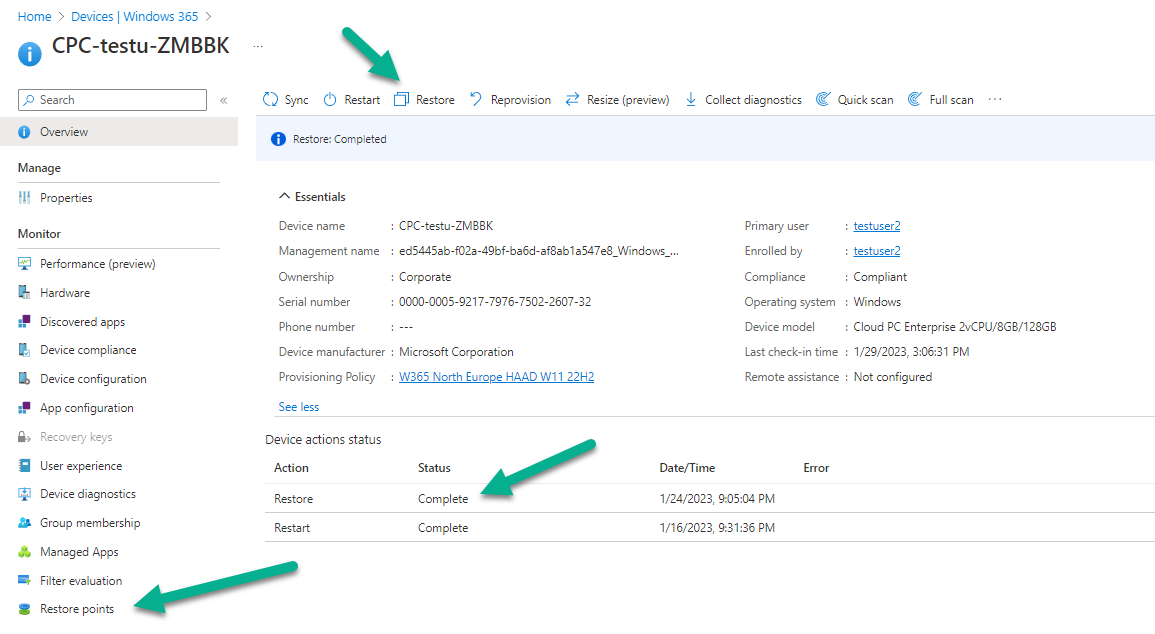

Restoring a single Cloud PC
To restore a single Cloud PC simply locate it in the Endpoint Manager console selecting Devices and then clicking on Windows 365, next select All Cloud PC's and select the Cloud PC you wish to restore. Notice that there is a node on the left called Restore Points. You can access the same ability via the Restore option at the top of the screen and the last previous Restore action will listed in the summary.

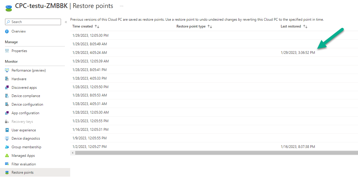

Click on Restore Points in the left pane. This will bring up a new window showing all restore points that have been taken for the Cloud PC.
In our testing, the Restore Point type and Expiration date columns never populated with any information. We have informed Microsoft PG about this, however, the Last restored column does populate after a restore is completed.

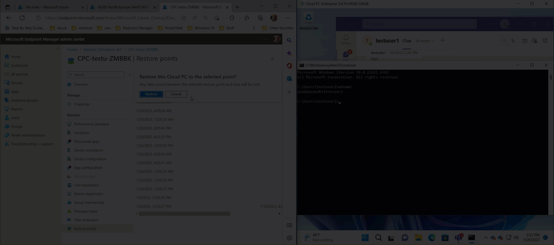

Note: Be careful when restoring a Cloud PC as no indication/message or information will be sent to the user logged on that their Cloud PC is about to be restored. They will simply see the computer shutting down all of a sudden and after that it will be inaccessible for a time.
Keeping in mind that Cloud PC's that are domain joined may have rolling passwords/secrets that change causing you to lose the ability to logon to the domain if you restore a Cloud PC from too far back. So let's pick a fairly recent date in the above list and right click, you'll get the option to Restore this version. Continuing the process will give you one last chance to cancel, and if you select restore it will start the restore process which can typically take about 30 seconds.
You can see an edited (shortened) video of that process below:
After the restore is complete, you can refresh the Intune console and the Last restored column should now indicate the latest restore.

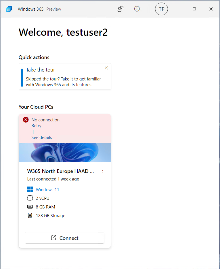

The end user may see the following in their Windows 365 app, indicating that there is an error connecting to their Cloud PC.
Clicking on details may give you some information like the following.
Quote
Your session was disconnected. If this keeps happening ask your admin or tech support for help.
Error Code: 0x3000046
Error Message: Gateway does not have resource to assign to the connection
Timestamp: 2023-01-29T14:53:02.671Z
Activity ID: 1d435b62-b3d7-465c-85fa-84ed545b0000
Waiting a minute or so and clicking on retry should be enough to reconnect.

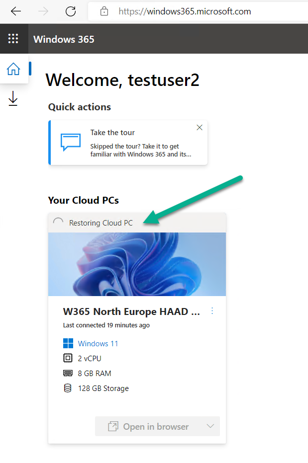

If the end user accesses the Cloud PC using the Windows 365 portal, then they'll be correctly informed that the Cloud PC is in the following state: Restoring Cloud PC

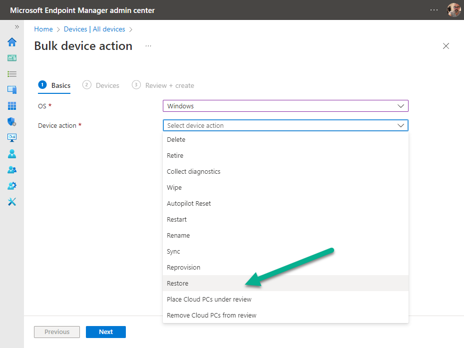

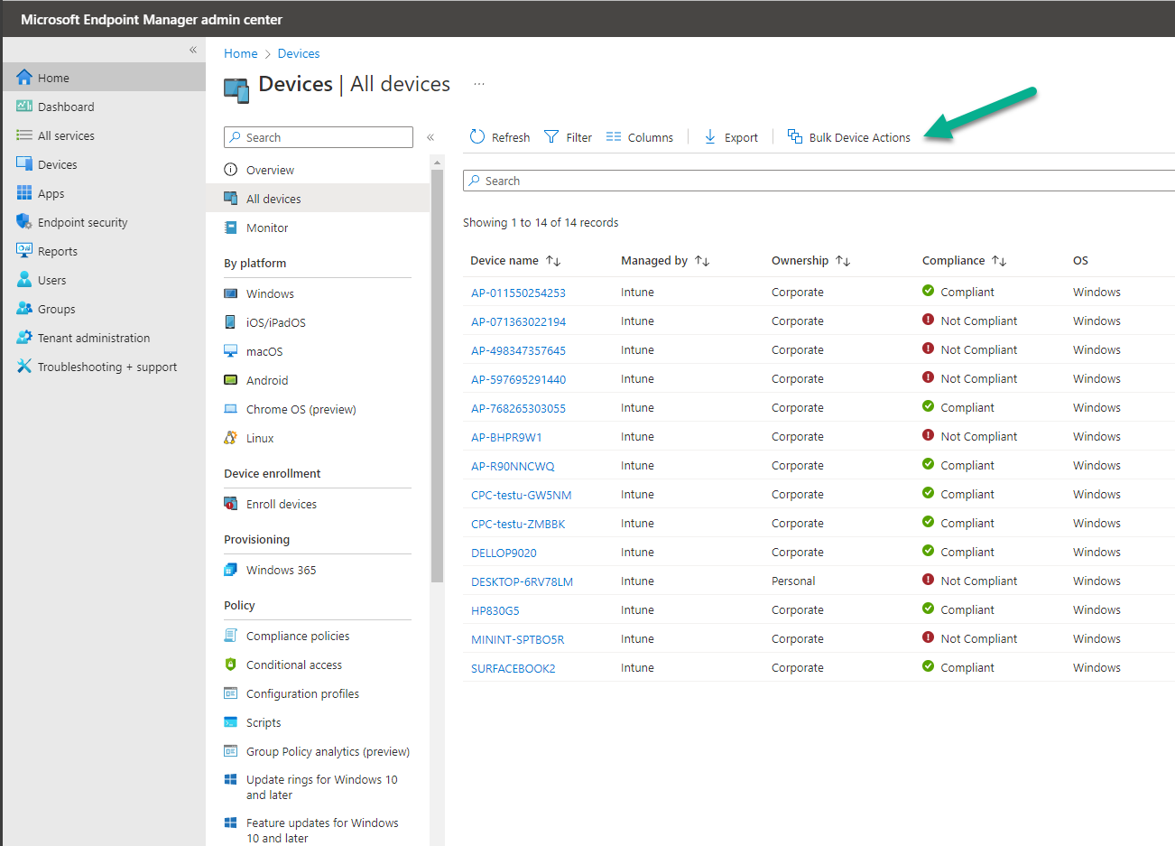

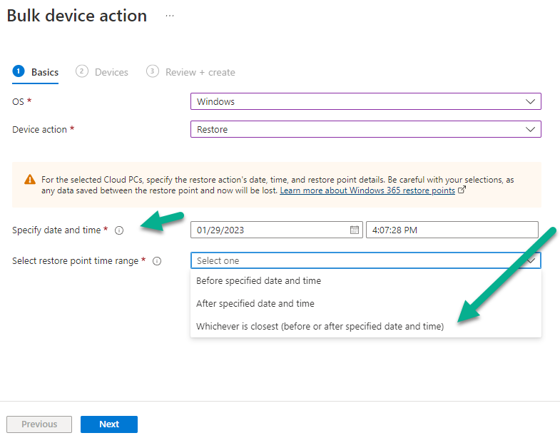

When an admin needs to restore multiple Cloud PC's at the same time (up to 100 at a time) then Bulk PC actions are to the rescue. Let's take a look at that process. In Microsoft Intune, select Devices, and next select All devices. In the top field you'll see Bulk Device Actions.
Click on it and it'll bring up the Bulk Device Actions menu. Select Windows as the OS and then select Restore from the options available.
Next, select the date and time and the time range from the available options.

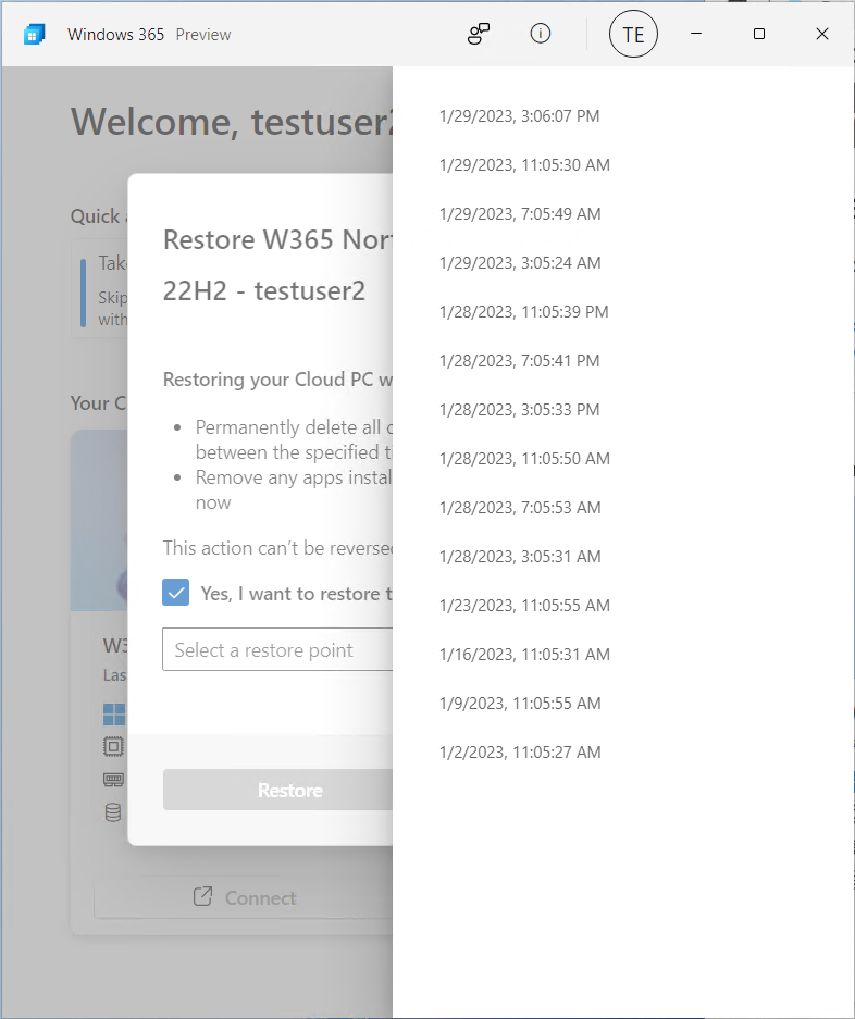

End user initiated restore

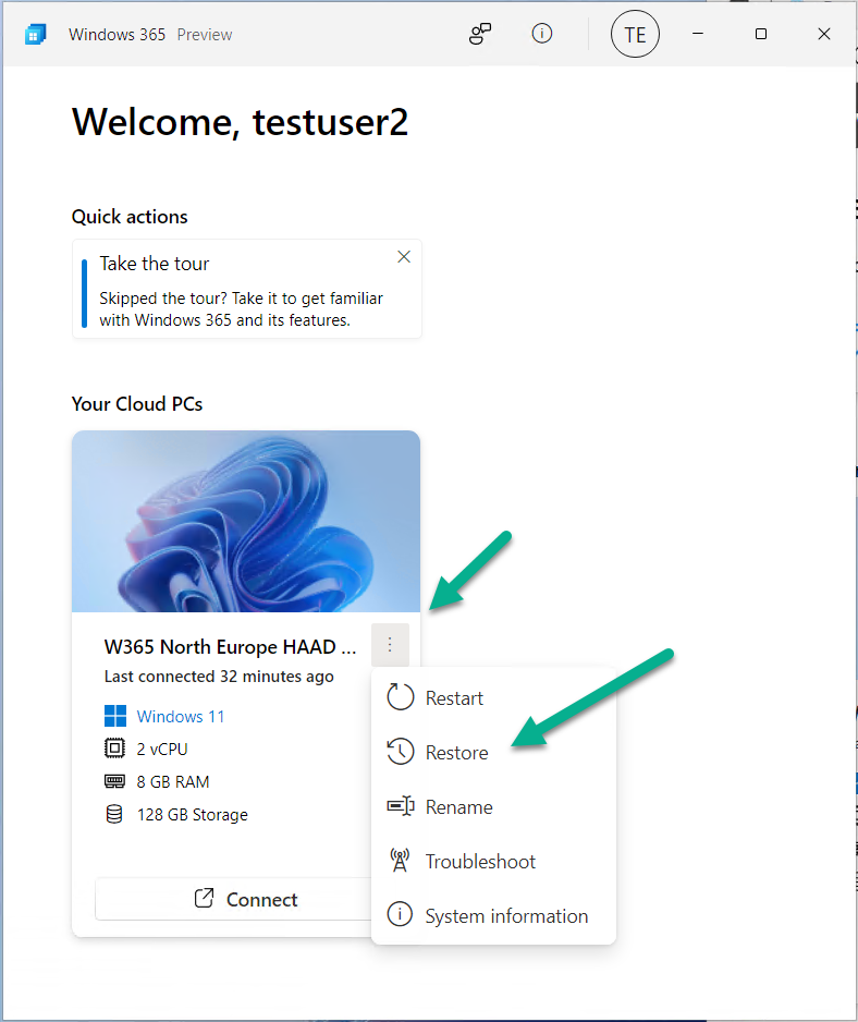

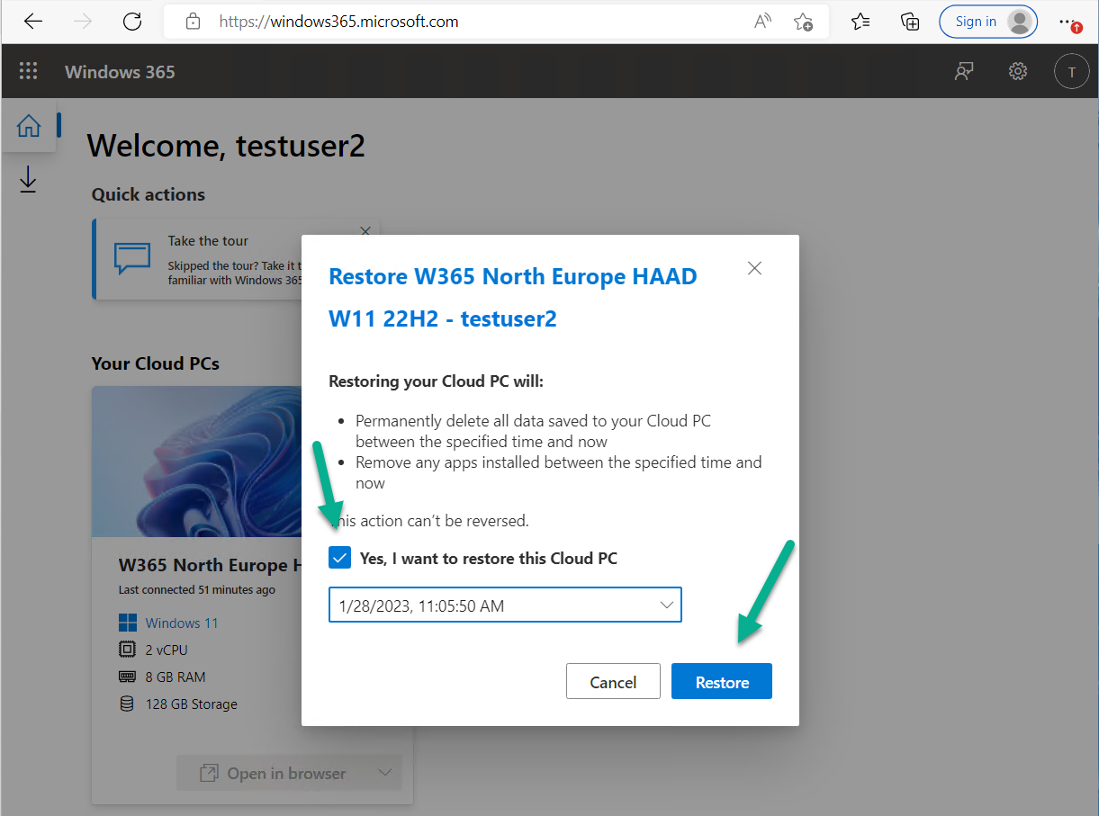

Now that you have seen how an admin can restore one or many Cloud PC's, what about the end user's view of things? The end user can restore their Cloud PC either using the Windows 365 app settings or via the Windows 365 portal.
In the Windows 365 app, the user can simply click on the 3 dots to gain access to user-initiated actions.

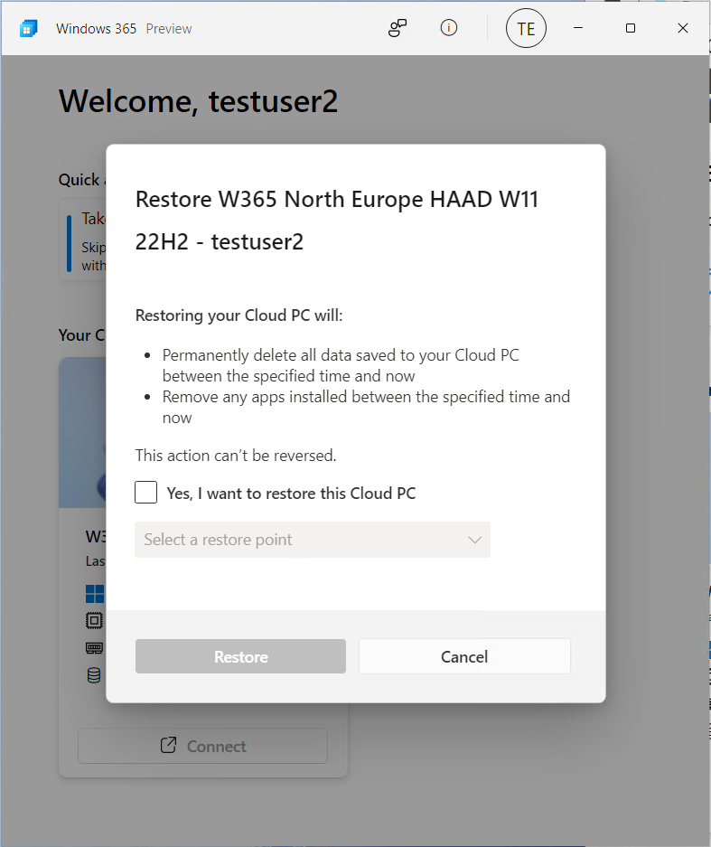

After selecting restore, the following window will popup informing the user about what is about to happen if they continue and asking them to confirm the action.
After confirming, they can select a restore point
before finally clicking on Restore to complete the action.
