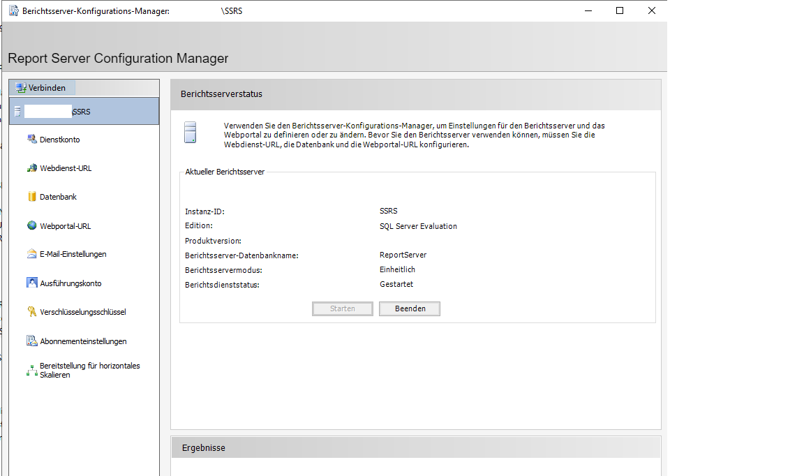

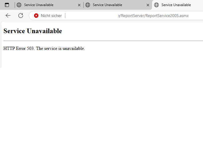

when i click on Report server configuration manager >Webportal URL i am getting error http 503
Http 503
In site server > Reporting service Point has been Removed and installed again,
SRSRPSETUP
srsrp
Report Server Configuration Manager > Data bank was re-configured with no errorReport Server Configuration Manager

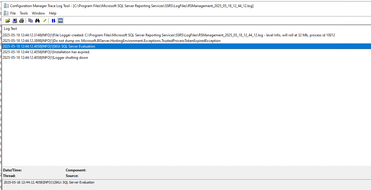

i found something strange in Scale out deployment "Server is not showing" Scale out Deployment
Component status showing critical error.
Report Service Point
SMS_SRS_Reporting_point have warning it says - The Report Server Service is not running on the service point server . Start the service to activate reporting. ( i have re-run the services of Sql Reporting Service.) still same error with http 503
