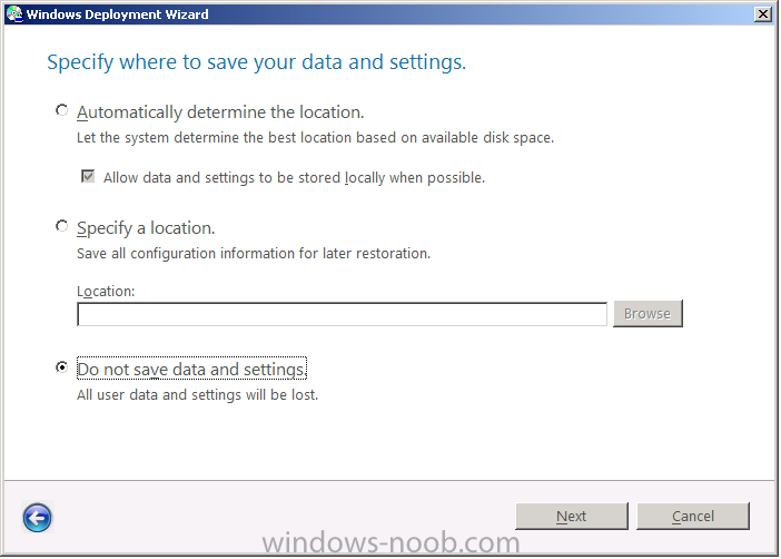

Johnny 1 Posted June 8, 2011 Report post Posted June 8, 2011 Hi guys, a real noob here when it comes to this, my boss in the last couple of days has asked me to look into and get working a valid deployment solution for Windows 7 onto our existing Windows XP infrastructure. Now, I have already setup so that I can boot to PXE and install the .wim file thus creating a new Windows 7 PC, however, I need to use USMT 4.0 also. What I would like to be able to do is the following: Boot Client PC to Windows PE (which I can do) Capture User Data (No Idea) Install Windows 7 image (working) Restore Data. Is this even possible, or do I have to do it some other way, I have no idea how to create a task like this in my Deployment Workbench. Any help would be greatly appreciated. I've been reading about this for 2 days now and my head is spinning! Quote Share this post Link to post Share on other sites
thadkew 5 Posted June 9, 2011 Report post Posted June 9, 2011 You can do this, however, you wouldn't do it in the way you detail. Make sure the Customsettings.ini has the line: SkipCapture=NO First: you'll need to boot into the PC as an administrator. Second: you'll need to get to the LiteTouch.vbs script from the server Third: If you're doing a hardlink, select "Automatically determine. If not, select the capture and put it somewhere you'd remember (If you're going to put it on the network). Watch it run. Test that out. Hope it works. Quote Share this post Link to post Share on other sites

thadkew 5 Posted June 10, 2011 Report post Posted June 10, 2011 I assume you have installed USMT through the Information Center/Components (if you're going from XP to 7, i think you need USMT 3.0.1 but i'm probably wrong. It wouldn't hurt to have it anyway) I also don't see this line in your CustomSettings.ini (put them in) USMT4=YES Quote Share this post Link to post Share on other sites
