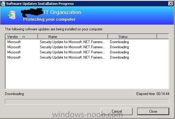

hey guys,
i have decided to update my servers like i update my workstations with the software updates..
problem is the my updates stuck on the same phase and cant download the updates.. :
i looked on the topic here :
http://support.risualblogs.com/blog/2011/03/03/security-update-for-microsoft-net-framework-4-stuck-at-66-downloading-on-sccm/
and re download my updates and re-update my DP, but still it dost not work...
also i looked into the logs and did not see any error it just hangs for hours in "download" mode..
any idea?
Have a look to see if those updates include various languages. If they do, redownload the updates selecting the languages that are included and hopefully it should work.
thanks but i think the problem was that the site boundaries were a little bit messed up
