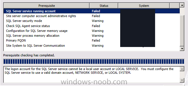

I am trying to install SCCM 2012 using a remote SQL Server 2008 R2 with all the updates. When I get to the Prerequisite Check section, I get Failed statuses for SQL. See Attachment.

What OS are you installing ConfigMgr on? I ran into this exact error because I was installing configMgr on 2008 R2 w/ SP1 and it does not like SP1. Reinstalled 2008 R2 and it was fine.
For the SQL Server it needs to be at least SP1 and CU4 but it sounds like you should be fine for that one.
