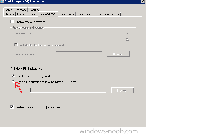

I have seen in some organizations where they have changed the standard System center config manger background to something else, i mean this background:
I would like my own background, does someone know how to change that?
/K
I think i found it, it's called winpe.BMP and it's located here:
C:\Program Files\Microsoft Configuration manager\OSD\bin\i386
I will try to replace it with a custom BMP and see if it works!
Hi Kingen
You do this here:
Rocket Man
I will try that ty rocketman!
