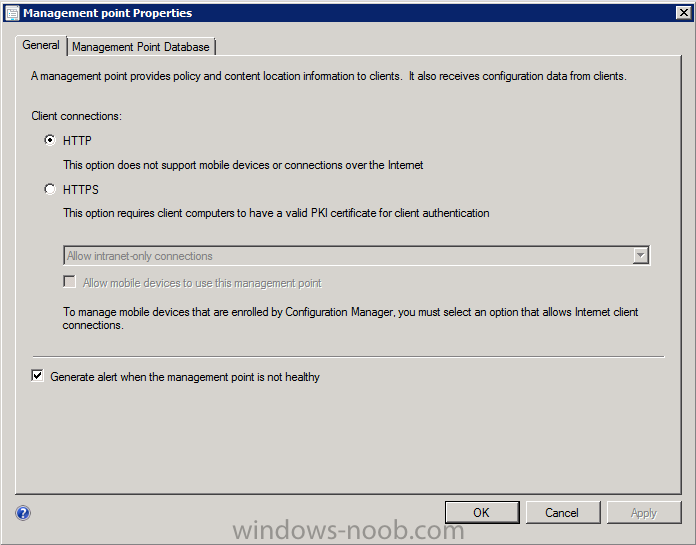

Hey Niall!
They are configured for HTTP. I've attached screenshots of the MP config as well as the component logs. Thanks again for your help. You are incredible!

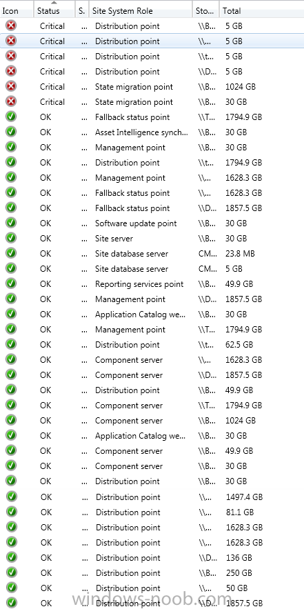

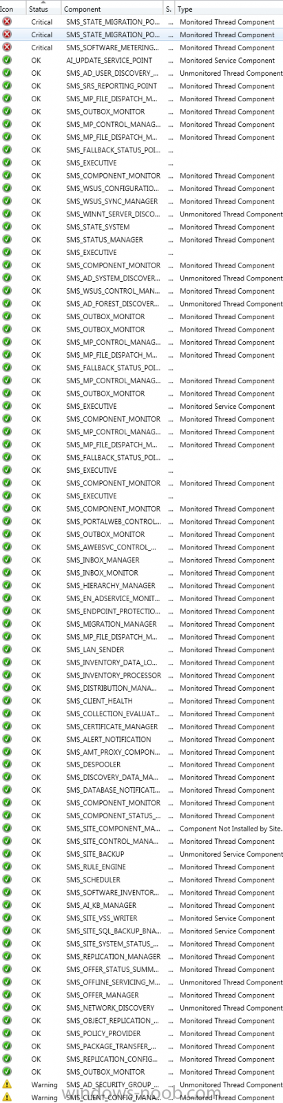

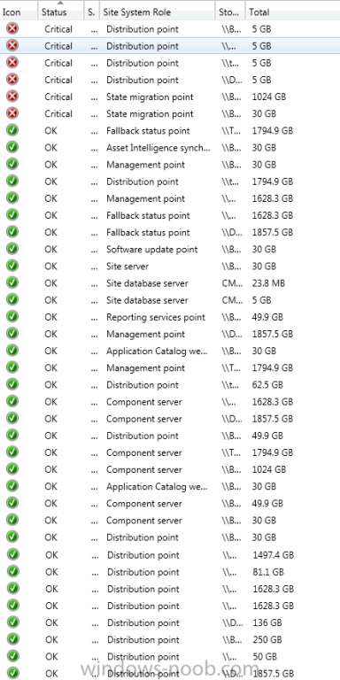

and once again, in monitoring, system status, component status, are things looking all green or mostly red ? any obvious issues in there (like management point being dead ?)
No kidding...
Here, I'll just show you...
I've always had issues keeping Dist Point out of the red since I have automatic client site deployment enabled and it errors if it can't reach one machine seemingly. The other errors are really just software metering and the SMP I'm discussing.

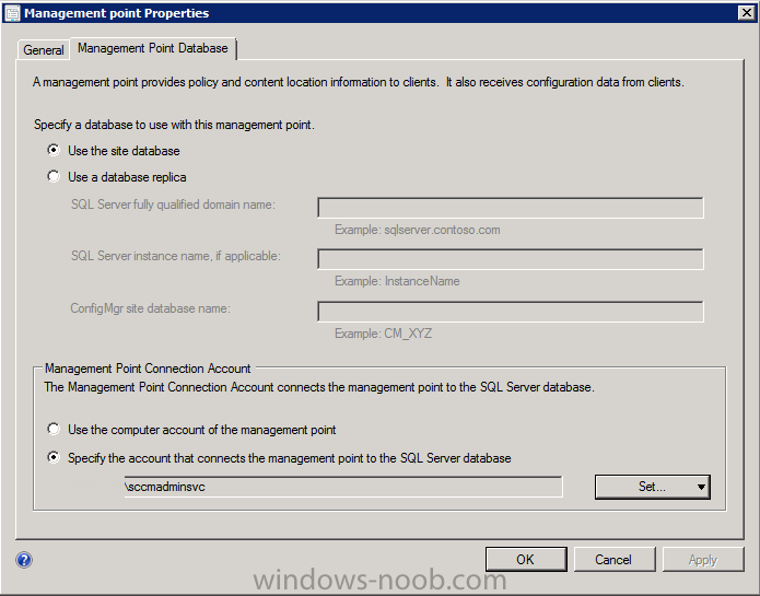

Any reason as to why you have changed the account that connects the MP to the SQL database from been the local computer account to been a domain account??
Is this a prereq for SMP?

No - No reason that I've changed the accounty that connects MP to SQl other than the domain account used was set up as a full local, domain, and SQL admin for that database. I use it for everything including deploying clients. Is that not suggested?

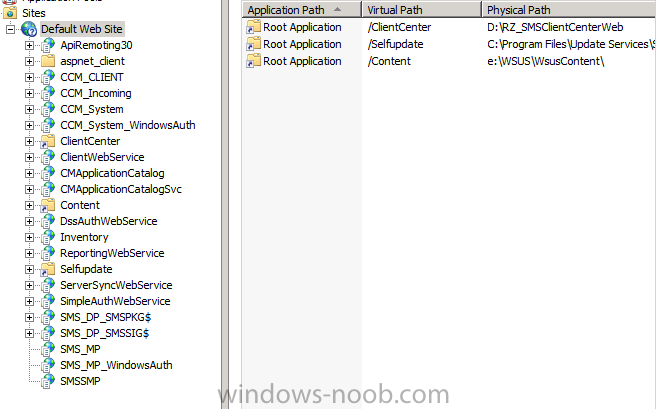

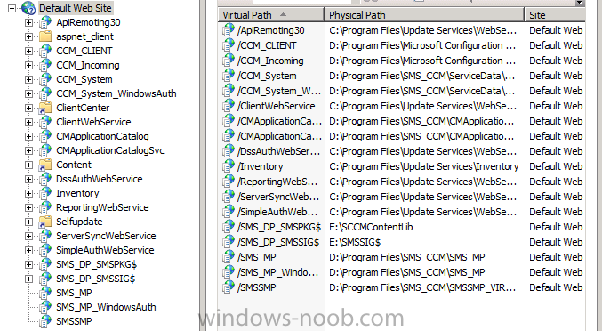

Windows Auth in IIS - I just verified that it is installed on the primary sccm server (also an MP). When you say you enable it as it's disabled by default, where do you mean exactly. Here's how each item in IIS is set currently:
Windows Auth Disabled: Main IIS (Above Application Pools), SMS_MP, SMSSMP
Windows Auth Enabled: Default Web Site, SMS_DP_SMSPKG$, SMS_DP_SMSSIG$, SMS_MP_WindowsAuth
Note: I just now enabled Windows Auth on SMSSMP to see if that helps...
As for the PS IIS Website, do you mean PowerShell IIS Website? If so, I don't have that installed.

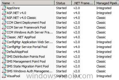

Note: One thing that I just remembered that may make a difference. A while back, I installed Orchestrator onto the same server, but installed it afterwards. I don't think it's still resident in the server at all, but may have changed some IIS settings???
Below are some more details of my IIS on that server...
