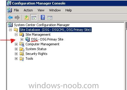

thanks. but what if it isnt working(PAGE CANNOT BE FOUND)
the sitename is the name below the container site management??(system center configuration manager/site database/site management)
If so, i think i got a problem because that name is ABC - Town
This is one way of finding out your sitecode:

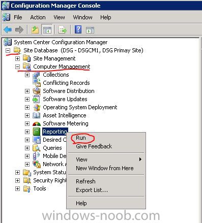

This is how to open your reporting point:
open: Computer Management --> rightclick Reporting --> Choose Run
