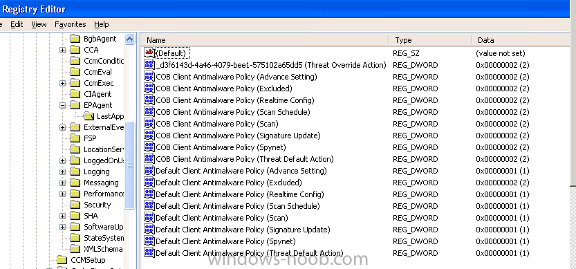

are these Configuration Manager 2012 SP1 clients ? have you verified what antimalware policy they have applied ?
Sorry for the late reply i apparently am not subscribed to this thread so i got no notification about replies.
To answer your question yes these are all Config Mgr 2012 SP1 clients.
As far as what antimalware policy they have they do in fact seem to have the correct policy being applied.
I checked this post you listed: http://www.niallbrady.com/2013/02/17/how-can-i-determine-what-antimalware-policy-is-applied-to-my-scep-2012-sp1-client/
Her are the results of verifying using the registry method (ive also verified looking at the ccm console for the specific client) .
The odd part like i said was that i have clients that work just fine and download the initial update and then others that don't.
