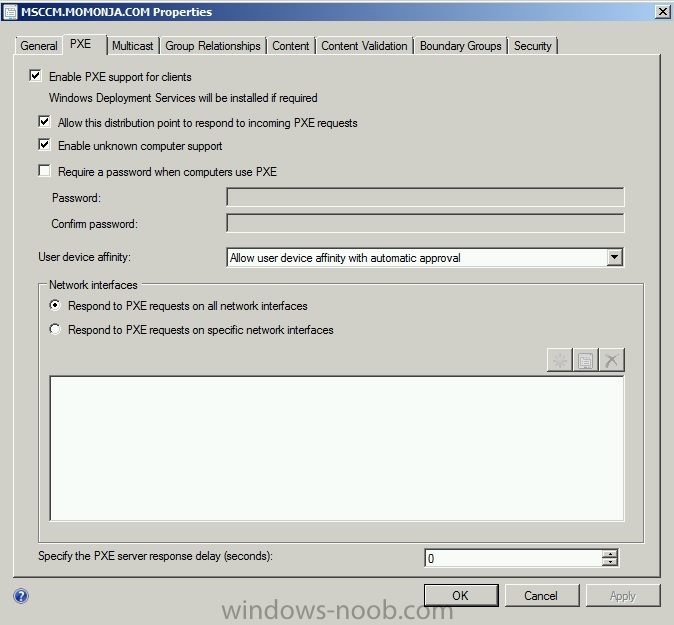

1. Enabled PXE in both distribution point and boot images

No, don't touch WDS, as even though the setting says not to respond, there is another setting you have set (assuming you followed anyweb's guides), which says to respond from SCCM:
As far as I know, that should be what you need to allow WDS to respond.

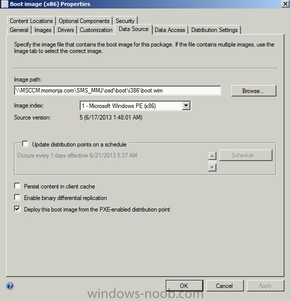

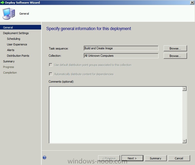

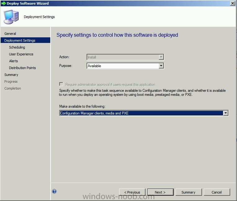

There are three places you need PXE enabled for your computers to be able to successfuly boot to PXE for imaging:
From anywebs post on deploying W7:
for Deployment Settings keep the deployment as Available (optional) and make sure to select Make available to boot media and PXE, that makes it three places that you need to select a PXE option:-
* on the PXE tab of the distribution point properties
* on the Data Source tab of the boot image
*on the Deployment Settings of the task sequence deployment
Make sure they are all set.

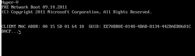

Is this a VM or real pc that you are booting to PXE?
When you try to boot, does it have any error? Does it retireve an IP Address? Does it start to load anything, or just fail?

Thanks for replying to my queries. After doing what you told me still the Client is still not booting up to SCCM PXE. I am using Hyper V for my test environment, the settings for the NIC is legacy and when I setup another WDS server, it was able to boot from PXE but when I shutdown the other WDS (for testing) it wont boot from SCCM PXE.

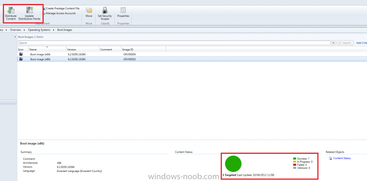

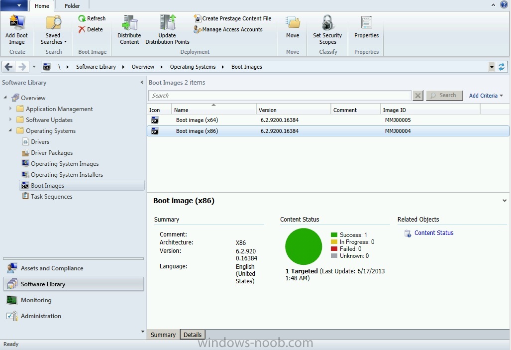

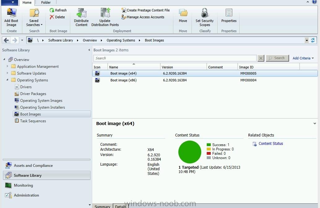

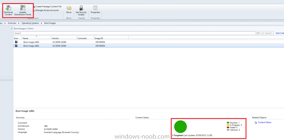

Just had a thought, are the boot images deployed?
If it is greay, red or yellow, that will be the issue most likely.
Just distribute them in that case. Do it for both x86 and x64.
Just so you are sure, this is found under "Software Library\Operating Systems\Boot Images" unless you have changed it all.
Phil
Hi Edenost,
I already distribute both boot images to the distribute point, but still I can't get it work.
Please see attached images.

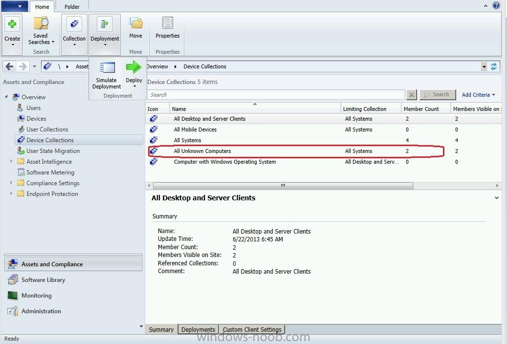

My only unknown computers is the default device collection unknown computers which is both x86 and x64, or do I have to create another collections?

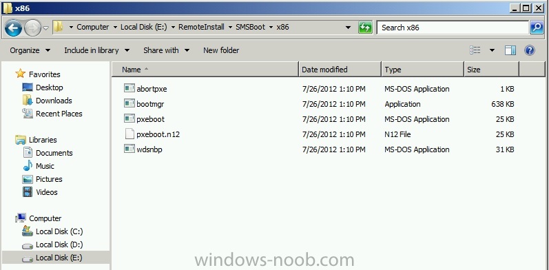

Are the extra directories created in the remote install folder of your PXE server? SMSBoot etc...
Are the extra files inside the SMSBoot directory? abortpxe.com, bootmgr.exe, pxeboot.com, pxeboot.n12 and wdsnbp.com?
Is your VM getting an IP address from your DHCP server?
What is the error displayed when trying to PXE boot your VM?
- yes it is, please attached images,
- no it doesn't get any IP address, but like I said when I open my WDS server w/o SCCM it receive an IP address and a PXE boot.
- boot failure. Reboot and Select Proper Boot Device or Insert Boot Media in selected boot device.
