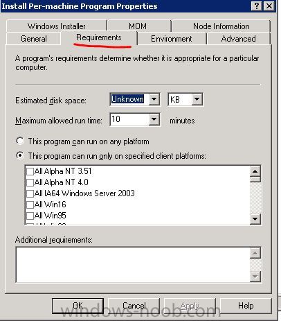

Can´t fully understand how you mean. but if ou get a (bad environment) failure when trying to distrubute a prgm i would suggest to look a the below tab on your program:
if this dosent solve the problem please attach your execmgr.log and the cas.log from the computer who is having problems.

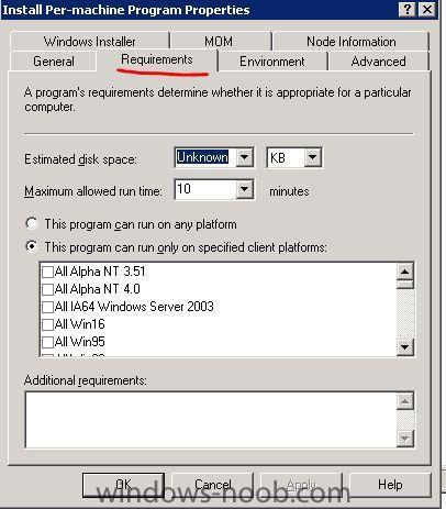

Computers are XP SP3. I have selected the correct platform and choose 20M. I have attached the log from one of the computers.

select that the program can be installed on any platform and erase you values regarding the file size to see if there is any diffrence.
