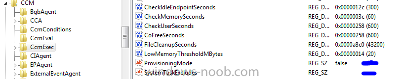

The client could be stuck in provisioning mode... (check regsitry), thus nothing else will work after i:e software updates, packages etc...
Provisioningmode should be false and systemtaskexcludes should be blank also as seen in screenshot.
