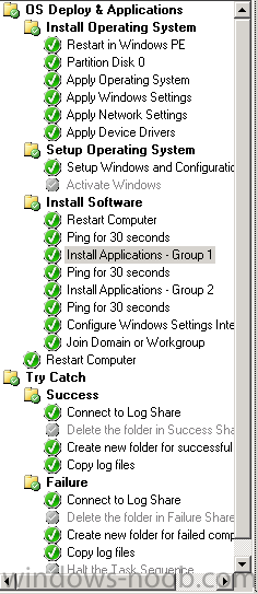

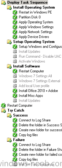

afrancis Posted August 14, 2013 Report post Posted August 14, 2013 I have been working heavily on our implementation of SCCM in our corporate environment. We ran into a problem where I had to rebuild and fix the PXE option and it brought me to this site. I have been working on a Task Sequence for the past week or so. We originally had an outside company build the base server and set it up for us so all we had to do was maintenance, add new drivers, etc. Anyway, I am coming up with a new task sequence (tried to copy the one that works and apply it to a different collection), but the applications from the copied Task Sequence or the new one I created never installs applications. It's baffling to me. Here are one of the codes it provides. I am implementing a log capture when a job is successful or if it fails. You will notice that in one of those failed log files. Policy Evaluation failed, hr=0x87d00267 InstallApplication 8/13/2013 11:59:02 AM 2260 (0x08D4)Install application action failed: 'Symantec Endpoint Protection'. Error Code 0x87d00267 InstallApplication 8/13/2013 11:59:02 AM 2260 (0x08D4) I will add in a zip file with more logs from the SMSTS folder on the client machine. Any help of what to look for would be greatly appreciated. Quote Share this post Link to post Share on other sites More sharing options...
