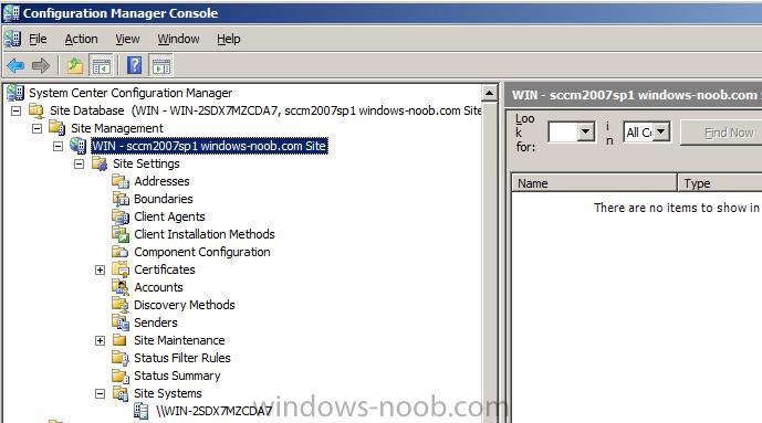

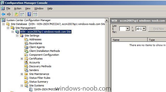

Startup the SCCM Configmgr console and click on the + beside Site Management to expand that section.
Underneath that you'll have your SCCM Site Server name (in my case WIN), and underneath that we have the Sites settings.

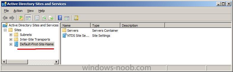

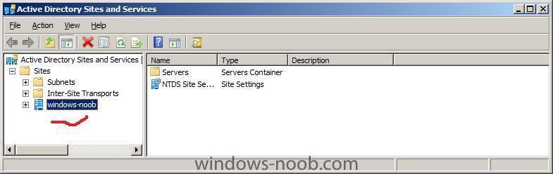

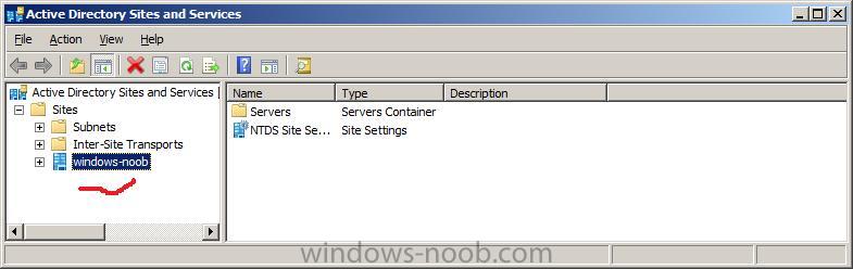

You'll need to know your AD site name. The AD site name is by default called Default-First-Site-Name and you can change that in Active Directory sites and services just as long as the site name is the SAME in both AD and SCCM site boundries
Before change:-
below we have renamed the Default-First-Site-Name to windows-noob in Active directory sites and services

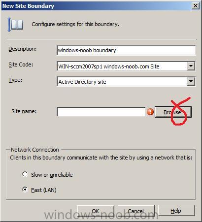

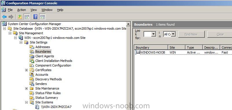

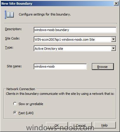

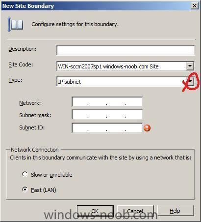

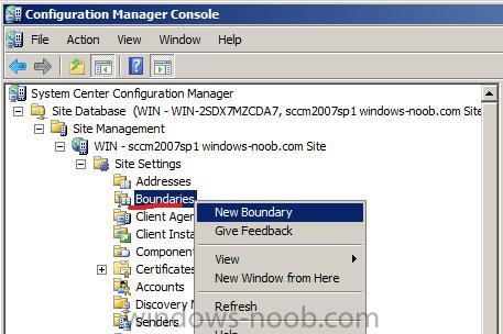

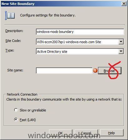

Open SCCM Configmgr and expand Site settings, click on the Boundaries node, right click the node and select New Boundary from the context menu.
Click on Type and change it to Active Directory Site

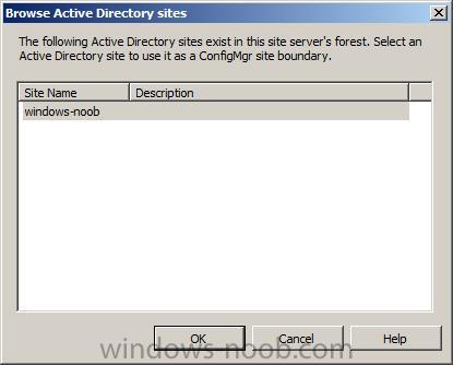

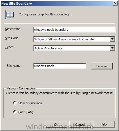

click on Browse and select the AD site name we configured earlier in AD sites and services.
click on ok to complete

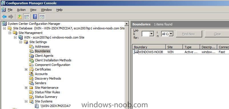

click ok again and we can now see our SCCM Site boundary is setup in ConfigMgr.

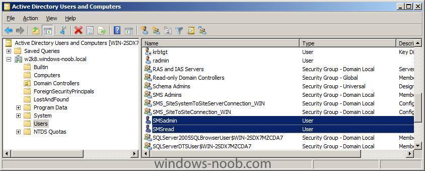

Open Active Directory Users and Computers and create two new Domain Users
SMSadmin and SMSread.
The SMSAdmin account should have Full Administrative priveledges on the SCCM server. To do this you can add the SMSadmin account to the Local Administrators Group on the SCCM Server.

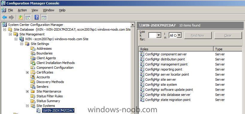

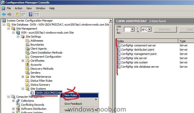

Go back to SCCM ConfigMgr, expand Site Settings and Site Systems, and click on your Server name. You should see that several Roles are already installed (Component Server, distribution point, management point, site server, site system, site database server).

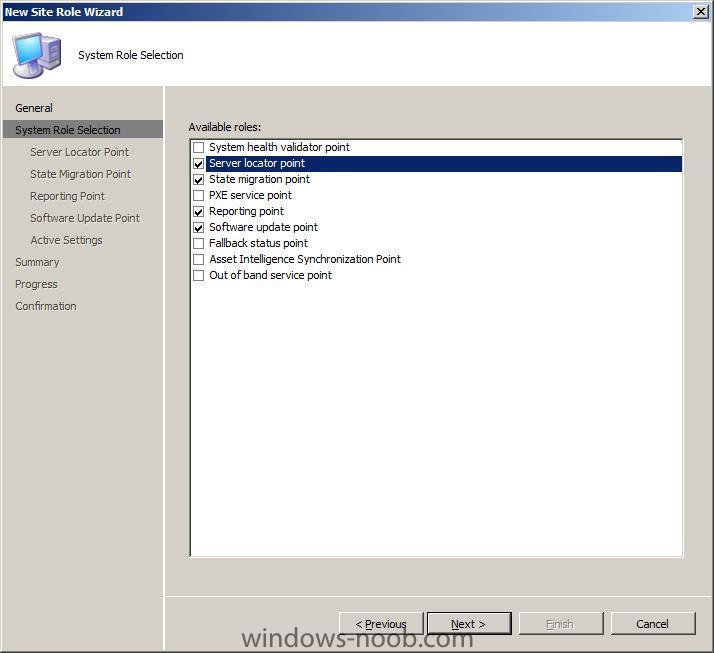

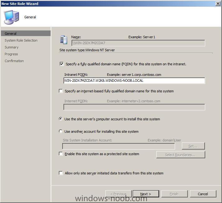

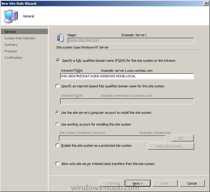

Right click your server name and choose New Roles. This will bring up the New Site Role Wizard.
Accept the defaults and click next.

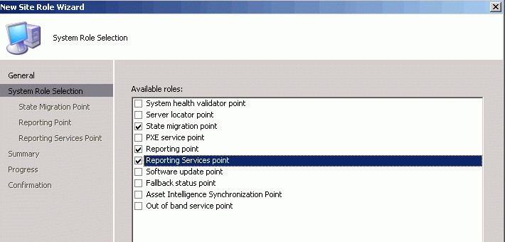

Select Server Locator point, State Migration point, Reporting point and Software update point from the list.

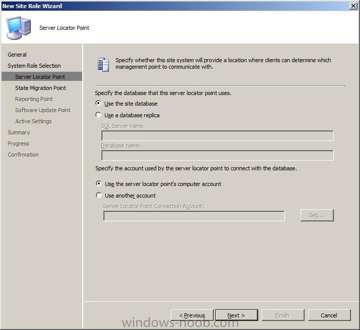

Note: If you are not using the Configuration Manager AD schema *ie, if you have not extended the AD schema for SCCM as outlined here* , then you do need an SLP.For Server Locator point, however, if you plan on doing Build and Capture, then read below.
Select the Server Locator Point even though the AD schema has been extended for SCCM. This is because when doing Build and Capture of an Operating System, best practise means the computer is not domain joined, therefore it cannot get the information it needs (to install windows updates) from AD, it therfore retrieves the information from the SLP. Read this post for more info.

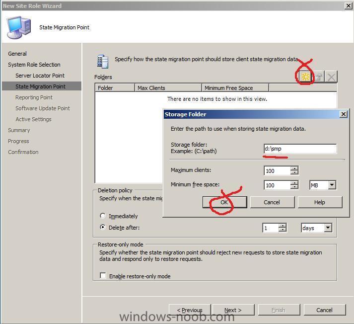

For State Migration point, click on the red exclamation mark to input a path to store the SMP data for example d:\smp this is where data will be stored during the OSD process if it has to be stored on the network.

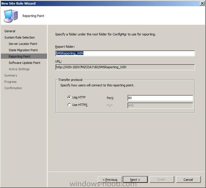

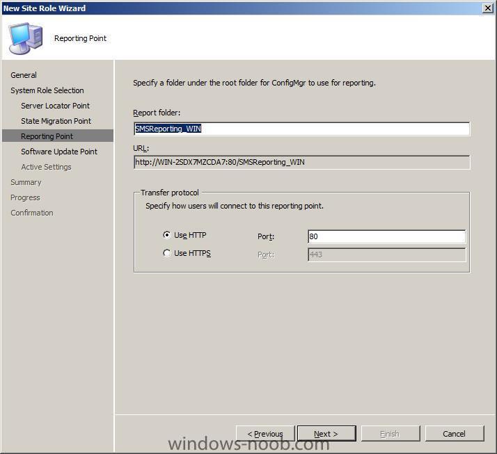

Next up is the reporting point, leave it as it is

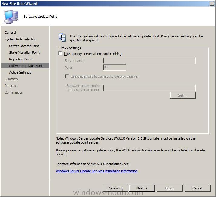

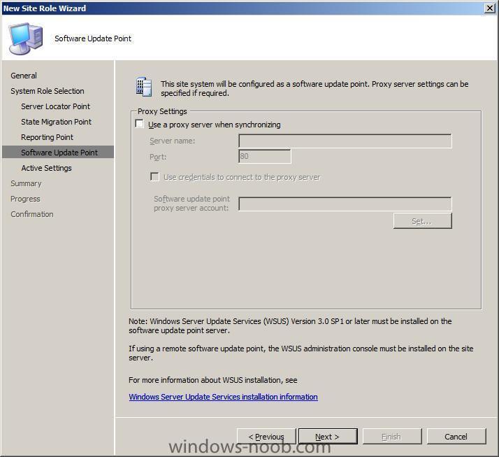

Then we will have the Software Update point, WSUS 3.0 sp1 or later must be installed to use this feature, but if you've followed my guide from start to finish you'll already have it (WSUS 3.1) installed.

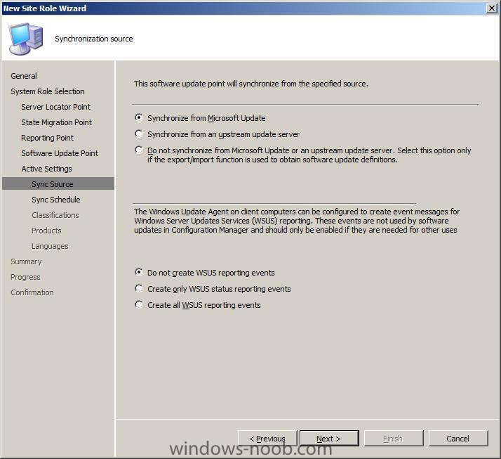

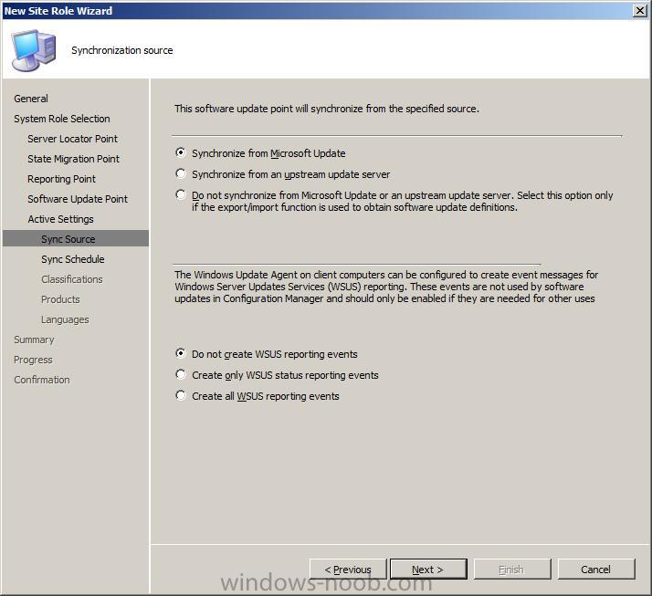

Put a checkmark in Use this server as the active software update point, and click next, then leave the Sync source settings as they are.

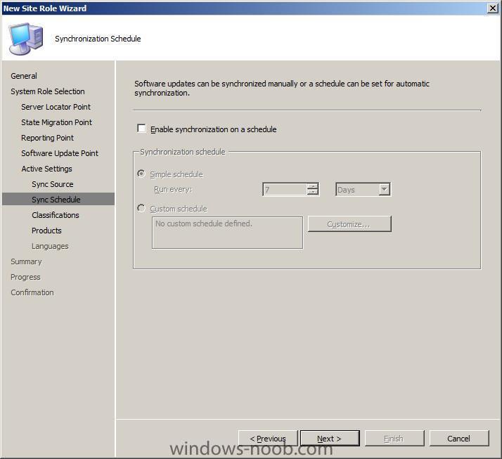

Accept the Sync Schedule defaults

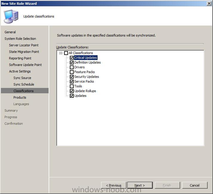

click next to see the classifications, choose the following Critical Updates, Definition Updates, Security Updates, Service Packs, Update Rollups, and Updates, then click the next button.

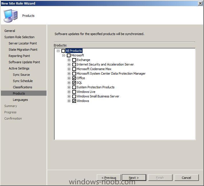

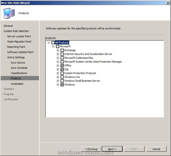

For Products to update, choose Office, SQL and Windows (Windows and Office will already be selected)

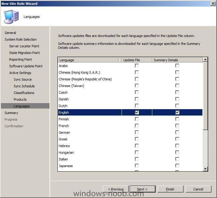

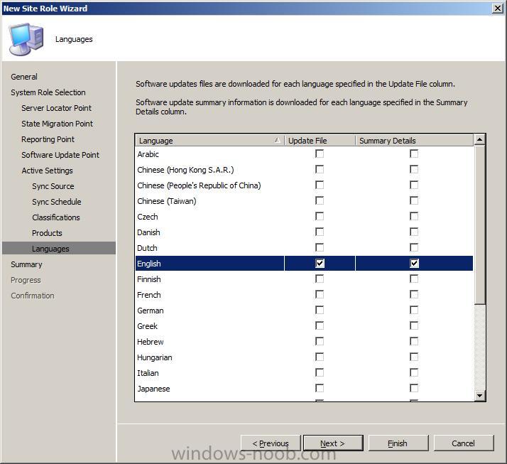

Set your language preferences, mine had Chinese, Korean, French and German pre-selected (odd...) I changed it to only English

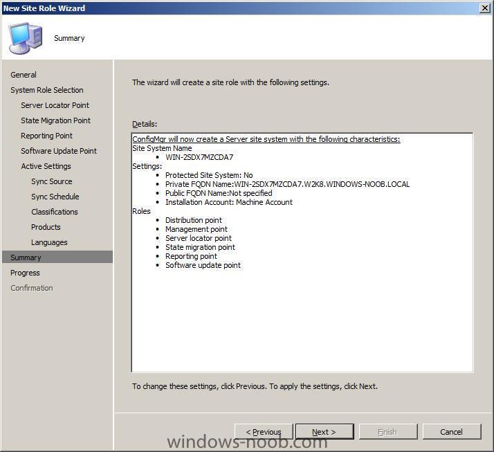

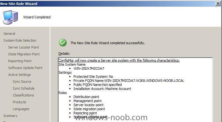

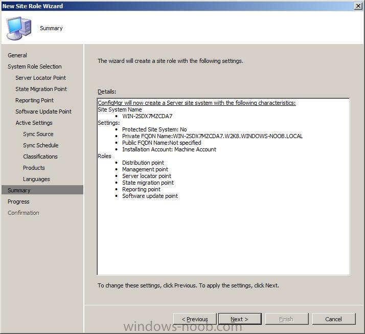

finally you can review the summary.... click Finish
once done click close.

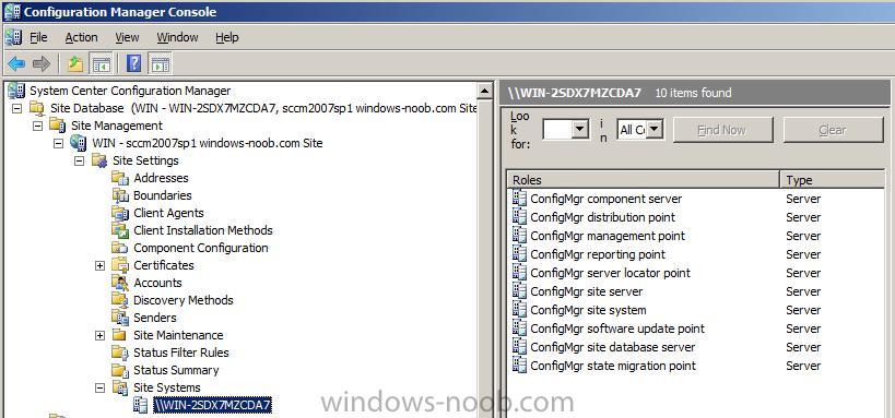

We can now see our roles in ConfigMgr.
