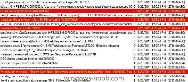

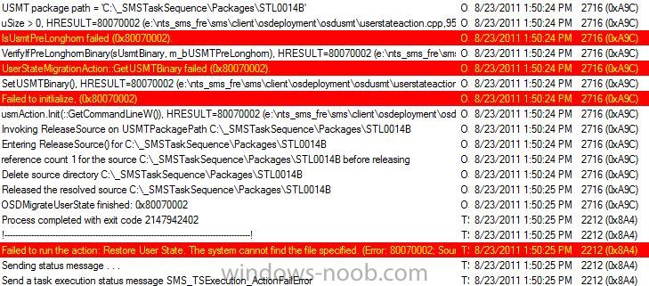

  3. Right now I am using a different method which seemed to work without errors on the screen, however data was still not restored. http://sccm.haas.se/?p=272 Error is IsUSMTPreLonghorn failed (0x80070002) UserStateMigrationAction: GetUSMTBinaryFailed (0x80070003) Failed to initialize Failed to run the action Restore User State. The system cannot find the file specified. Right now I am trying the capture with the USMT package point to the USMT root and then with the restore USMT package pointed directly to x86 to see if it is having issues deciphering what to execute. I can see all the USMT files (x86 and x64) being downloaded right before trying to execute the restore function, so I am wondering if it is looking in the USMT root and not seeing the file it needs. I cannot find a loadstate log on the PC when going into F8. I can only see the smts logs.
