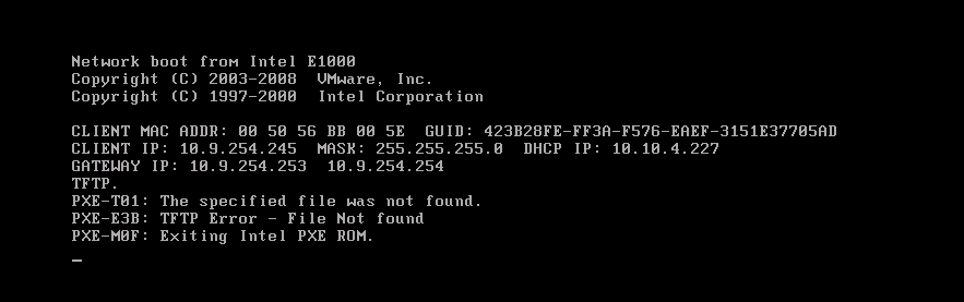

currently im getting the following error: PXE-T01: The specified file was not found PXE-E3b: TFTP Error- File Not found PXE-M0F: Exiting Intel PXE ROM. I think may have the wrong file specified by DHCP. currently I'm telling it to give out "pxeboot.com". Our DHCP server is running solaris. So I need to provide the tftp path to this bootfile which I dont know how to find. A UNC path will not work. Any suggestions?
I uninstalled WDS, removed the PXE boot check box. Restarted my server. Installed WDS (didnt configure it), enabled PXE boot in the DP. Went through SCCM guides 6 ,7 and 8 again. When I boot my test VM client I get the following error. My clients are on separate vlan then my SCCM server, so I have IP Helper enabled and dhcp handing out the boot file. I think at this point this is my problem. What boot file should I be telling DHCP to hand out to my clients?

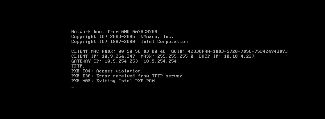

Hi, I need to setup PXE boot on my vlan for SCCM 2012. We have setup the IP Helper to point to the IP address of the SCCM Site/DP. Where is the file located which I will need for DHCP to give out to the clients to boot from? I'm new to PXE booting in general so I'm a little confused about all this. Here is the location of the file that I'm currently having it boot to \\SCCM\SMS_STK\osd\boot\x64\boot.wim Acutally the other admin did say that when he sets it up he wont be needing the unc path, just the filename of the boot file. I've gone through and enabled PXE boot in SCCM. Currently when my machine tries to boot it gets the following error. PXE-T04: Access Violation PXE-E36: Error received from TFTP server PXE-M0F: Exiting PXE ROM

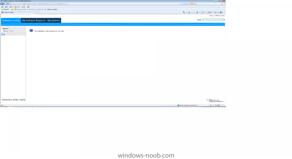

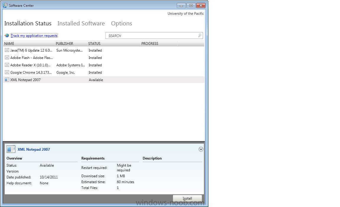

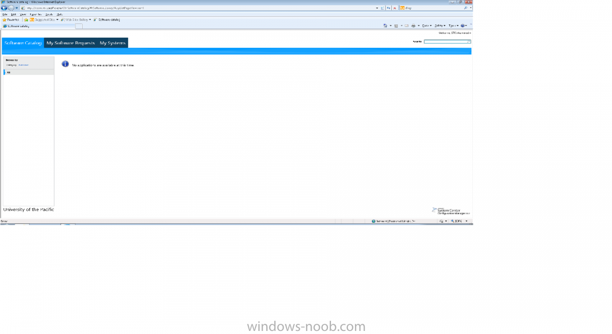

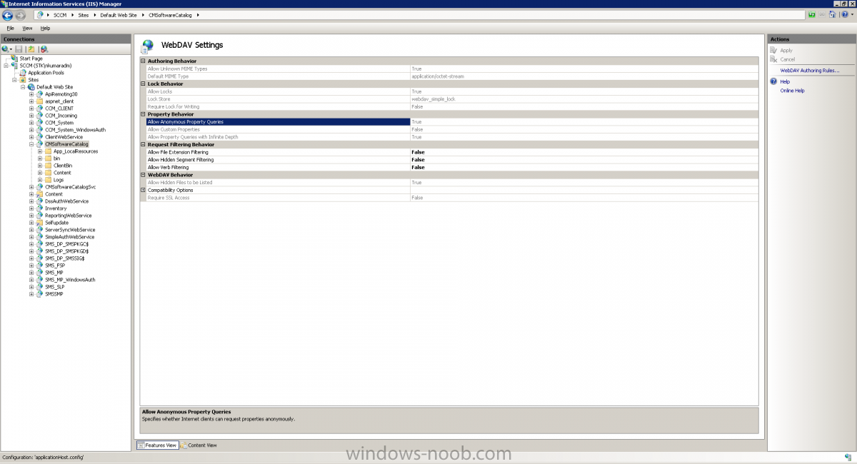

Software Catalog not updating
nk5316 replied to nk5316's question in Deploy software, applications and drivers
OK thanks for the reply, I figured it out. I seem to figure it out right after posting on here lol. Everything is configured properly, when I deployed the application I was pushing it to the device collection instead of a User collection. So thats why it should up in the software center but not on the Software Catalog. I knew it had to do something with my login on that site. thanks again. -

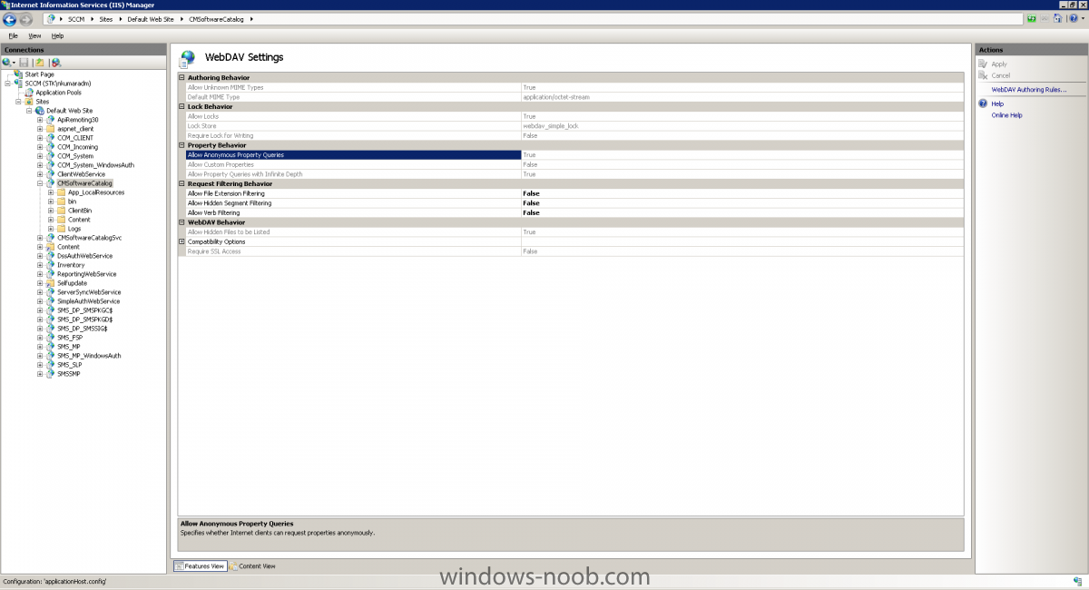

Hi, I'm running SCCM 2012 beta 2 on Windows 2008 R2. I am able to deploy applications and windows updates without a problem. However for some reason my Software Catalog is empty and says: No Applications are available at this time. It asks me to login when I go to the website and once I do I don't see any applications to install. Wierd thing is that under the Software Center I'll see an avialable applicaton ready to install. I'm wondering what I'm doing wrong. I have webdav configured and I'm attaching some screen shots for your review. Thank you for your assistance with this. -Nik

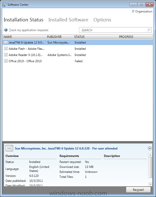

Hi, I pushed out a office 2010 deployment from sccm 2012. I did create a customized msp file and the client was able to start the installation but it never finished and ended up failing. BUT, I see that it actually did install Office 2010 on all my 3 client test machines. I'm not sure why it says that it failed. Can you advised me what to check and see why it says failed?
