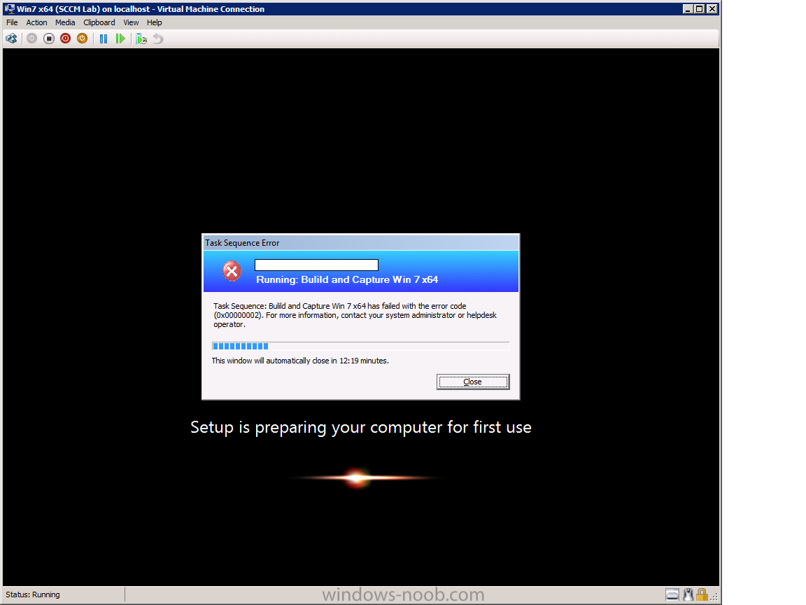

<![LOG[Failed to set log directory. Some execution history may be lost. The system cannot find the file specified. (Error: 80070002; Source: Windows)]LOG]!><time="14:18:09.390+300" date="03-02-2012" component="OSDSetupHook" context="" type="3" thread="832" file="osdsetuphook.cpp:192"> <![LOG[Executing task sequence]LOG]!><time="14:18:09.531+300" date="03-02-2012" component="OSDSetupHook" context="" type="1" thread="832" file="osdsetuphook.cpp:277"> <![LOG[Task Sequence environment not found. Task sequence completed in Windows PE.]LOG]!><time="14:18:09.531+300" date="03-02-2012" component="OSDSetupHook" context="" type="1" thread="832" file="basesetuphook.cpp:1291"> <![LOG[uninstalling Setup Hook]LOG]!><time="14:18:09.531+300" date="03-02-2012" component="OSDSetupHook" context="" type="1" thread="832" file="basesetuphook.cpp:1427"> <![LOG[Removing setup hook from registry.]LOG]!><time="14:18:09.531+300" date="03-02-2012" component="OSDSetupHook" context="" type="0" thread="832" file="vistasetuphook.cpp:143"> <![LOG[successfully removed C:\Windows\system32\OSDGINA.DLL]LOG]!><time="14:18:09.531+300" date="03-02-2012" component="OSDSetupHook" context="" type="1" thread="832" file="basesetuphook.cpp:1183"> <![LOG[successfully removed C:\Windows\system32\OSDSETUPHOOK.EXE]LOG]!><time="14:18:09.546+300" date="03-02-2012" component="OSDSetupHook" context="" type="1" thread="832" file="basesetuphook.cpp:1183"> <![LOG[successfully removed C:\Windows\system32\_SMSOSDSetup]LOG]!><time="14:18:09.562+300" date="03-02-2012" component="OSDSetupHook" context="" type="1" thread="832" file="basesetuphook.cpp:1220"> <![LOG[successfully finalized logs to SMS client log directory from C:\Windows\CCM\Logs]LOG]!><time="14:18:09.578+300" date="03-02-2012" component="OSDSetupHook" context="" type="1" thread="832" file="tslogging.cpp:1542"> This is the smsts.log on the win7 machine. EDIT: So i went through all the settings once more and (as usual) i made a mistake. In Step 6. Create the Build and Capture Task Sequence, i pasted in the line SMSMP=sccm.server2008r2.lab.local without updating it to my domain! <facepalm> Looks like the capture is working this time around.
Hello and thank you for your tutorials. I'm getting stuck on the Task Sequence after PXE booting. I enter my password and get the 80004005 error. Here's what I'm doing: I'm using Hyper-V 2008R2, created a virtual machine and i'm able to network boot. I'm unable to interrupt the bootup with F8. Once the PE is initialized, it asks for my password. After typing it in, it fails. I can't see anything in the SMSPXE.log logs about that issue. Kinda stumped here. I've been reading this forum post's replies and trying what i can, but no luck so far. This looks like a permissions issue? EDIT: I enabled Command support on the x64 package and was able to get to the smsts.log. Turns out I'm having the same issue as lishi. The virtual machine is getting DHCP from my router and not the DC. I'm going to have to figure out how to have it poll the DHCP from my DC. EDIT 2: So yes, my VM is getting my router's DHCP settings. I edited the hosts file in the PE environment (notepad x:\windows\system32\drivers\etc\hosts) and punched in the hostname of my SCCM server. Does anyone have any suggestions on how to run this in a lab so that I'm picking up the right DHCP/DNS server? The Hyper-V server is on a standard home internet connection.
