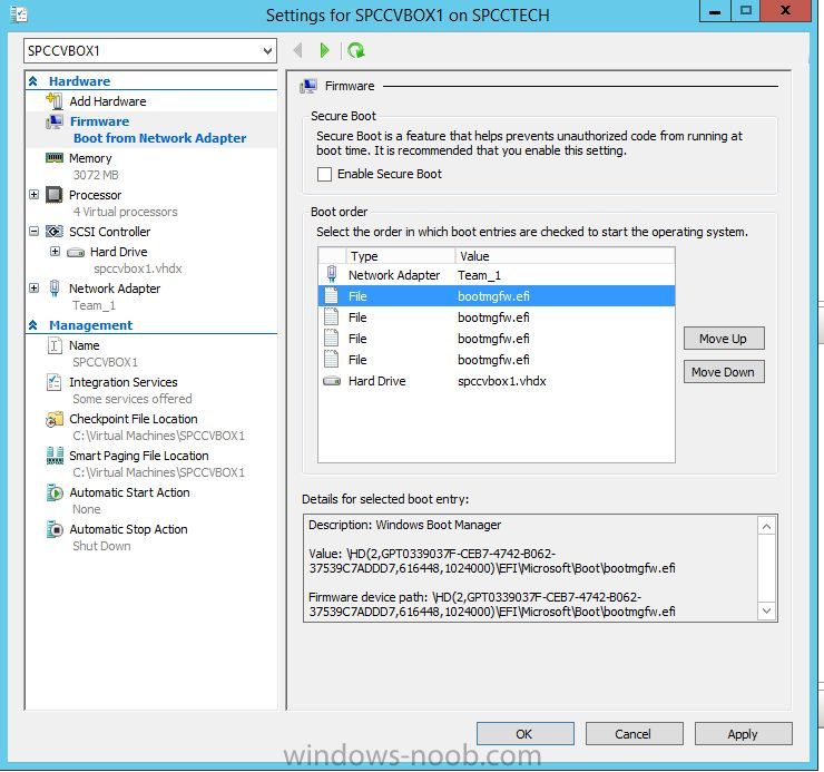

Hi, I've just gone to 2012 R2, and wanted to try UEFI Gen 2 VM's for build and capture task sequences. I've run into a strange issue, where every time I reimage the VM, another "File - bootmgfw.efi" entry gets added to the Firmware boot order list in the VM machine settings. Is there a way to prevent this or delete these entries? I also want it to boot from PXE, but it seems like this "File" entry gets added in to be the first boot order device after a B&C has been run. Any ideas?

I've had similar problems. Enable F8 prompt and use diskpart and create a partition before it starts deployment - I have had issued with partitions if a TS gets aborted. If it's a VM, disable the whole Apply Drivers step. Don't apply any drivers at all.

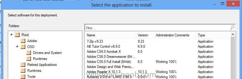

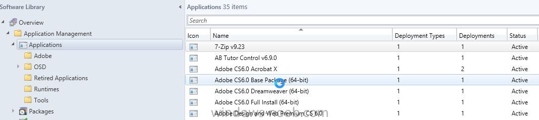

My apologies, Thats what was puzzling, I did have the "Allow this application to be installed from the Install Application task sequence action without being deployed." checked. However in "Deployment Types" under "User experience" I had Install for System with a logon requirement of Only when a user is logged on. This needs to be changed to Whether or not a user is logged on. This had the side-effect of making it not appear at all when selecting a program for a task sequence.
Hi All, I have a bit of a problem in that I have some Applications that work fine, they deploy where they are meant to and everything is good. However - I cannot select them in "Install Application" in a Task Sequence. Pic 1.jpg shows it in "Application Management" - in this case "Adobe CS6.0 Base Package (64-bit)" *there are other missing programs too Pic 2.jpg show's me trying to select it in a TS "Install Application" - it just doesn't exist! For some time I have been a little bit suspect of our DB........is there anything I can do for a full check? Is anyone able to explain why this could be happening? Regards Greg

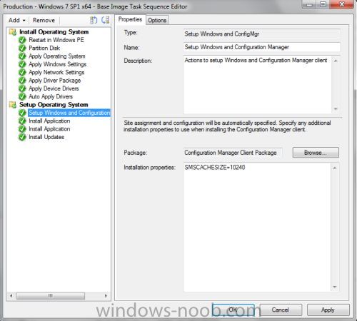

Hi, This is my first post so please excuse me if I miss something... I have no background in SCCM 2007 or earlier....we're running a new installation of SCCM 2012 at our school. I have a TS for installing Win 7 x64. I have used collection variables (CORE01, etc) to install multiple applications during OSD. This works fine until by itself. I also have an Adobe CS6 package that's around 4.5gb. This installs fine if I do not install the previous CORE packages, but fails if I try to run both in sequence. I believe it is because I am hitting the default cache limit of 5120mb. To solve this I have tried adding SMSCACHESIZE=10240 to the installation properties for the "Setup Windows and Configuration Manager" step. Below is a sample of the SMSTS.log that shows the application install failed due to not downloading. CAppMgmtSDK::GetEvaluationState ScopeId_09B7AFD0-F464-46D2-8268-5876F2DE0739/RequiredApplication_6243db6e-d2d4-4647-96a1-8b48a264ed0d DCMAgent 17/07/2012 12:33:16 PM 3192 (0x0C78) Passed in version 2 for ScopeId_09B7AFD0-F464-46D2-8268-5876F2DE0739/RequiredApplication_6243db6e-d2d4-4647-96a1-8b48a264ed0d DCMAgent 17/07/2012 12:33:16 PM 3192 (0x0C78) CAppMgmtSDK::GetEvaluationState ScopeId_09B7AFD0-F464-46D2-8268-5876F2DE0739/RequiredApplication_6243db6e-d2d4-4647-96a1-8b48a264ed0d.2 = AvailableForEnforcement DCMAgent 17/07/2012 12:33:16 PM 3192 (0x0C78) GetAppMgmtSDKInterface successful InstallApplication 17/07/2012 12:33:17 PM 3192 (0x0C78) CAppMgmtSDK::GetEvaluationState ScopeId_09B7AFD0-F464-46D2-8268-5876F2DE0739/RequiredApplication_6243db6e-d2d4-4647-96a1-8b48a264ed0d DCMAgent 17/07/2012 12:33:17 PM 3192 (0x0C78) Passed in version 2 for ScopeId_09B7AFD0-F464-46D2-8268-5876F2DE0739/RequiredApplication_6243db6e-d2d4-4647-96a1-8b48a264ed0d DCMAgent 17/07/2012 12:33:17 PM 3192 (0x0C78) CAppMgmtSDK::GetEvaluationState ScopeId_09B7AFD0-F464-46D2-8268-5876F2DE0739/RequiredApplication_6243db6e-d2d4-4647-96a1-8b48a264ed0d.2 = DownloadFailed DCMAgent 17/07/2012 12:33:17 PM 3192 (0x0C78) NotifyProgress received: 24 (Application download failed ) InstallApplication 17/07/2012 12:33:17 PM 3192 (0x0C78) GetAppMgmtSDKInterface successful InstallApplication 17/07/2012 12:33:17 PM 3192 (0x0C78) CAppMgmtSDK::GetEvaluationState ScopeId_09B7AFD0-F464-46D2-8268-5876F2DE0739/RequiredApplication_6243db6e-d2d4-4647-96a1-8b48a264ed0d DCMAgent 17/07/2012 12:33:17 PM 3192 (0x0C78) Passed in version 2 for ScopeId_09B7AFD0-F464-46D2-8268-5876F2DE0739/RequiredApplication_6243db6e-d2d4-4647-96a1-8b48a264ed0d DCMAgent 17/07/2012 12:33:17 PM 3192 (0x0C78) CAppMgmtSDK::GetEvaluationState ScopeId_09B7AFD0-F464-46D2-8268-5876F2DE0739/RequiredApplication_6243db6e-d2d4-4647-96a1-8b48a264ed0d.2 = DownloadFailed DCMAgent 17/07/2012 12:33:17 PM 3192 (0x0C78) GetAppMgmtSDKInterface successful InstallApplication 17/07/2012 12:33:17 PM 3192 (0x0C78) CAppMgmtSDK::GetEvaluationState ScopeId_09B7AFD0-F464-46D2-8268-5876F2DE0739/RequiredApplication_6243db6e-d2d4-4647-96a1-8b48a264ed0d DCMAgent 17/07/2012 12:33:17 PM 3192 (0x0C78) Passed in version 2 for ScopeId_09B7AFD0-F464-46D2-8268-5876F2DE0739/RequiredApplication_6243db6e-d2d4-4647-96a1-8b48a264ed0d DCMAgent 17/07/2012 12:33:17 PM 3192 (0x0C78) CAppMgmtSDK::GetEvaluationState ScopeId_09B7AFD0-F464-46D2-8268-5876F2DE0739/RequiredApplication_6243db6e-d2d4-4647-96a1-8b48a264ed0d.2 = DownloadFailed DCMAgent 17/07/2012 12:33:17 PM 3192 (0x0C78) GetAppMgmtSDKInterface successful InstallApplication 17/07/2012 12:33:17 PM 3192 (0x0C78) CAppMgmtSDK::GetEvaluationState ScopeId_09B7AFD0-F464-46D2-8268-5876F2DE0739/RequiredApplication_6243db6e-d2d4-4647-96a1-8b48a264ed0d DCMAgent 17/07/2012 12:33:17 PM 3192 (0x0C78) Passed in version 2 for ScopeId_09B7AFD0-F464-46D2-8268-5876F2DE0739/RequiredApplication_6243db6e-d2d4-4647-96a1-8b48a264ed0d DCMAgent 17/07/2012 12:33:17 PM 3192 (0x0C78) CAppMgmtSDK::GetEvaluationState ScopeId_09B7AFD0-F464-46D2-8268-5876F2DE0739/RequiredApplication_6243db6e-d2d4-4647-96a1-8b48a264ed0d.2 = DownloadFailed DCMAgent 17/07/2012 12:33:17 PM 3192 (0x0C78) NotifyComplete received InstallApplication 17/07/2012 12:33:17 PM 3192 (0x0C78) NotifyComplete processed InstallApplication 17/07/2012 12:33:17 PM 3192 (0x0C78) Received job completion notification from DCM Agent InstallApplication 17/07/2012 12:33:17 PM 2464 (0x09A0) GetAppMgmtSDKInterface successful InstallApplication 17/07/2012 12:33:17 PM 2464 (0x09A0) CAppMgmtSDK::GetEvaluationState ScopeId_09B7AFD0-F464-46D2-8268-5876F2DE0739/RequiredApplication_6243db6e-d2d4-4647-96a1-8b48a264ed0d DCMAgent 17/07/2012 12:33:17 PM 2464 (0x09A0) Passed in version 2 for ScopeId_09B7AFD0-F464-46D2-8268-5876F2DE0739/RequiredApplication_6243db6e-d2d4-4647-96a1-8b48a264ed0d DCMAgent 17/07/2012 12:33:17 PM 2464 (0x09A0) CAppMgmtSDK::GetEvaluationState ScopeId_09B7AFD0-F464-46D2-8268-5876F2DE0739/RequiredApplication_6243db6e-d2d4-4647-96a1-8b48a264ed0d.2 = DownloadFailed DCMAgent 17/07/2012 12:33:17 PM 2464 (0x09A0) Installation job completed with exit code 0x00000000 InstallApplication 17/07/2012 12:33:17 PM 2464 (0x09A0) Execution status received: 24 (Application download failed ) InstallApplication 17/07/2012 12:33:17 PM 2464 (0x09A0) Installation failed. InstallApplication 17/07/2012 12:33:17 PM 2464 (0x09A0) Setting TSEnv variable 'SMSTSInstallApplicationJobID__ScopeId_09B7AFD0-F464-46D2-8268-5876F2DE0739/Application_6243db6e-d2d4-4647-96a1-8b48a264ed0d'='' InstallApplication 17/07/2012 12:33:17 PM 2464 (0x09A0) Completed installation job. InstallApplication 17/07/2012 12:33:17 PM 2464 (0x09A0) Step 2 out of 2 complete InstallApplication 17/07/2012 12:33:17 PM 2464 (0x09A0) Install application action failed: 'Adobe Design and Web Premium CS 6.0'. Error Code 0x80004005 InstallApplication 17/07/2012 12:33:17 PM 2464 (0x09A0) Am I correct is the cause of this? It does seem to be space related because both install fine just by themselves. How can I set the SMSCACHESIZE @ installation? Cheers for you help! Greg
