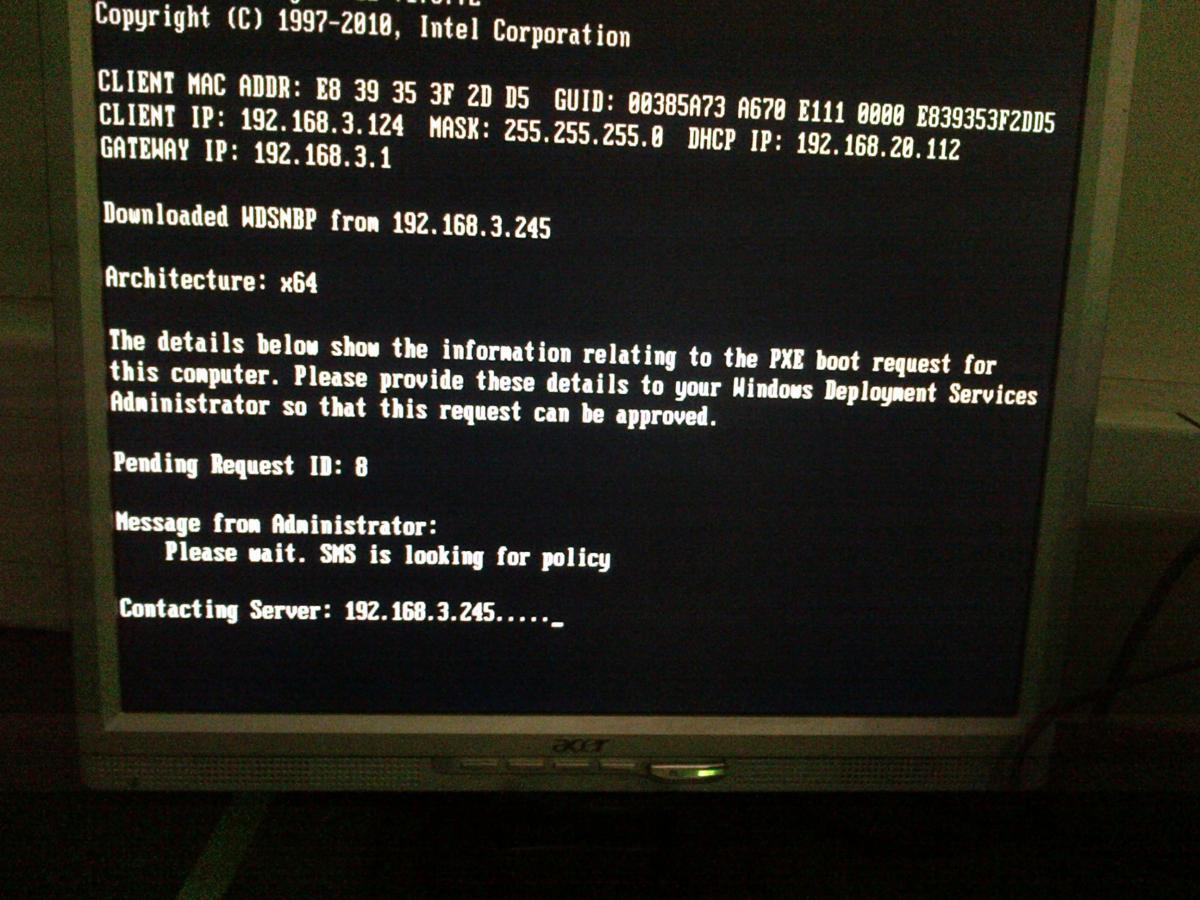

  7. Hi Folks, I'm not have a good time with SCCM, so i'm hoping some of you good folk are able to help me out. SCCM was working fine then one of our technicians said to me SCCM is not working and he never done anything, when you go to image a pc you f12 it but we are getting this message, has anyone seen this before and can help me solve the issue? many thanks Owen.

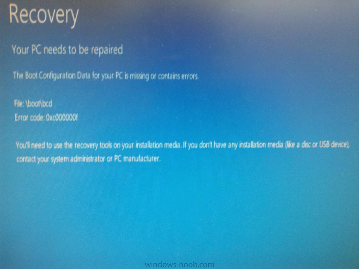

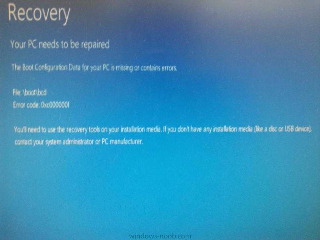

  11. Hi Folks, I just recently upgraded my sccm 2012 sp1 environment to 2012 R2, I have only just tried deploying our custom image to a pc since the upgrade to discover its not working but it was before the upgrade. The pc pxe boots as normal runs through the task process everything looks fine looks its downloaded the image ok, but then it displays a black screen saying "An Operating System Wasn't Found, Press Ctrl Alt Delete to restart. can anyone help me out? thanks in advance Owen

  19. Hi folks, I'm having a bit of a problem with pxe booting, it had been working fine as far as I was aware, then I was informed its now not working. if I pxe boot from a client the client gets an ip address as normal, on the screen it displays the following: downloaded WDSNBP from "Server ip address" WDSNBP started using DHCP Referral. Contacting Server: "Server IP Address" (Gateway: "IP Address") No response from Windows Deployment Services Server. Launching pxeboot.com Press F12 for network service boot. if I push F12 I get an error message, that I can upload if it would help just let me know. I have uninstalled/reinstalled pxe/wds numerous times but I still get the same thing, has anyone come across this problem before that can help me out? many thanks Owen.
