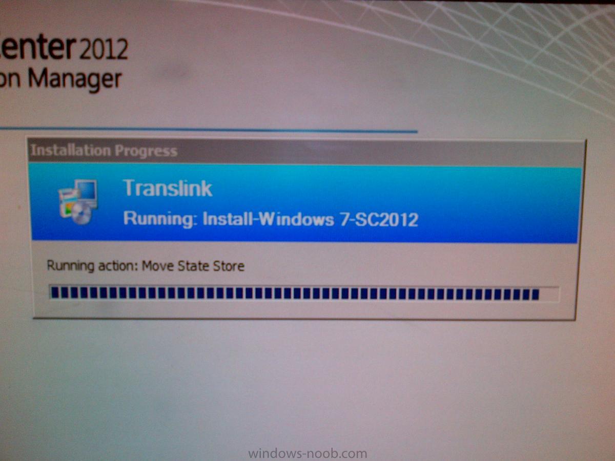

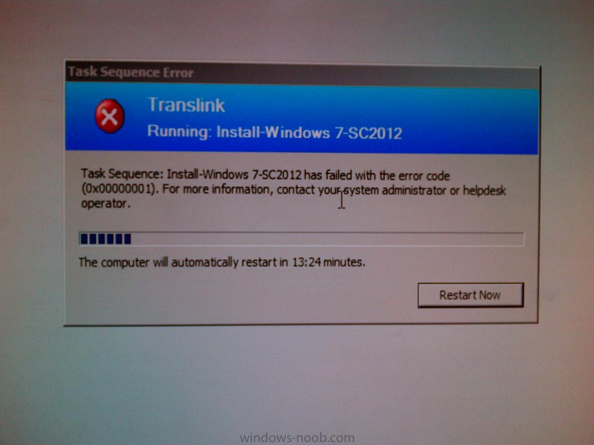

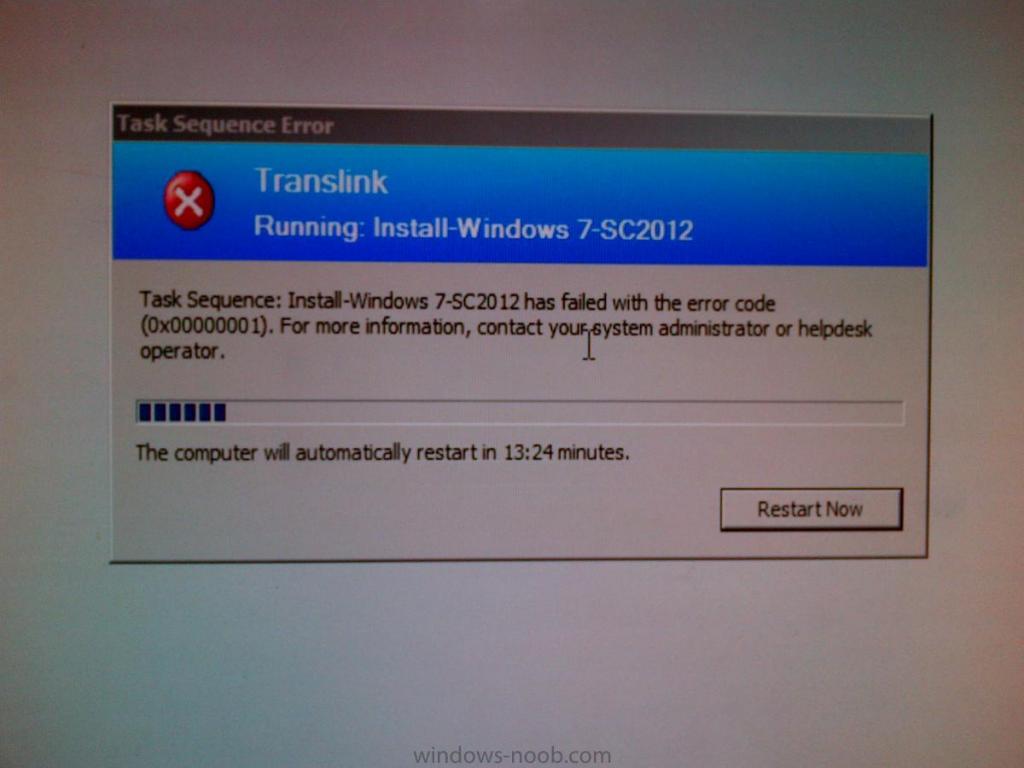

  2. Thanks folks for your replies. I've got pxe working i had to uninstall pxe and manually delete the RemoteInstall folder, after i done that i re-enabled pxe which installed wds and i can now pxe boot. Now my next problem that has arisen, i migrated my task sequence from my old sccm 2007 server to my new sccm 2012 server, so on a pc i want to image with our custom os, it pxe boots no problem i get the task sequence menu i select the task i want to run, it kicks off but a few minutes into it i get an error message, see attached (SCCM Error), if i move the error message out of the way i can see another message box, again see attached (SCCM MGS). i don't know what i've done wrong or need to do in the task sequence, so any advice would be great. thanks (the version of sccm 2012 i'm running is - 5.0.7711.0) Owen.
