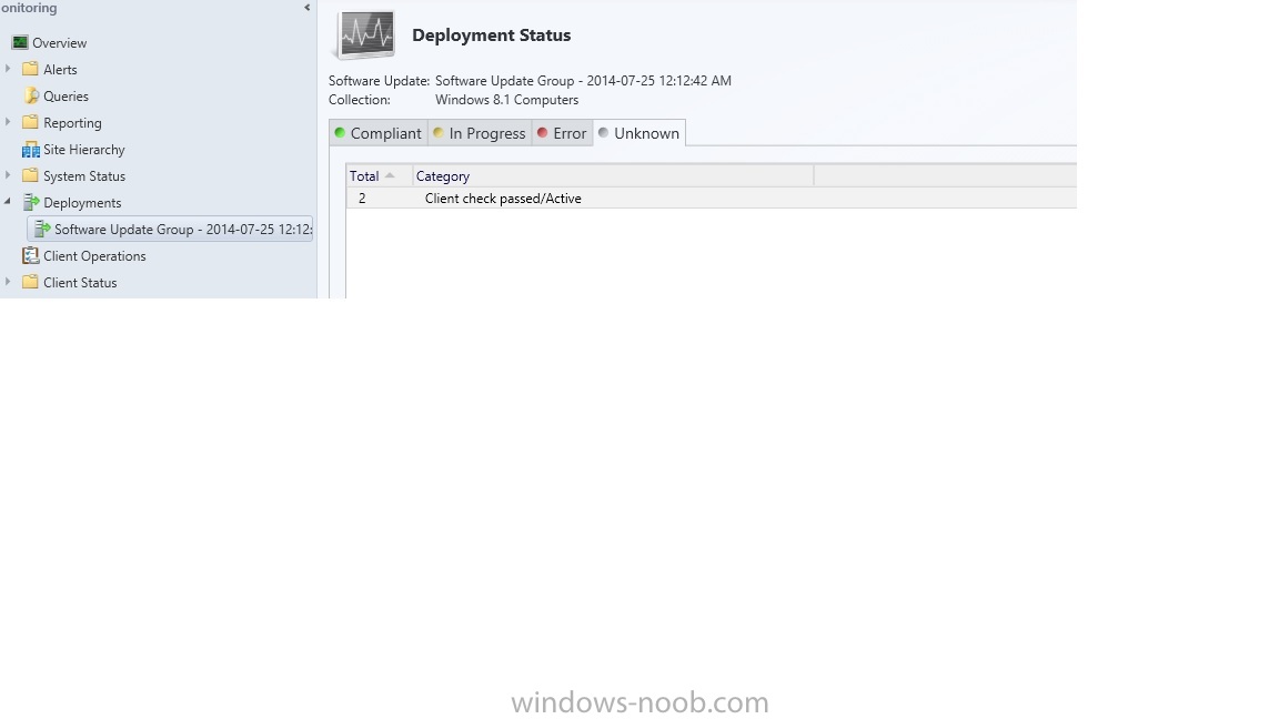

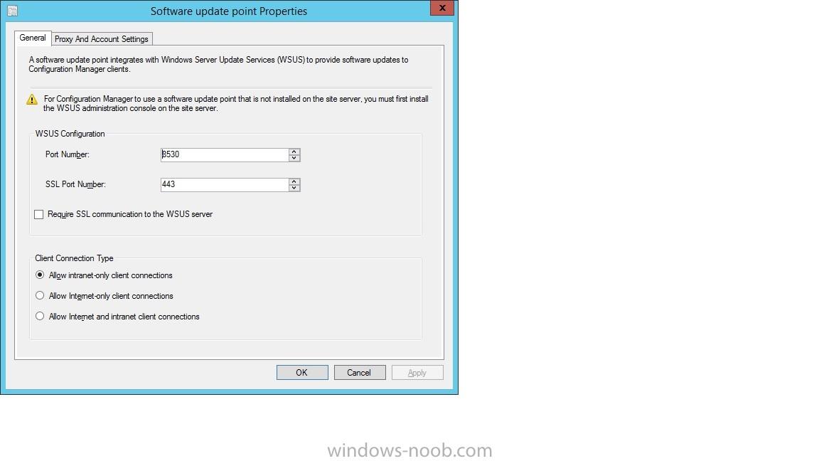

  8. Hello Thanks for reading my post I have set up my own test lab for SCCM R2 and Windows 2012 R2 to learn how to suppprt and to install both - so far I have got everything working - Bar two things (I am posting both issues in separete posts). To make life simple I have broen this down into sections to help give people the right infomaction to help me 1. A bit of info about my setup My test lab has is called thomasnetwork.local 1. Windows 2012R2 DC (Core) 1 Windows 2012 R2 - SCCM Server alos has SQL running (SCCMSERVER.thomasnetwork.local) 2 Windows 8.1 and 2 Windows 7 client computers 2. This Issue When I installed my WSUS rule (using port 8530) I also configured a GP to point to tell my clients to use http://sccmserver.local:8530 in the "Specify Intranet Microsoft Update service location" . I have Sysnc and downloaded my updates from Microsoft website and created a deployent called "Microsoft Software Updates - 2014-07-25 12:12:42 A" and deployed this to my Windows 8.1 computers. Nothing happened. . . . :-( so I looked at my log files and in the WUAHandler.log I found this Group policy settings were overwritten by a higher authority (Domain Controller) to: Server https://sccmserver.local:8530 and Policy ENABLED WUAHandler 26/07/2014 19:27:46 1940 (0x0794) Failed to Add Update Source for WUAgent of type (2) and id ({1983F5C0-9C8D-4C52-A34F-FFC33525F042}). Error = 0x87d00692. WUAHandler 26/07/2014 19:27:46 1940 (0x0794) after a few hours of google the error most of the Microsoft and other posts told me to remove my GP setting and try agin - so I have disabled that GP and one of my windows 8.1 computers started getting updates - but not from the Softwear center but through Microsoft update section in the control panal but when I look at the setting for Microsoft update I cant change anything. My WUAHandler.log now says Unable to read existing WUA resultant policy. Error = 0x80070002. WUAHandler 27/07/2014 10:20:27 3268 (0x0CC4) Group policy settings were overwritten by a higher authority (Domain Controller) to: Server and Policy NOT CONFIGURED WUAHandler 27/07/2014 10:20:27 3268 (0x0CC4) Failed to Add Update Source for WUAgent of type (2) and id ({1983F5C0-9C8D-4C52-A34F-FFC33525F042}). Error = 0x87d00692. WUAHandler 27/07/2014 10:20:27 3268 (0x0CC4) so google now tells me to make a GP for Specify Intranet Microsoft Update service location and point it to my sever with the port after it :-( when I look at my Deployment its still shown 0% and no other info other then "Client check\passed active" I have attched some client log files to help people help me thank you for you time and help :-) CAS.log UpdatesDeployment.log UpdatesHandler.log WUAHandler.log

  11. Hello Thanks for getting back to me, I have reformatted my test server and installed afresh - Same thing happened under Site I get this error " WSUS Configuration Manager failed to configure upstream server settings on WSUS Server "Thomas-SCCM.Thomas-2013.local". Possible cause: WSUS Server version 3.0 SP2 or above is not installed or cannot be contacted. Solution: Verify that the WSUS Server version 3.0 SP2 or greater is installed. Verify that the IIS ports configured in the site are same as those configured on the WSUS IIS website." So it must need WSUS Server ver 3 or above for it to work
  12. Hello Thanks for reading my post. I am setting up a test SCCM system but I am having an issue with WSUS setup I am running a Windows 2012 Server, I am going to Server manager - Add rules and features Wizard - Adding "Windows Server Update Service" adding both WID Database and WSUS Service, the Wizard runs, then in the Server Manager I run post install tasks - but nothing happens - from the documentation a "Windows Server Update Services 3.0 SP2 setup wizard" is supposed to run, I have tried remove and reinstall the Service. I have ran MS update - that did not help - Anyone got any thoughts
