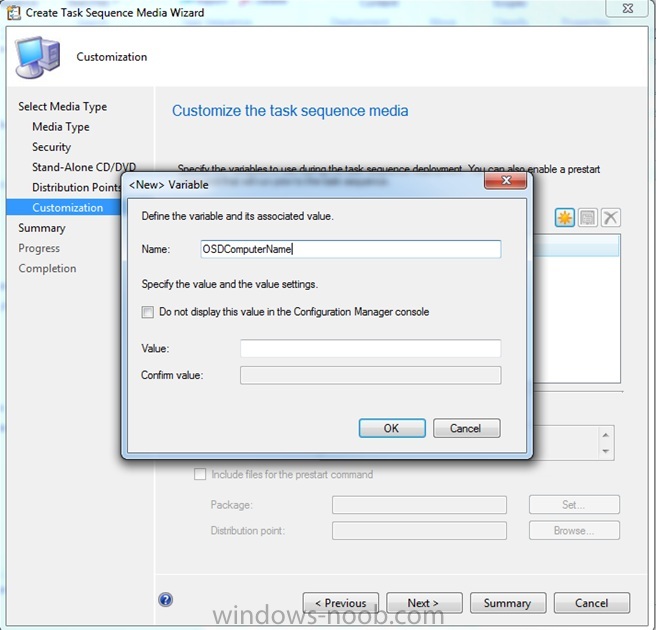

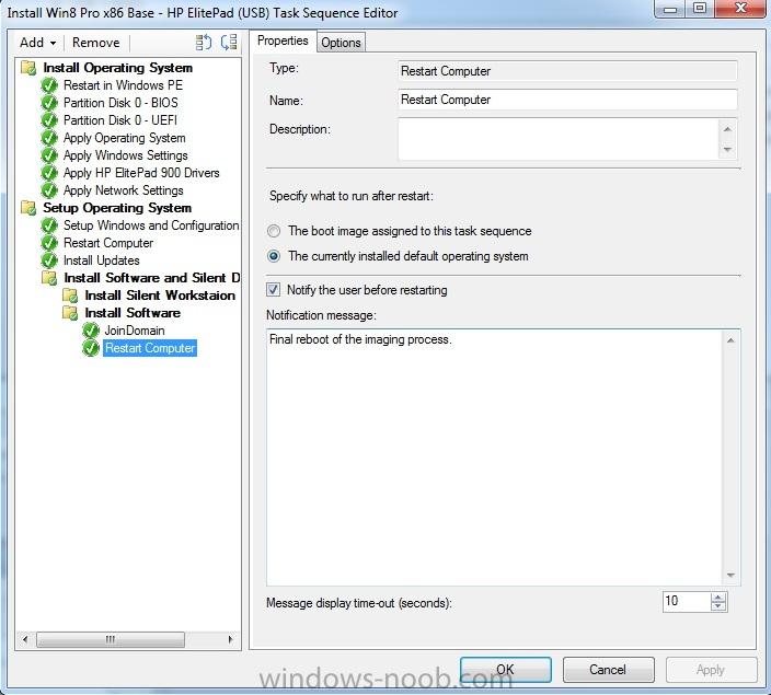

    2

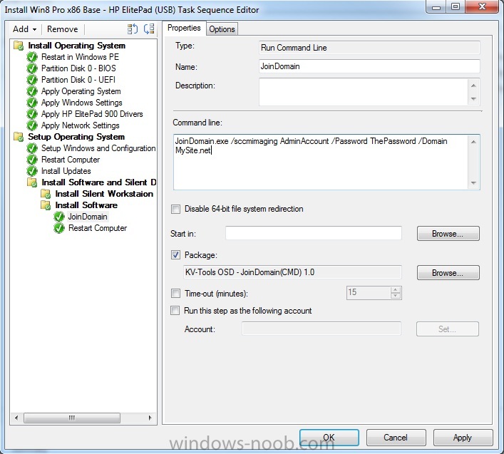

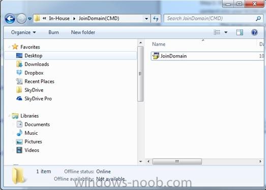

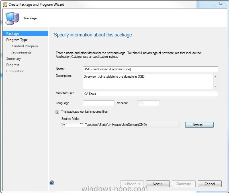

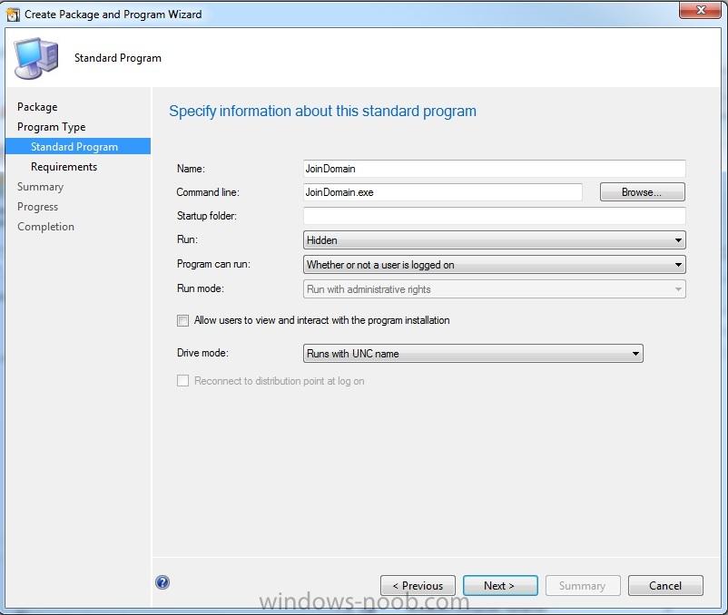

  1. "Microsoft currently does not support the ability to connect to wireless during the pre-installation environment and windows has to configure before any connections can be made." This means that no wireless connections can be made until “Setup Windows and Configuration Manager” has started. Once part of "Setup Windows and Configuration Manager" completes you will be prompted to connect to a wireless connection automatically. If you are not connected to your LAN the “Configure Network” step will not join a domain. That is the reason for step 4 saying setup your machines connection on a Workgroup. Your machine has to be able to communicate with your domain controller in order to join a domain. This guide is geared towards explaining how to imaging tablets with a USB drive & wireless, so no network cable will be connected into the machine. The example link you posted above has a network cable attached to the tablet. In a enterprise environment using USB network cable adapters can cost more money and cause issues with duplicate MACs, but that explanation is outside the scope of this post. The JoinDomain.exe does exactly what the name says. It joins the machine to the domain at the end of the OSD. Since the user connects to a wireless connection during the “Setup Windows and Configuration Manager” step, the machine will be able to communicate with the DC and join the user’s domain.
