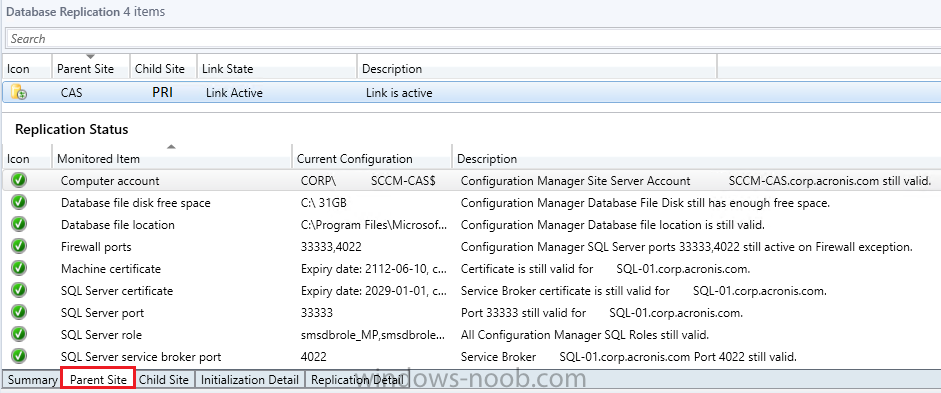

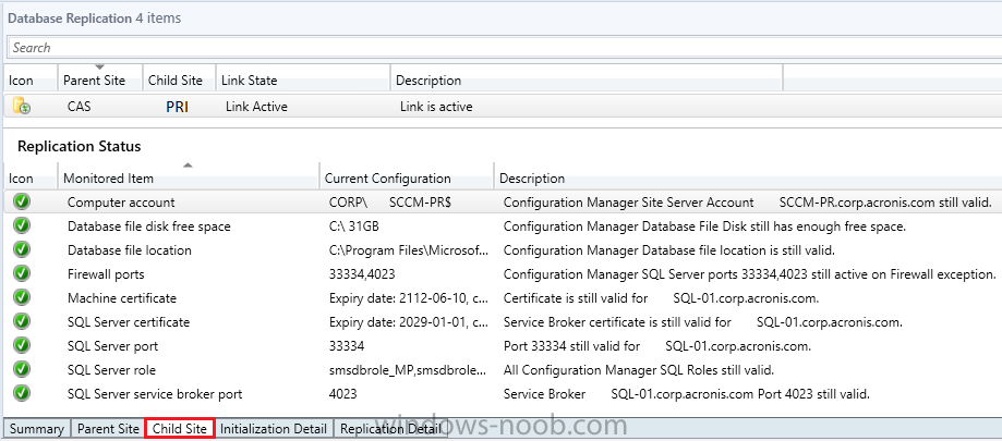

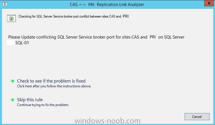

Conflicting SQL Server Service Broker Port
Hi, Whenever I run Replication Link Analyzer between my CAS and Primary Site, I receive this error message: But I don't see where the conflict is. The Parent Site uses 4022 while the Child Site uses 4023. What is conflicting? How should I resolve it? Thank you.
