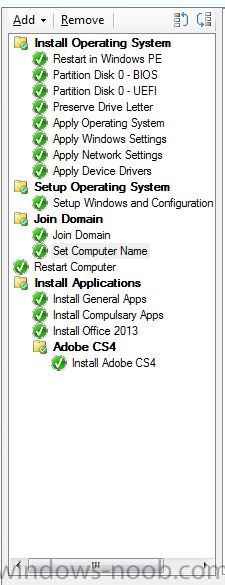

  3. Hi All I am pleeding for a little guidance. I am in the process of putting together a new image for the educational establishment that I work for. Our setup is a single site server running Win 20012 R2 with SQL 2012 and SCCM 2012 R2. The server is running on V-Sphere 5.1 Everything has been working fine until I hit the deployment of windows 7 > joining domain > installing apps/packages I have had this working on an older version of Windows/SCCM 2012 however, that server was setup incorrectly and was causing more harm than good. Thus leading me to create a new server with the above config. The OS seems to be installing perfectly as well as the joining of the domain. I have deleted all apps and OS images/installers and recreated them many times. I have also distributed and re-distributed everything. The Network Access account verifies perfectly Please see the attached smsts.log from a machine and the basic task sequence. I am aware there are errors, I am looking for a solution to these errors. Should I look at using a MDT TS instead of the standard SCCM TS? 90% of the time I get the error Code 0x80004005 (It usually errors on the install of Office 2013) Any advice would be highly appreciated. PLEASE Many Thanks Edd smsts.log smsts-20140219-162335.log
