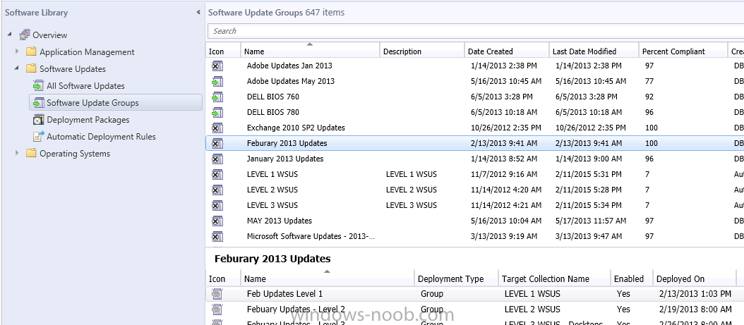

Thanks for the reply Garrett, interesting thoughts. What you've said might explain a few things.. We have an ADR for Critical/Security updates only that runs every day, and adds to an existing software update group (to avoid creating new groups everyday) - this is the one with the low compliance. I've now created another ADR to run every second wednesday for regular windows updates and to create a new group each time, so I'll monitor how that reports compliance and see how that goes. If I report out of Monitoring > Reports, the compliance numbers actually look great. It just seems to be in the Software Update Group area that shows them very low. -

We are using 4 ADRs, but my understanding of how they are used is not great. We have 3 ADRs for Level 1, Level 2, and Level 3 updates, configured as per below, and 1 ADR for Windows Protection (differences in config shown in red below) - Add to an existing Software Update Group, Enabled the deployment after this rule is run - Create New Software Update Group, Enable the deployment after this rule is run - Automatically deploy all software updates found by this rule, and approve any license agreements - Date released = Last 6 months, Superseded = No, Update class = Critical or Security Updates - Date Released = Last 1 day, Product Forefront Security Client, or Windows Defender - Run this rule every day - Deployment (varies per level, Level 1 is available ASAP and 7 day deadline, Level 2 is 7 days and 14 day deadline, Level 3 is 14 day and 21 day deadline) - Deployment available every 2 hours, deadline ASAP - Deployment Package = Windows Critical and Security Updates - Deployment package = Windows Protection Updates I'd really like to be able to break this down into a sort of workflow... 1. Updates are sync'd from MS to SCCM every day 2. ADR Level X WSUS takes critical/security updates and applies them to Level X WSUS Software Update Group 3. etc.. But I get lost in this process fairly quickly. I was under the impression that updates were a fully automated process but with compliance being shown at 7% I'm thinking there must be a manual process that isn't being done. Can anyone help me understand the typical process that this might follow? -

I checked out this area of our policy, and we do have one option Specify Intranet Microsoft updates Service Location is enabled, with a link pointing to our SCCM server. I think I have an idea as to whats going on. After looking at our Software Update Groups closer, we have groups called 2012 Updates, followed by January 2013 Updates, February 2013 Updates, March-May 2013 Updates and then no more. This is when the previous admin left. It looks to me like they were deploying updates monthly and this stopped when nobody was really responsible for the SCCM environment. I am going to do the following: Go to All Software Updates, filter by January 2015 release date, selecting those and creating a January 2015 Update Group, and deploying that to our Level 1 device collection. I think this is how it was intended to be setup. If I'm right, I'll have to try to figure out what the automatic deployment rules are really doing... -

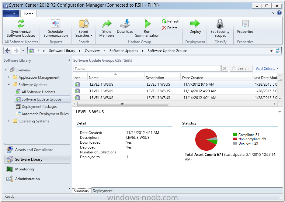

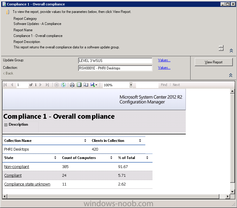

First off, I appreciate you taking some time to read through my issues and lend a hand. I'm very appreciative for the help I receive from this community I ran some compliance reports through the Monitoring tab and this does provide much better insight. I'm able to see which users/computers are compliant which will be a great breakdown going forward. However, I am still seeing very low compliance numbers. See compliance1.png I can definitely look into this - I wasn't familiar with any group policy required for SCCM? I think I would like to move to a more manual approach similar to what you are describing, where I can take all the updates that were released per month and create a group, and manually deploy these rather than relying on the auto-rules. I can see in our Software Update Groups that this might have been done in the past - there are groups named January 2013 Updates, February 2013 Updates (with veyr high compliance numbers), but there are also auto-deployment rules setup for Level 1/2/3, which was confusing. See monthlyupdates.png. Can anyone advise how an approach for moving to that sort of update system? Again, your time is much appreciated! -

Wow, that is sort of a weird way to calculate compliance, but I guess it sort of makes sense in that 90% of the systems are configured correctly (in your example). Thanks for clearing that up for me
