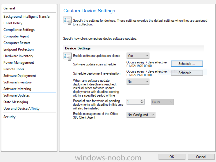

Hi guys, I am currently looking at the patch status of our devices, especially given everything that's happening at the moment. When I filter on Security Updates, I can see an update (KB4019472 for example) and the required column says 4, but I have at least 200 devices that should be requesting that patch. What am I missing? The Software Updates section for my clients are:- Enable Software Updates = Yes Software update scan schedule = Simple schedule running every day Schedule deployment re-evaluation = Simple schedule running every day When any sofwtare deployment deadline is reached..... = No Enable Management of Office 365 Client Agent = Not Configured If you need any more information then let me know. thanks, James
