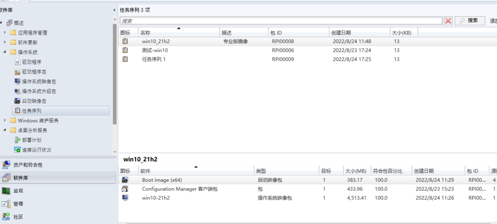

Dear all An application installation problem was encountered~~~ 1)The application has been added to MECM and deployed. 2)The status information is displayed successfully 3)Release Status——Goog cherome——The status type is displayed successfully 4)Sequence of tasks——X13——Installing the Application—— There is a Google chrome app
I'm sorry I can confirm that. My deployment is to select unknown device deployment. I've created a new quest series. It's magically done The PXE is ready to boote . Sequence of tasks I created, they're all displayed I want to know why this problem arises Avoid other people deploying this problem Cheers This task sequence has successfully deployed one device

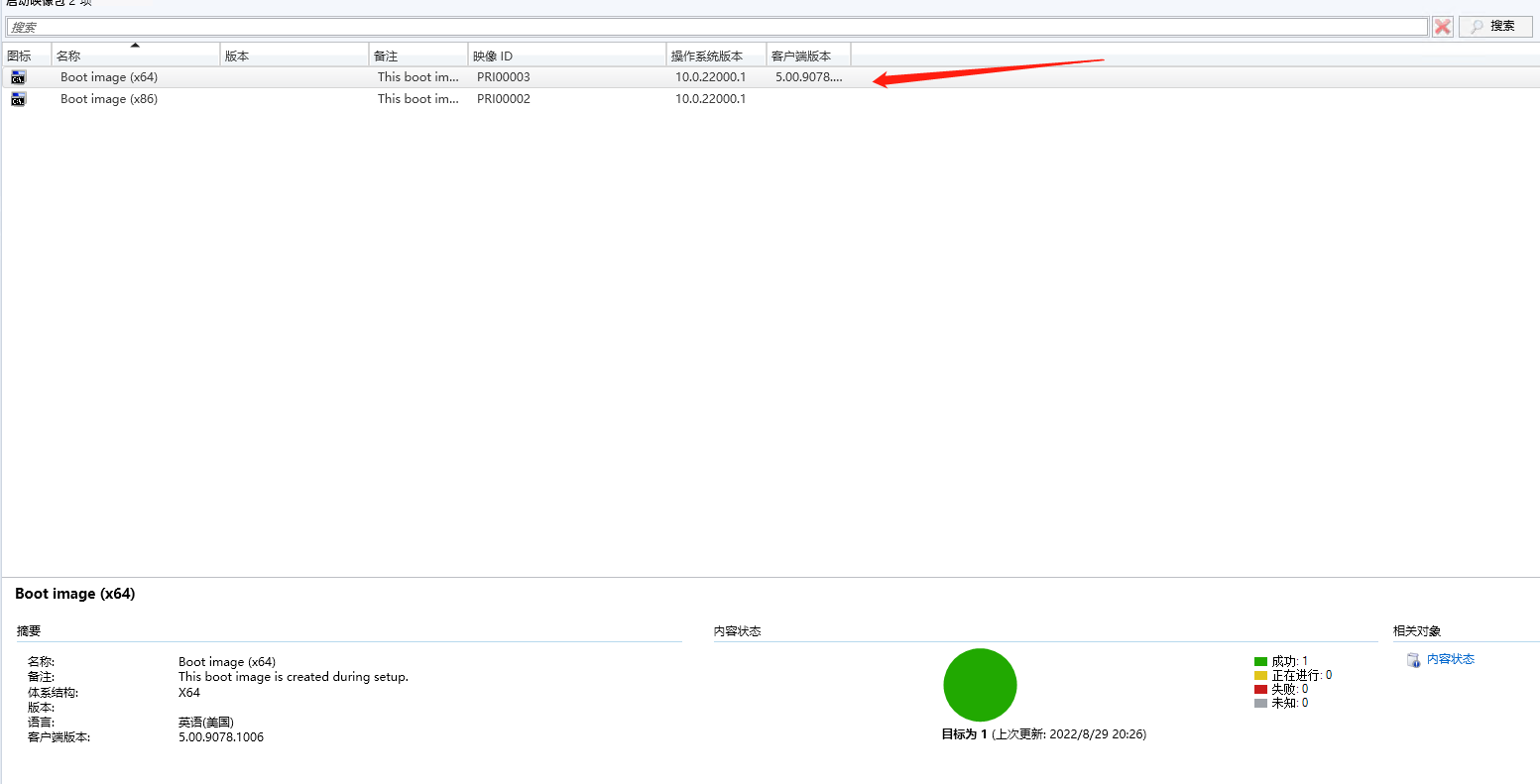

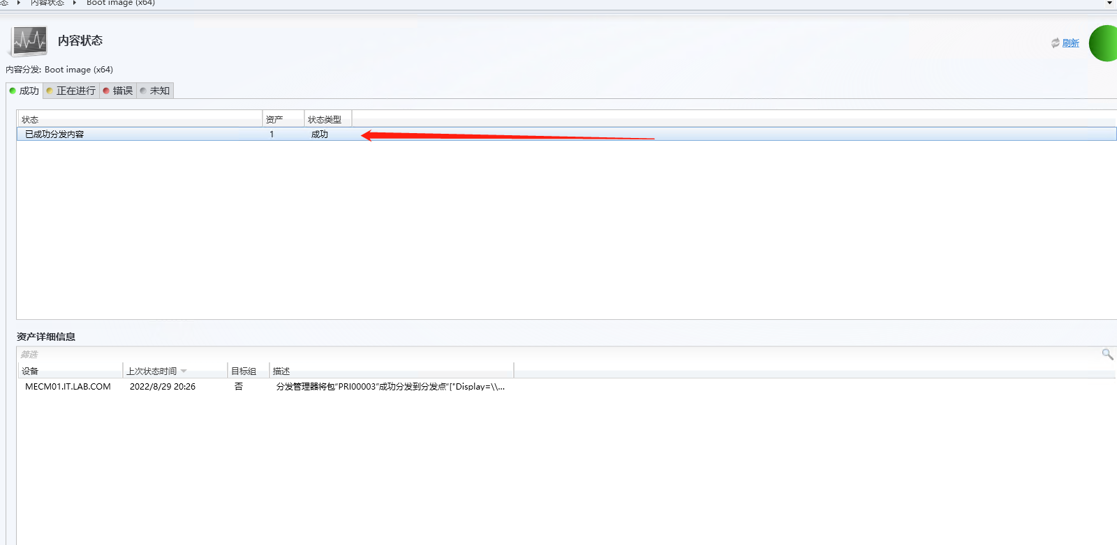

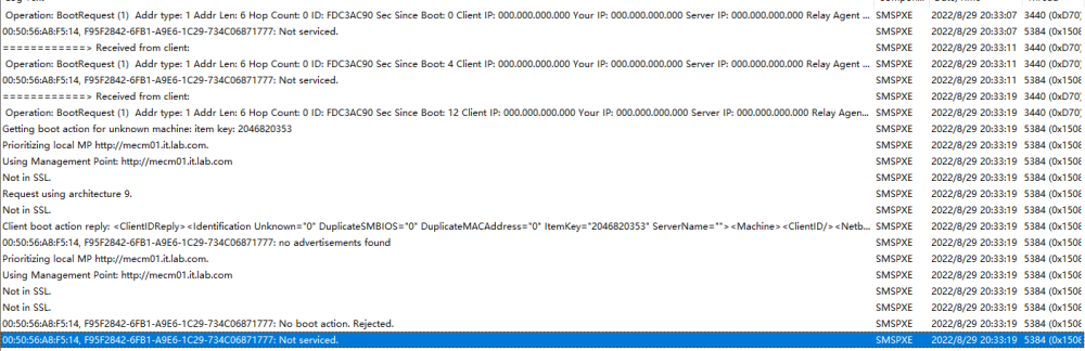

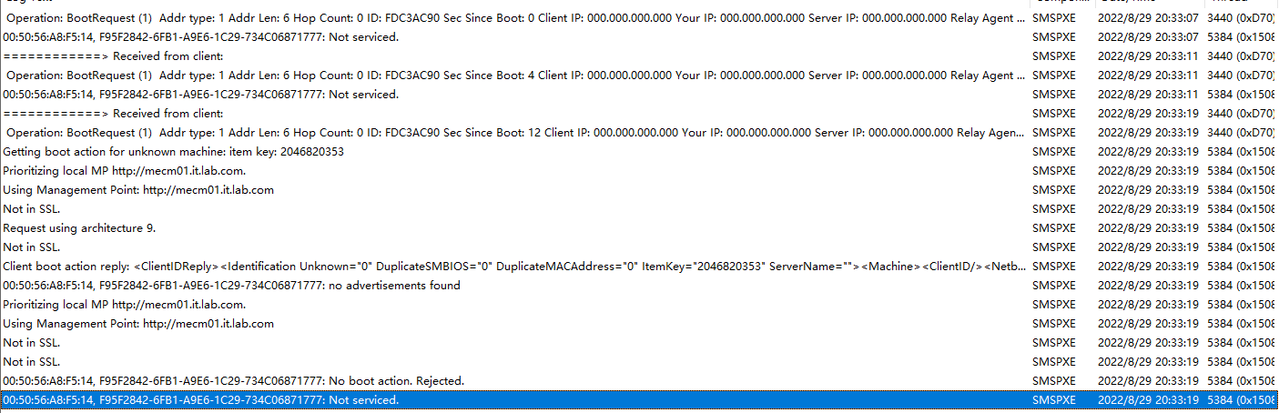

Dear all A problem was encountered, MECM2203 deployment completed. However, it cannot boot from PXE. As shown in the figure below. I only publish a boot image for the X64.Starting the mirroring status was successful I checked the smspxe.log log file. Follow this error log for a Google fix. But there is no effective solution to this problem SMSPXE.log

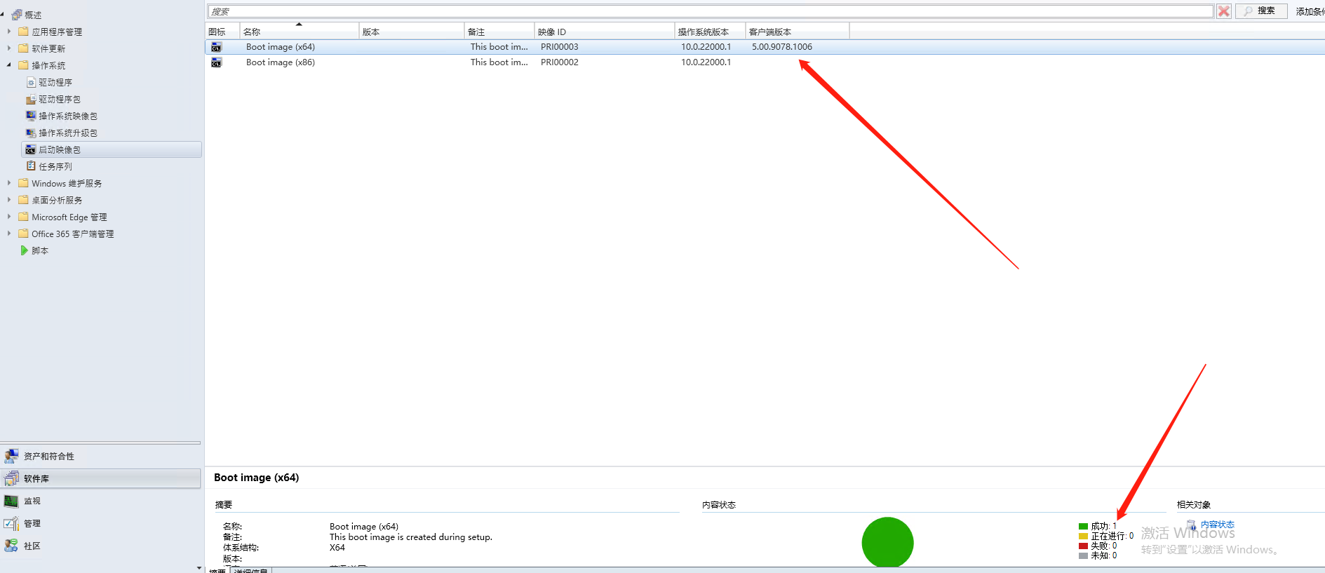

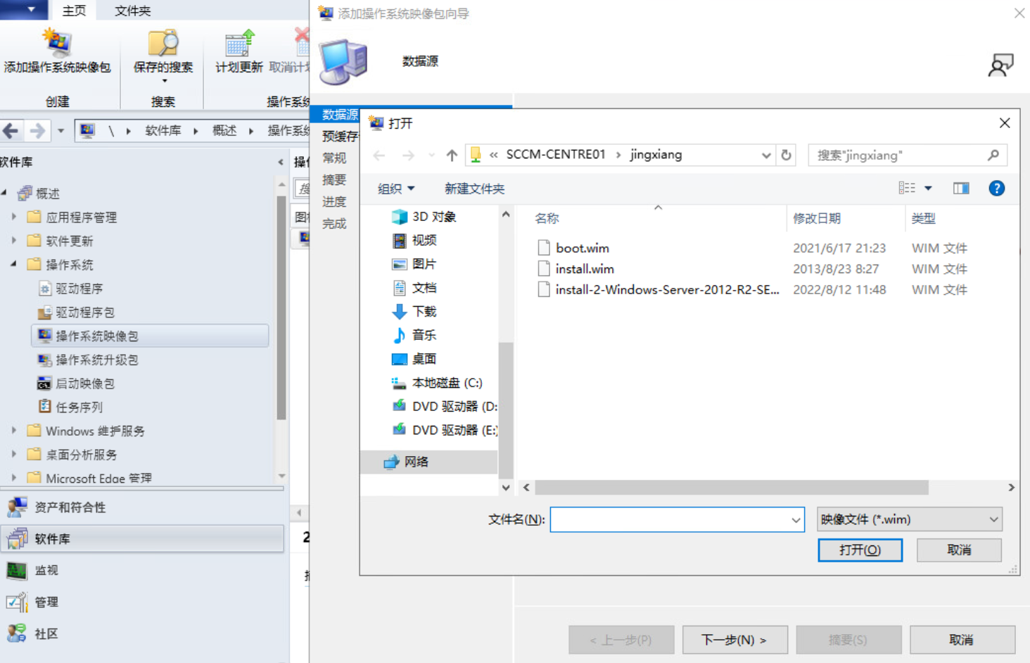

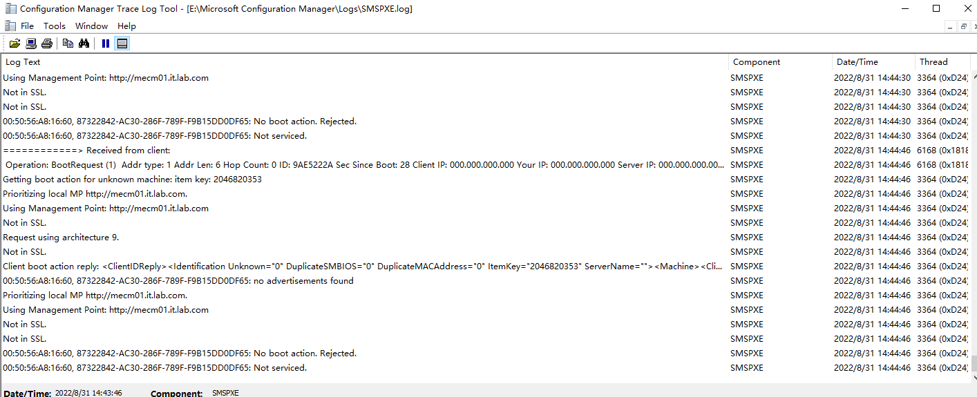

cheers I feel the boot image package problem has been solved But there are new problems. The virtual machine cannot be started in PXE. I checked the smspxe.log log file I want to know what happened to PXE Looking forward to your reply -

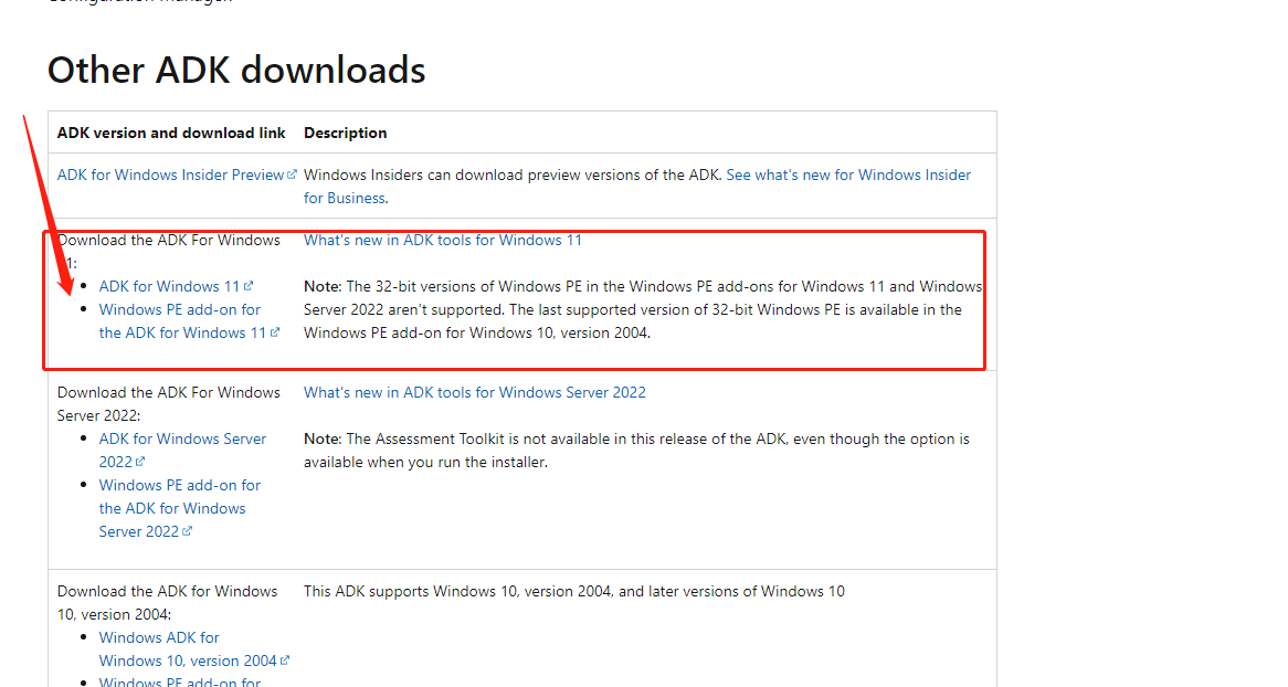

I Googled the solution for two days. But there is no effective solution to the problem. I was wondering if there was something wrong with my base environment. MECM2203 version: Will there be any special attention to deployment 1)Three DP Server 2019 2)One AD domain controller;A SQL server;The distribution point and the administration point are one DP 3)ADK&winPE The following -

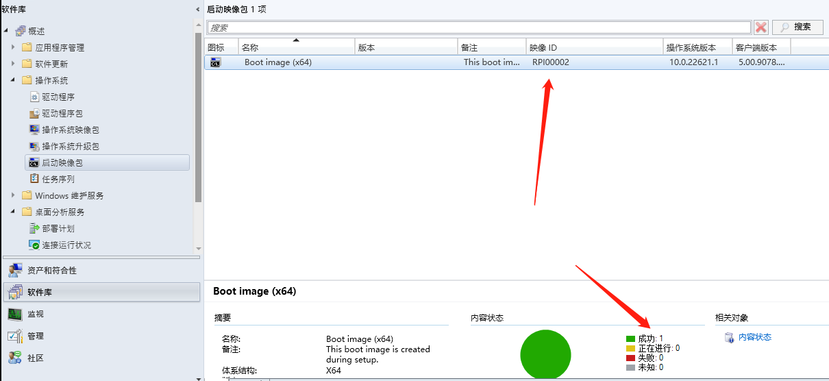

1)I checked my site and found that the image ID was the boot image package. 2)But it looks normal to me. 3)I Googled for a solution. But it didn't work. 4)Do we have a good solution? Thank you for your -
