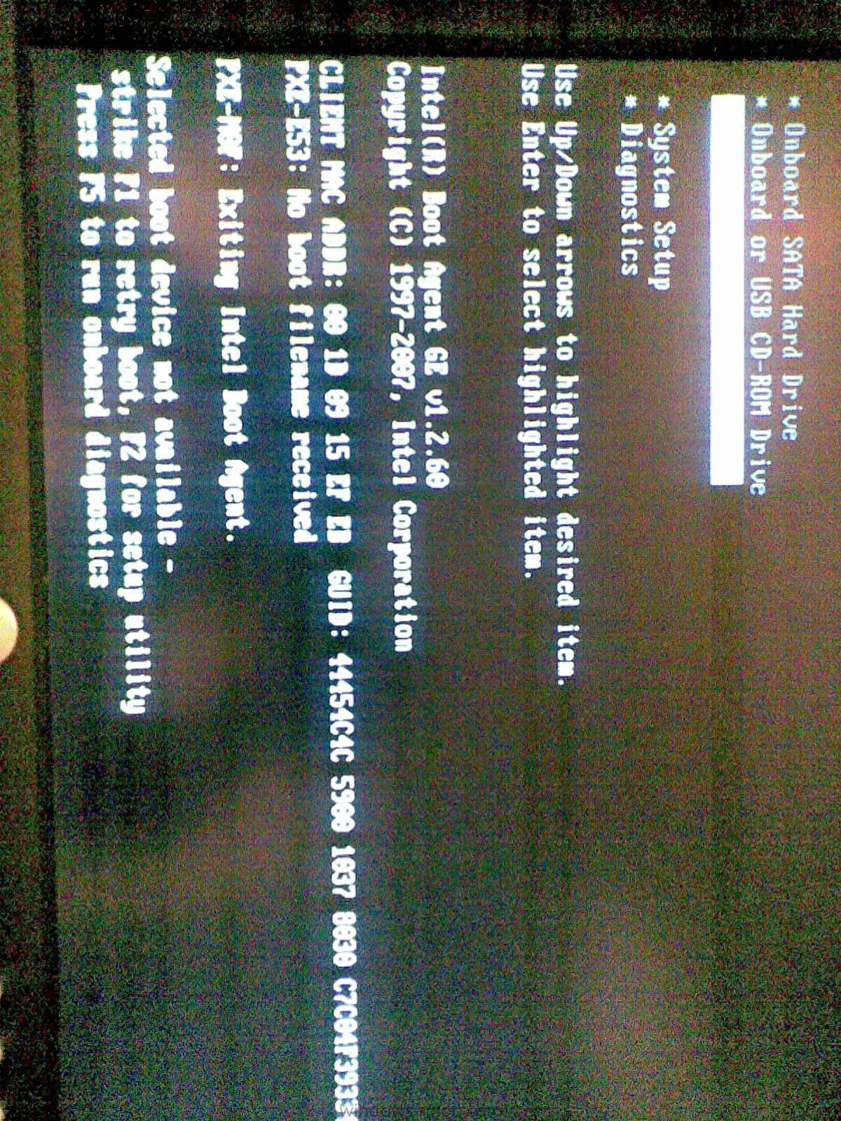

Hi Niall, I restarted both and still the same. Just let you know that AD is runnin on other server and the sccm server is runnin only sccm2007 nothing else. If you need any details please let me know Thanks Dritani This is to much to ask, (and please acept my appology for that) if you want to have a look at the server I can make this available to you. I am just desperate to finish this.
Hi Niall Just followed the instructions on the link but the same errors: TFTP... PXE -T04: Access Violation PXE -E36 Error received from TFTP server PXE-MOF Exiting Intel Boot agent I will try a bit later tonight and see. Thanks Dritani
Hi Niall, After did what you mantion earlier i am getting an diferent error: Client mac address: _:...... Client IP 10.200.9.8 (from DHCP server ) mask 255.255.0.0 DHCP server 10.200.1.12 (true) gateway IP address 10.200.1.1 (true TFTP PXE-T04: access violation PXE-E36 Error received from TFTP server PXE-MOF Exiting Intel Boot Agent. Thanks Dritani
Hi, I read that topic. Not sure what they mean by: """ Yes you need to configure 1. #60 2. #67 -- \boot\x86\pxeboot.com 3. #66 -- FQDN for SCCM server. """""""" Mean time, on my AD both two groups were not created. I created them refer to your instructions. Thanks Dritani
Hi, Thanks for your reply. The DHCP service is running on other server. I added x64, upgraded distribution points after that but still the same. Thanks Dritani
Hi, I configured the SCCM as per part 1, 2 and 3. and tried to deploy new server but received errors shown on the screen attached. Can you please help? Thanks Dritani
