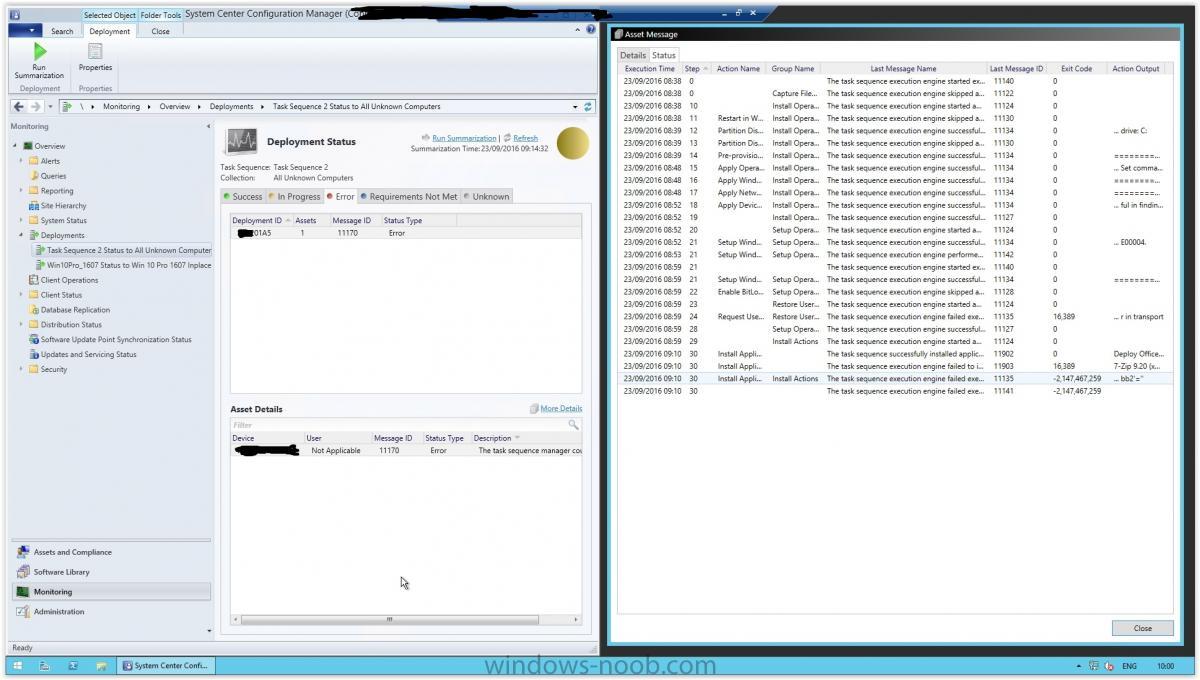

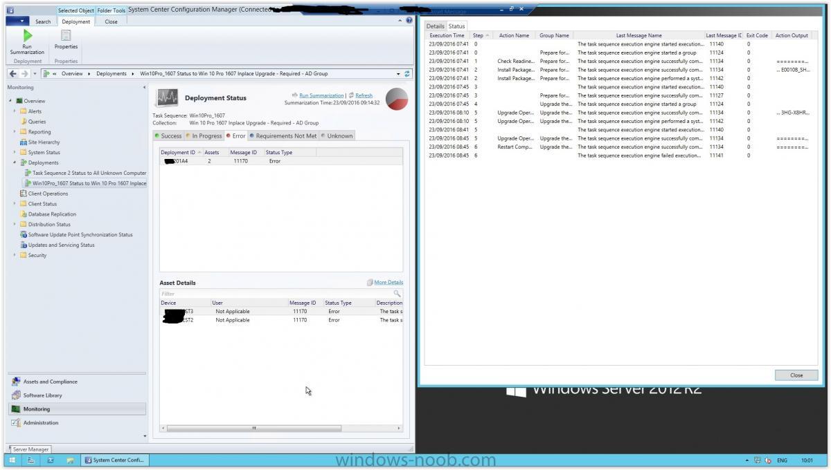

Hi I've got 2 different task sequences that are both failing with Message ID 11170. I have a fresh vanilla Windows 10 Pro deployment ts and an in-place upgrade (from Win 7 Pro to Win 10 Pro) ts. In both scenarios, both install the os, complete any installs that are required and both reboot back to the logon screen. You can login to them any everything looks good. I've attached 2 screen shots show the deployment status and I can upload any logs files required. I've done a fair bit of searching and so far turned up nothing relevant. Has anyone seen this before? Any help is much appreciated.

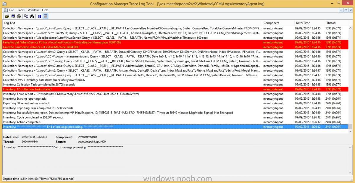

Hi I’ve got SCCM 2012 R2 SP1 deployed with around 900 clients, all 99.9% Windows 7 Pro, at the moment, we’re still in the roll out phase. We have a problem that around 250 clients are not reporting Hardware Inventories. I can see in the InventoryAgent.log on some of the clients that the inventory seems to complete, see screenshot. I’ve looked in the dataldr.log on the server and I can see some of the following And If I look in ‘E:\Program Files\Microsoft Configuration Manager\inboxes\auth\dataldr.box\BADMIFS’ There are a few folders, both ExceedSizeLimit and NonExistentRow have 400+ MIF files.... Help! What do I need to do?
