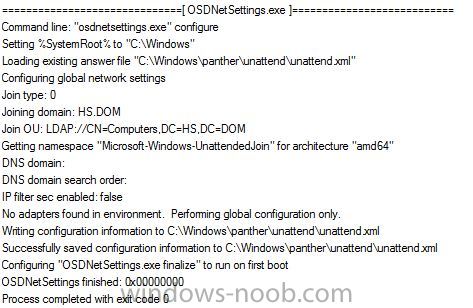

Found problem in my AD! Now everything works! :-) Thread may be closed!
Hello there, I'm trying to make an unattended join to my domain, while installing Windows 7! I'm using an autounattend.xml to perform this task! So... This, what I got in my logs: see attachment I sure, that autounattend.xml work, 'cos in this autounattend.xml also has a Create Local Account task, which works fine! Where could be my mistake? Thank you

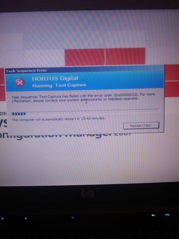

I need to create an only Capture Task Sequence. I have Windows 7, with all drivers and soft. Look down which steps I made: 1) sysprep.exe /quiet /generalize /shutdown /oobe 2) Made a task sequence in SCCM like anyweb told me "you can just rip the capture part of the build and capture ts and advertise THAT to your windows 7 capture collection, if i get time i'll do up a post" (sccm_task1.jpg) 3) Booted my PC (which I need to be captured) 4) Got an error (IMAG0001.jpg) So can anyone help me - where is my mistake? Thank you!
I've already tried this an some error appears! :-(
So, anyweb. Could be so kind and make a short manual (how-to) for Capture only task sequence? Thank you!
