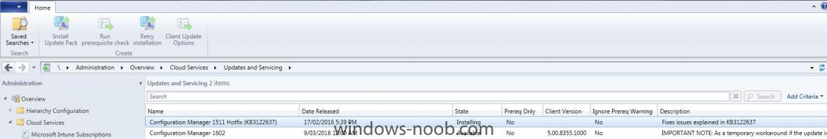

Hi, Recently the Server hosting SCCM 1511 became corrupted which required a rebuild of the server and restoration of the SCCM site via backup. There have been no issues since the restore except for SCCM being unable to install the KB3122637 hotfix via Updates and Servicing. The patch is stuck at the "Installing" stage and has been for some time. A restart was performed with no effect. In the CMUpdate log I am seeing the below errors which indicates a permissions issue for NT AUTHORITY\SYSTEM account. SYSTEM is a sysadmin on the SCCM database already so am not sure what else to look for to clear this error. I have also attached a pic of how the update looks in the console. *** [08001][2][Microsoft] Named Pipes Provider: Could not open a connection to SQL Server [2]. CONFIGURATION_MANAGER_UPDATE 22/03/2016 5:00:34 PM 1544 (0x0608) *** [28000][18456][Microsoft][sql Server Native Client 11.0][sql Server]Login failed for user 'NT AUTHORITY\SYSTEM'. CONFIGURATION_MANAGER_UPDATE 22/03/2016 5:00:34 PM 1544 (0x0608) *** [42000][4060][Microsoft][sql Server Native Client 11.0][sql Server]Cannot open database "CM_VIC" requested by the login. The login failed. CONFIGURATION_MANAGER_UPDATE 22/03/2016 5:00:34 PM 1544 (0x0608) *** [08001][2][Microsoft][sql Server Native Client 11.0]A network-related or instance-specific error has occurred while establishing a connection to SQL Server. Server is not found or not accessible. Check if instance name is correct and if SQL Server is configured to allow remote connections. For more information see SQL Server Books Online. CONFIGURATION_MANAGER_UPDATE 22/03/2016 5:00:34 PM 1544 (0x0608) *** Failed to connect to the SQL Server, connection type: SMS ACCESS. CONFIGURATION_MANAGER_UPDATE 22/03/2016 5:00:34 PM 1544 (0x0608) Any help would be appreciated. if you need more info let me know Regards, Ben
