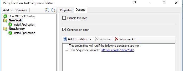

  5. I figure it out. I'm using my customsettings.ini file which is how I determined Region and Locations based on gateway and copy the ztigather.wsf, ZTIDataAccess.vbs, ZTIGather.xml, ZTIUtility.vbs and customsettings.ini. 1. Created a package with these files 2. replicated to DP's 3. Created Task Sequence with a run command line and selecting the new package 4. added command line "cscript ztigather.wsf" 5. added MySite variable to the groups created in the TaskSequence When I deploy the Task Sequence it run the ztigather.wsf setting all my variables based on the customsettings.ini file, this then determines the region and site based on gateway and it runs the appropriate section based on the variables. hope this helps someone out there.
  6. How can I dynamically figure out the location, for example.. let's say i wanted to add a condition to deploy a Group based on gateway or prefix of computer name. What would be the best variable to use that will give me this type of automation?
