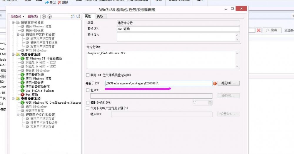

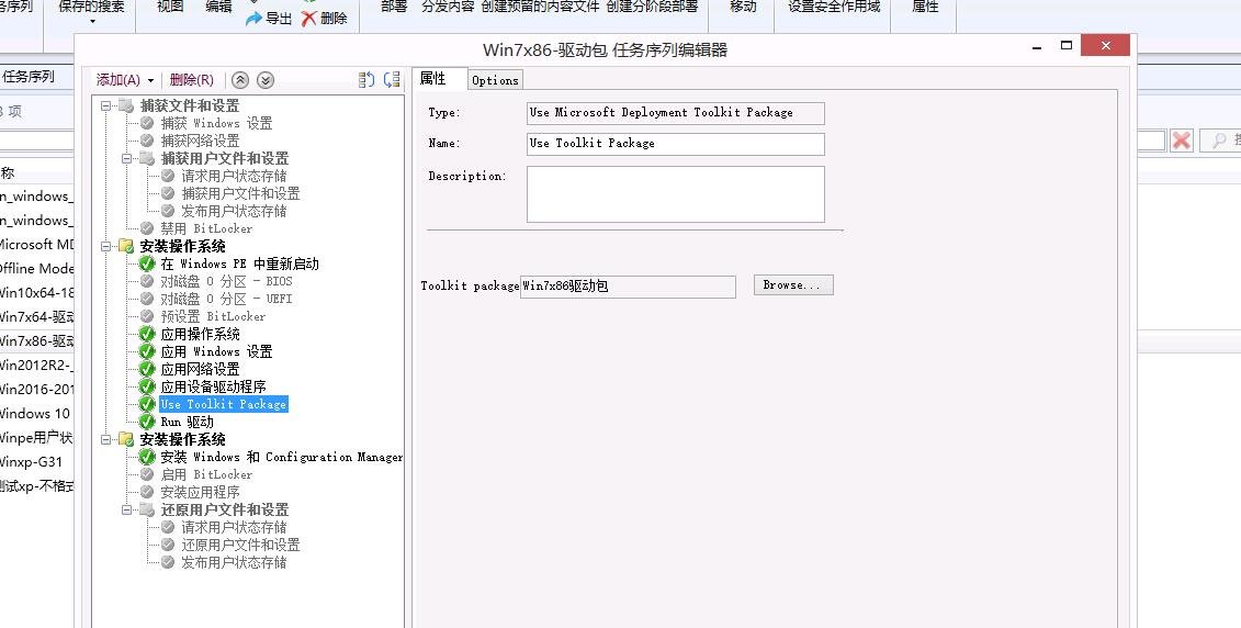

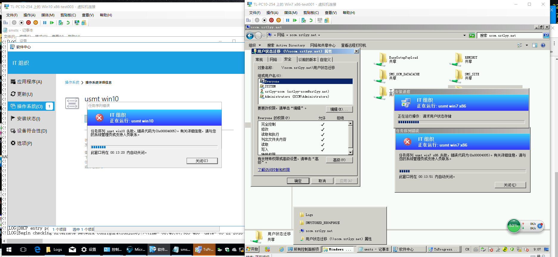

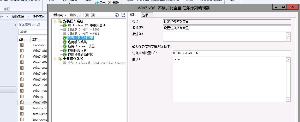

    Guānyú_SMSTasksequence wénjiàn jiā shìfǒu biànliàng mìnglìng lái dàitì? Yòng mdt fābùle yīgè qūdòng bāo rúhé zhǐdìng mìnglìng lù jìn zhíxíng suǒzài chéngxù,_SMSTasksequence\packages\12000061\EasyDrv7_Win7.X86.Exe/Fa, wǒ fāxiàn zhège_SMSTasksequence wénjiàn jiā yǒu shíhòu huì zài zuìdà défēn qū lǐmiàn, bǐrú shì C.D huòzhě E wǒ gāi rúhé zhǔnquè zhíxíng_SMSTasksequence\packages\12000061\EasyDrv7_Win7.X86.Exe/Fa ne?
    展开
    246/5000
    关于_SMSTasksequence文件夹 是否变量命令 来代替?
    用mdt发布了一个驱动包
    如何指定命令路劲 执行所在程序,_SMSTasksequence\packages\12000061\EasyDrv7_Win7.x86.exe /Fa,
     我发现这个_SMSTasksequence文件夹有时候会在最大得分区里面,比如是C 。D或者E
    我该如何准确执行_SMSTasksequence\packages\12000061\EasyDrv7_Win7.x86.exe /Fa 呢?
    About the _SMSTasksequence folder Is the variable command instead?
    Released a driver package with mdt
    How to specify the command path to execute the program, _SMSTasksequence\packages\12000061\EasyDrv7_Win7.x86.exe /Fa,
      I found that this _SMSTasksequence folder is sometimes in the largest scoring area, such as C. D or E
    How can I accurately execute _SMSTasksequence\packages\12000061\EasyDrv7_Win7.x86.exe /Fa?

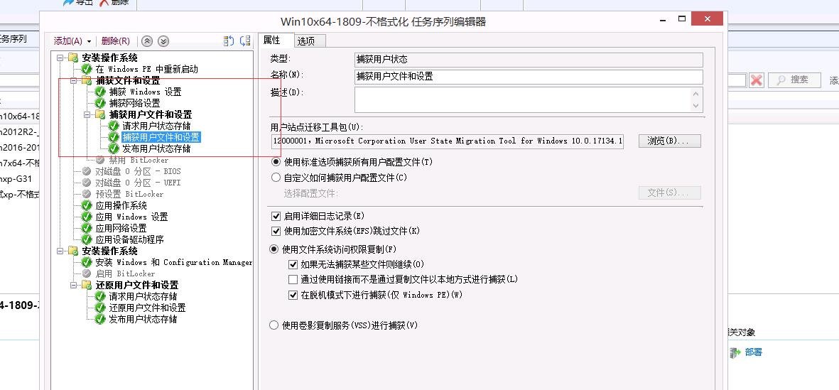

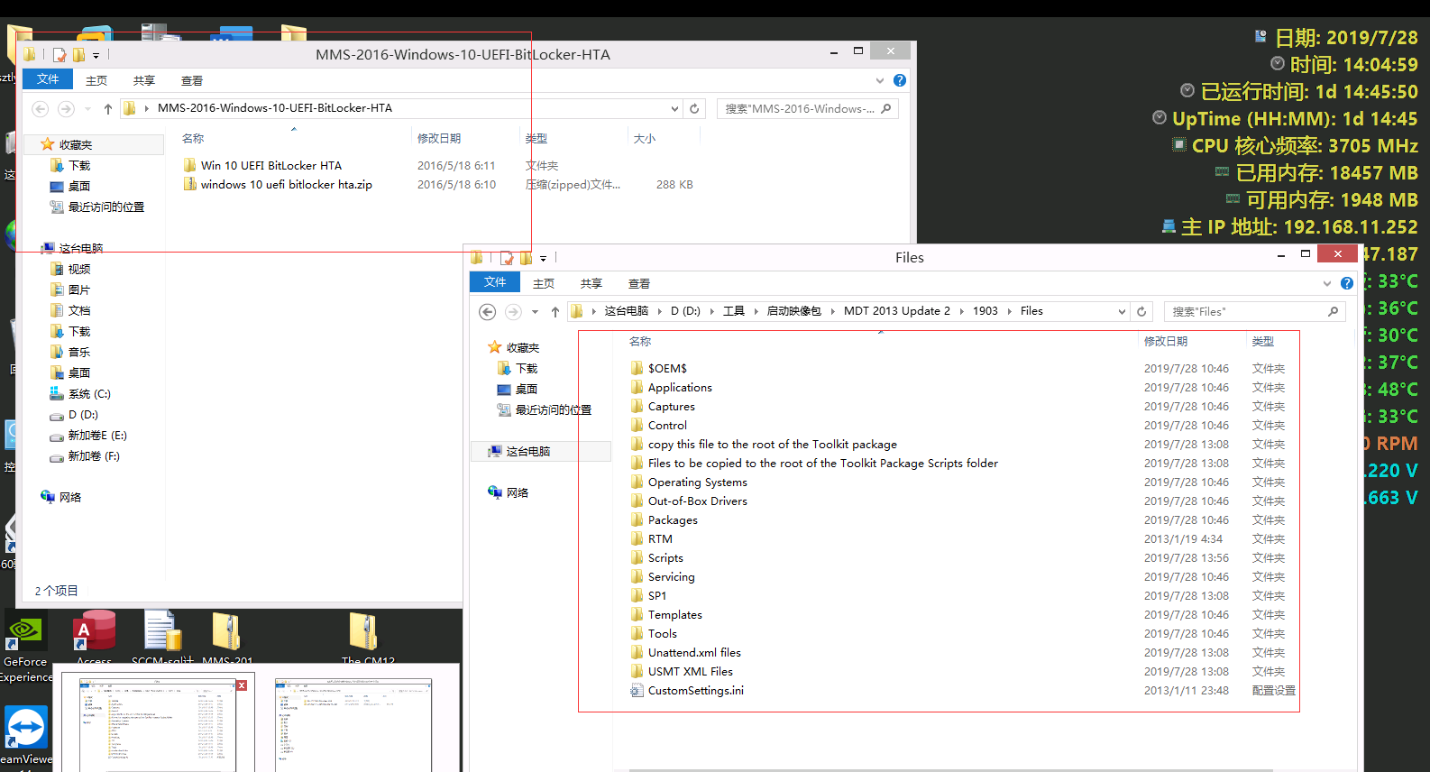

  2. 5 hours ago, radish said:
    非常感谢您的帮助。但是,我只想将USMT用户状态信息传输到WinPE的下的服务器,我暂时不需要使用的BitLocker。
    只需配置此MDT 2013,您可以使用彩信吗?
    将MDT 2013与Configuration Manager 2012 R2集成 - 指南
    无需再配置MBAM了吗?
    安装和配置MBAM 2.0或更高版本-指南1,2指南
    安装和配置MAIK Kosters博士Web服务-指南(不要忘记安装ASP.NET 3.5和相关的ISAPI扩展)
    目前SCCM版本是SCCM1902和MDT2013 update2插件
    The current SCCM version is SCCM1902 and MDT2013 update2 plugin.
    这个MMS-2016-Windows-10-UEFI-BitLocker-HTA 是替换旧The CM12 BitLocker FrontEnd HTA  哪些得对应文件夹目录?
    This MMS-2016-Windows-10-UEFI-BitLocker-HTA is the replacement of the old The CM12 BitLocker FrontEnd HTA which corresponds to the folder directory?

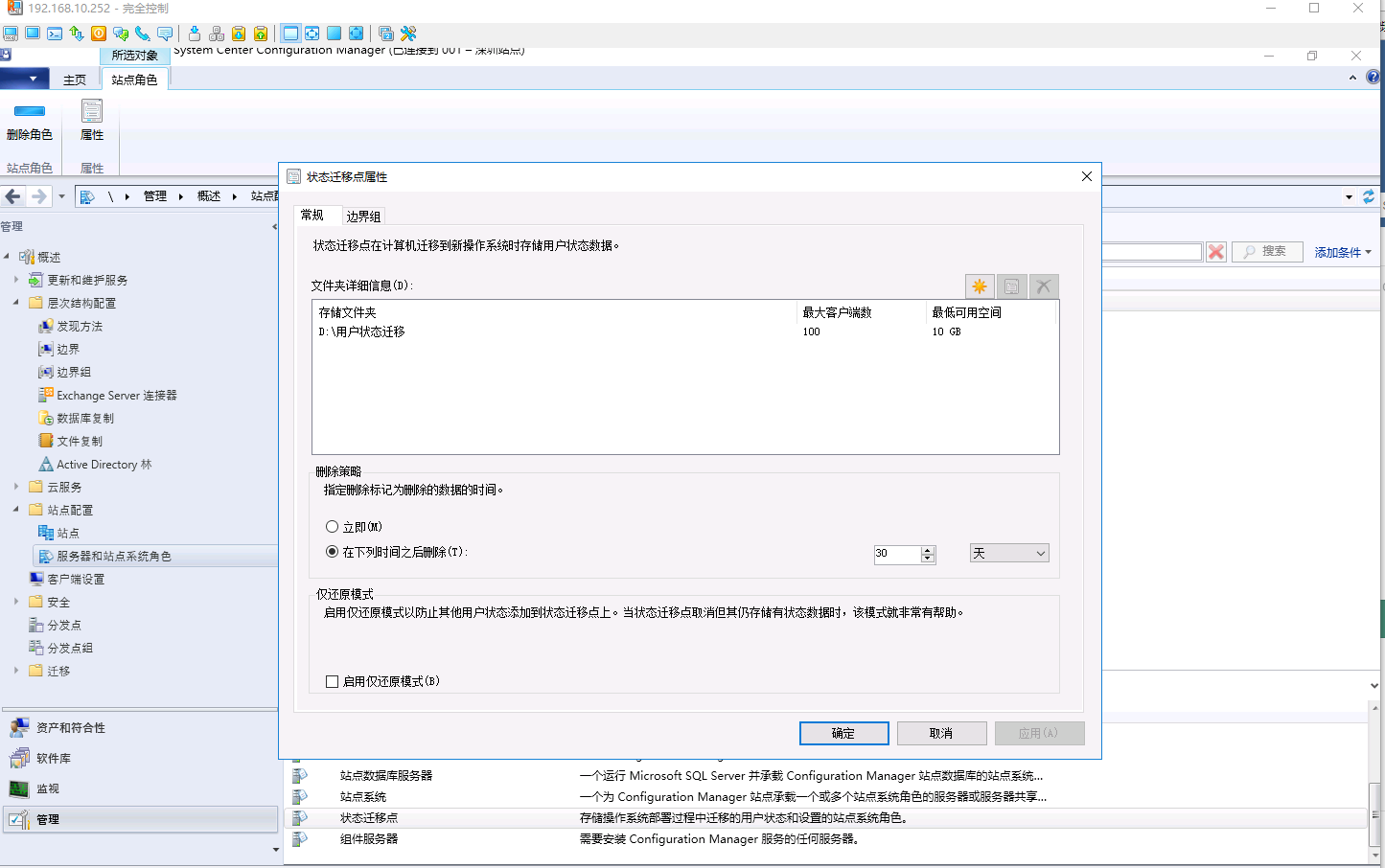

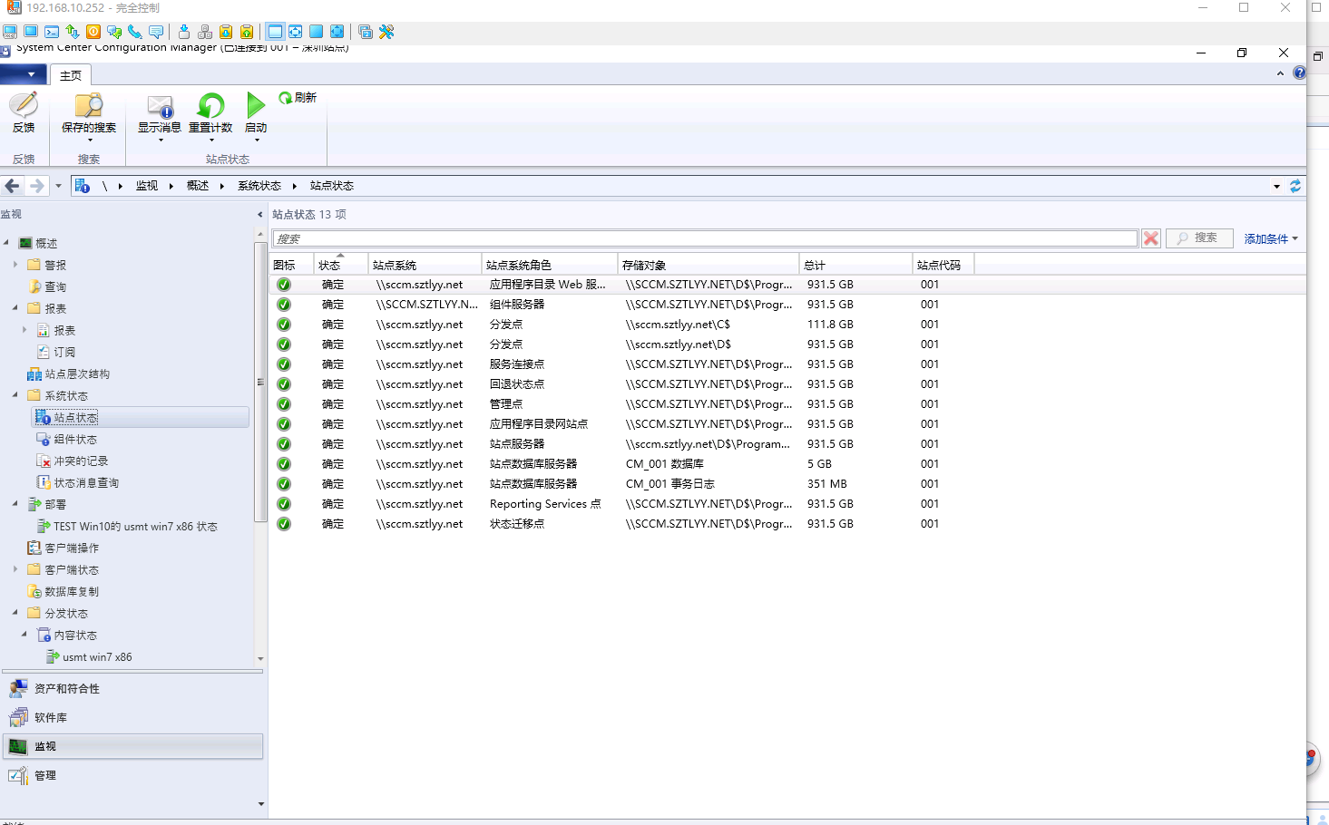

  3. 4 hours ago, anyweb said:
    ok so you want to transfer data using USMT while in WinPE to a state store, you could use my prebuilt HTA to help with that, it even works with BitLocker if you have an MBAM back end.
    https://www.niallbrady.com/2016/05/17/introducing-the-windows-10-uefi-bitlocker-frontend-for-system-center-configuration-manager-current-branch/
    Thank you very much for your help. However, I only want to transfer the usmt user status information to the server under winpe, and I don't need to use BitLocker for the time being.
    Just configure this MDT 2013, can you use MMS?
    Integrate MDT 2013 with Configuration Manager 2012 R2 - Guide
    No need to configure MBAM anymore? ? !
    Install and configure MBAM 2.0 or later - Guide 1, Guide 2.
    Install and configure Maik Kosters web services - Guide (don't forget to install ASP.NET 3.5 and associated ISAPI extensions)

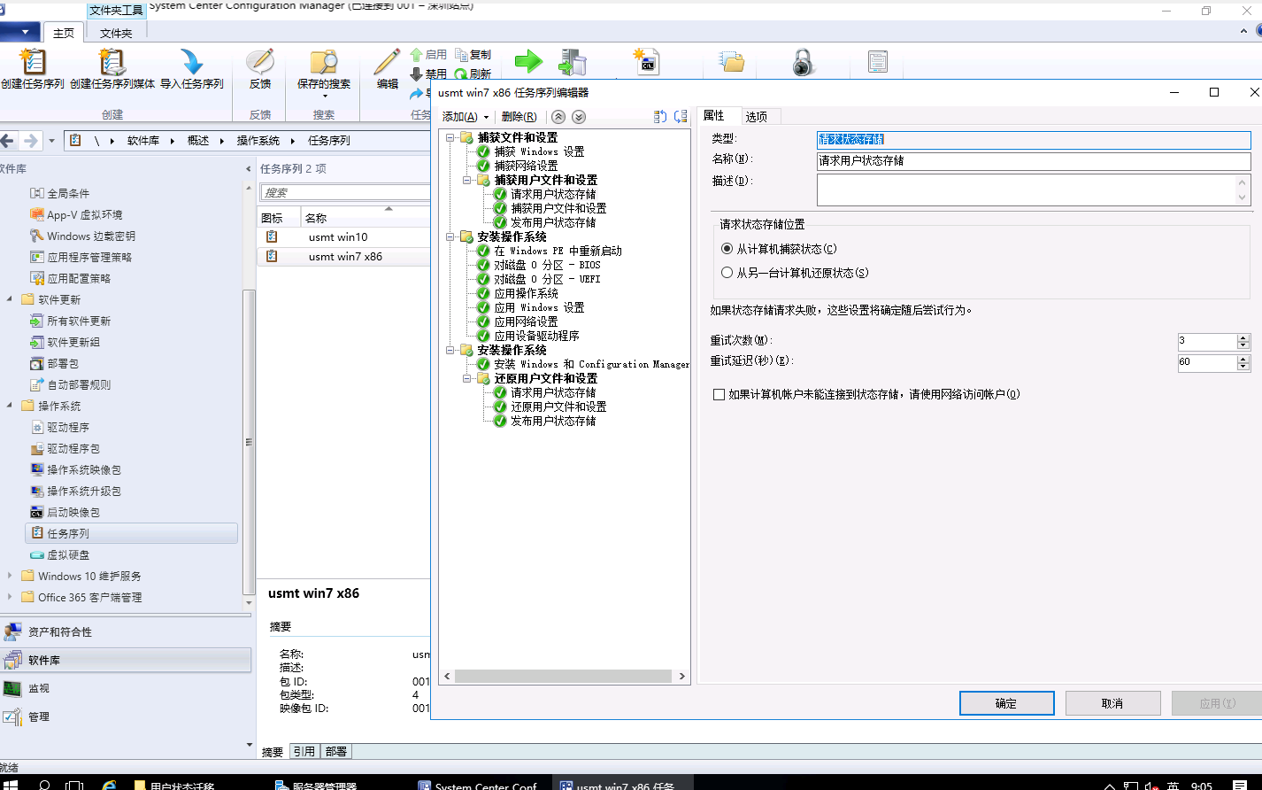

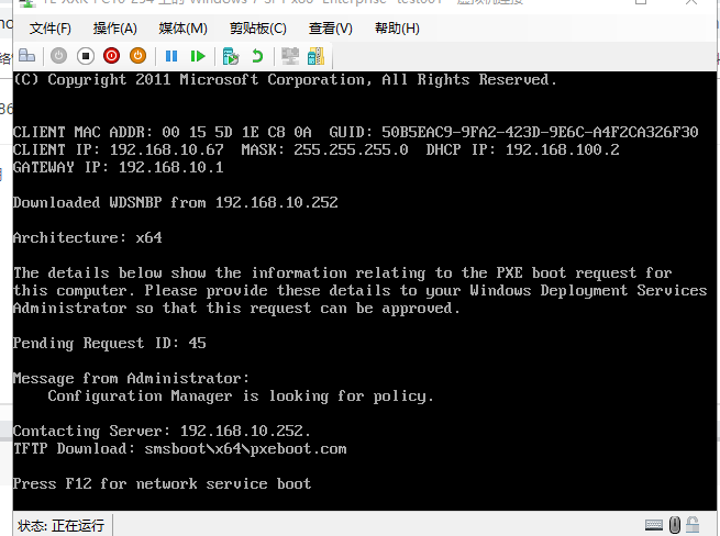

  4. Excuse me, I want to start the OS image after the computer presses F12 pxe to capture the user data and transfer it to the server instead of formatting the disk installation system immediately.
    This method is useful when transferring data sometimes when the computer system can't get in.
    How is this set up?
    According to this setting, it seems that the user settings are not captured first, but the application deployment is started directly.

  6. Hello, I would like to ask how to install the system on multiple hard disks. There are script files to share. When there are multiple hard disks in my computer, the deployment system should be installed on the disk number partition where the original system is specified. Is there any solution?
    你好,请问 在多个硬盘上 安装系统 可有脚本文件分享啊,  当我电脑存在多个硬盘时候,     部署系统要安装在原来系统指定所在的磁盘编号分区上,有什么办法解决吗
  7.
    The sccm deployment system is automatically deployed to partitions that already have systems.
      I have some computers with multiple hard disks. Suppose the environment has three hard disks in the computer. According to the sata1 sata2 sata3 arrangement, the system has the first partition system on the sata1 disk, and some of the first partitions on the sata2 disk. Some systems are in the system. First partition on sata3 disk
    Then through the sccm deployment automatically determine the deployment to the sata1 disk or sata2 disk or sata3 on the first partition of the system, how to do it?
    The OSDDetectedWinDir variable does not seem to take effect. How do I set this task sequence parameter to the deployment system to automatically determine which disk partition the system is in, and install it in the corresponding partition.
    sccm 部署系统自动部署到 已经有系统的分区上问题
     我有些电脑 多个硬盘,假设环境中电脑硬件 3个硬盘 按sata1 sata2 sata3  排列方式, 系统有的在sata1磁盘上第一个分区系统,有的在sata2磁盘上第一个分区,系统有的在sata3磁盘上第一个分区
    那么要通过sccm部署  自动判断部署到sata1磁盘或sata2磁盘或sata3所在系统的第一分区上,改如何操作做呢?
    OSDDetectedWinDir变量貌似不能生效,请问如何设置这个任务序列参数达到部署系统自动判断系统在哪个磁盘分区,就安装在对应的分区。

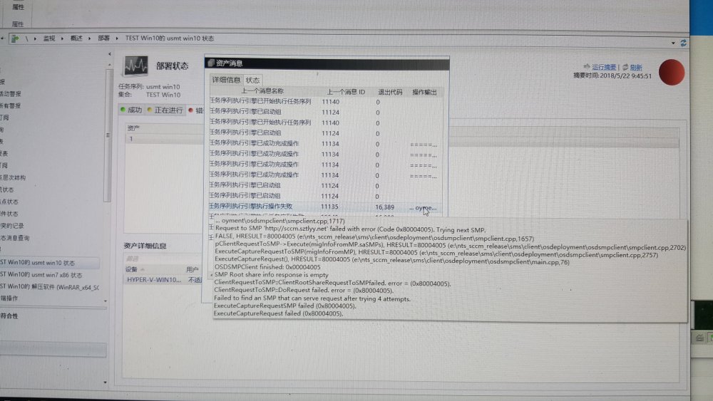

  8. 2 hours ago, anyweb said:
    它没有与USMT国家移民点交谈,是否配置?
    <![LOG [错误。状态码500返回] LOG]!> <time =“07:22:00.631-480”date =“05-21-2018”component =“OSDSMPClient”context =“”type =“0”thread =“4276”file =“libsmsmessaging.cpp:9551”>
    <![LOG [Received [1164 byte response。] LOG]!> <time =“07:22:00.631-480”date =“05-21-2018”component =“OSDSMPClient” context =“”type =“0”thread =“4276”file =“smpclient.cpp:2376”>
    <![LOG [pReply!= NULL,HRESULT = 80004005(e:\ nts_sccm_release \ sms \ client \ osdeployment \ osdsmpclient \ smpclient.cpp,2391)] LOG]!> <time =“07:22:00.631-480”date =“05-21-2018”component =“OSDSMPClient”context =“”type =“0”thread =“ 4276“file =”
    <![LOG [ClientRequestToSMP :: ClientRootShareRequestToSMP失败。error =(0x80004005)。] LOG]!> <time =“07:22:00.631-480”date =“05-21-2018”component =“OSDSMPClient”context =“”type =“3”thread =“4276 “file =”smpclient.cpp:2442“>
    <![LOG [ExecuteRootShareInfoRequest(sRootShareList),HRESULT = 80004005(e:\ nts_sccm_release \ sms \ client \ osdeployment \ osdsmpclient \ smpclient.cpp,1717)] LOG]!> time =“07:22:00.631-480”date =“05-21-2018”component =“OSDSMPClient”context =“”type =“0”thread =“4276”file =“smpclient.cpp:1717”>
    < ![LOG [ClientRequestToSMP :: DoRequest失败。错误=(0x80004005)。
    Hello, state migration point configuration, ah, Is dns problem?
  9. 测试环境,测试环境
    Win2016
    SCCM1706
    ADK1709
    测试客户端系统,测试客户端系统
    Win10和Win7的
    Usmt捕获用户状态失败0x00004005,请解决,谢谢
    出现捕获用户状态失败
    这怎么一回事?
    无法捕获用户状态,因此无法捕获用户状态
    ,发生了什么?
    smsts.log
    已解决,通过网络保存用户状态迁移,不能用中文文件夹,改成英文 就可以正常通过网络捕获状态转移了。
    Has been resolved, through the network to save the user state migration, can not use the Chinese folder, change to English can be normally transferred through the network capture state.

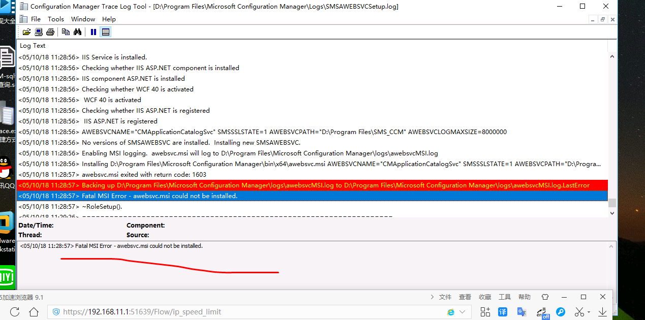

  10. SCCM 1802 版本
    操作系统 Win 2016
    选HTTS通信得话,应用程序目录和WEB服务不能正常
    安装https 443 应用web目录 失败
    日志如下
    SCCM 1802 version
    Operating System Win 2016
    If HTTS communication is selected, the application directory and WEB service cannot be normal.
    Failed to install https 443 application web directory
    The log is as follows
    <05/10/18 14:23:40> ====================================================================
    <05/10/18 14:23:40> SMSAWEBSVC Setup Started....
    <05/10/18 14:23:40> Parameters: D:\Program Files\Microsoft Configuration Manager\bin\x64\rolesetup.exe /install /siteserver:SCCM SMSAWEBSVC 0
    <05/10/18 14:23:40> Installing Pre Reqs for SMSAWEBSVC
    <05/10/18 14:23:40>         ======== Installing Pre Reqs for Role SMSAWEBSVC ========
    <05/10/18 14:23:40> Found 1 Pre Reqs for Role SMSAWEBSVC
    <05/10/18 14:23:40> Pre Req SqlNativeClient found.
    <05/10/18 14:23:40> SqlNativeClient already installed (Product Code: {E381D93A-761D-419F-AD91-D770495D33BD}). Would not install again.
    <05/10/18 14:23:40> Pre Req SqlNativeClient is already installed. Skipping it.
    <05/10/18 14:23:40>         ======== Completed Installation of Pre Reqs for Role SMSAWEBSVC ========
    <05/10/18 14:23:40> Installing the SMSAWEBSVC
    <05/10/18 14:23:40> Passed OS version check.
    <05/10/18 14:23:40> IIS Service is installed.
    <05/10/18 14:23:40> Checking whether IIS ASP.NET component is installed
    <05/10/18 14:23:40> IIS component ASP.NET is installed
    <05/10/18 14:23:40> Checking whether WCF 40 is activated
    <05/10/18 14:23:40>  WCF 40 is activated
    <05/10/18 14:23:40> Checking whether IIS ASP.NET is registered
    <05/10/18 14:23:40>  IIS ASP.NET is registered
    <05/10/18 14:23:40> AWEBSVCNAME="CMApplicationCatalogSvc" SMSSSLSTATE=1 AWEBSVCPATH="D:\Program Files\SMS_CCM" AWEBSVCLOGMAXSIZE=8000000
    <05/10/18 14:23:40> No versions of SMSAWEBSVC are installed.  Installing new SMSAWEBSVC.
    <05/10/18 14:23:40> Enabling MSI logging.  awebsvc.msi will log to D:\Program Files\Microsoft Configuration Manager\logs\awebsvcMSI.log
    <05/10/18 14:23:40> Installing D:\Program Files\Microsoft Configuration Manager\bin\x64\awebsvc.msi AWEBSVCNAME="CMApplicationCatalogSvc" SMSSSLSTATE=1 AWEBSVCPATH="D:\Program Files\SMS_CCM" AWEBSVCLOGMAXSIZE=8000000
    <05/10/18 14:23:42> awebsvc.msi exited with return code: 1603
    <05/10/18 14:23:42> Backing up D:\Program Files\Microsoft Configuration Manager\logs\awebsvcMSI.log to D:\Program Files\Microsoft Configuration Manager\logs\awebsvcMSI.log.LastError
    <05/10/18 14:23:42> Fatal MSI Error - awebsvc.msi could not be installed.
    <05/10/18 14:23:42> ~RoleSetup().

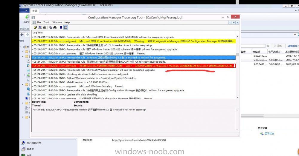

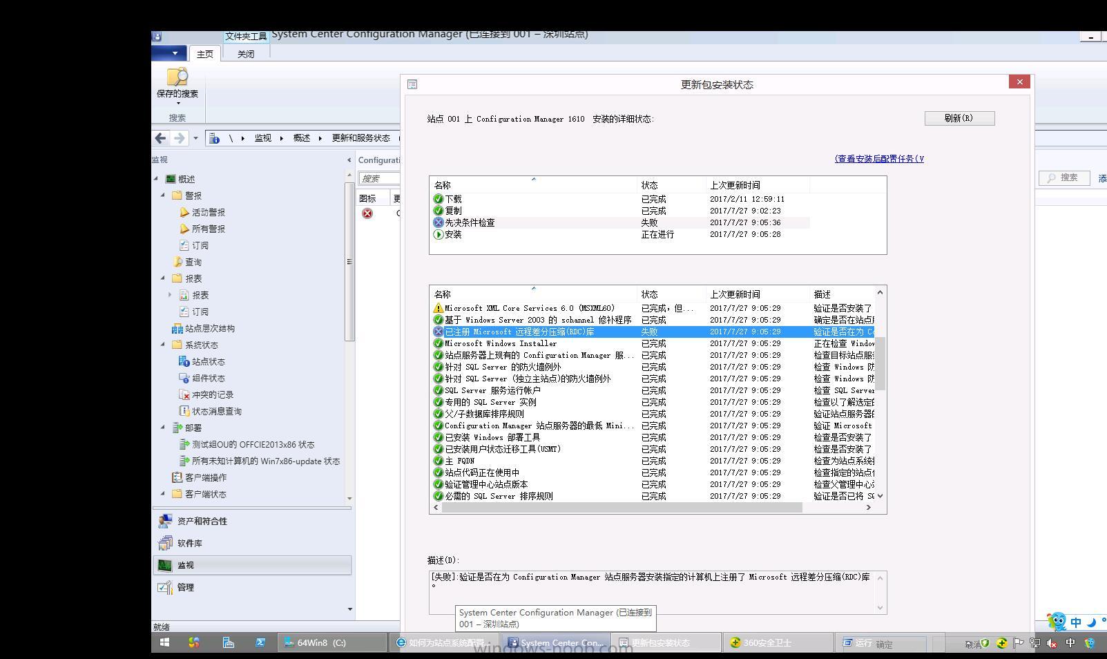

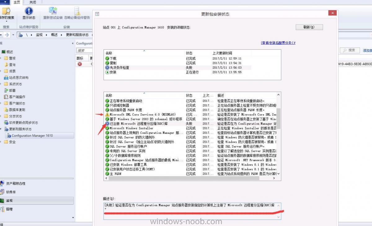

  11. SCCM1606 Upgrade prompt to register DRC,
    搭建环境:Win2012R2(SCCM)                                     域服务器:Win2012R2(AD1 and AD2)
    Setting up environment: Win2012R2(SCCM)               Domain server:Win2012R2 (AD1 and AD2)
    远程拆分压缩删除了,再安装 还是一样会出现报错RDC,不知怎么回事了!
    Remote split compression deleted, and then install the same or the error RDC, I do not know how the matter!
    困扰很久了,求助各位有知道的吗?
    Troubled for a long time, help you have to know?
    ConfigMgrPrereq.log
    ConfigMgrSetup.log
