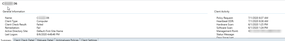

  1. We have a ton of ConfigMgr clients that are showing they are on, but "inactive". Clients haven't sent their heard beat or inventory in several days...see attached pic. These machines have been powered on all week. They aren't able to install software from Software Center or take deployments. We recently upgraded to 5.00.8968.1000 and installed a hotfix. Any suggestions on what to check? Management Points all look good. Reinstalling the client appears to work but there are tons. We do use Sophos AV and recently tried Endpoint out before deciding to stay with Sophos. Sophos rolled out a new version and we added the following exceptions: C:\Windows\CCM C:\Windows\CCM\*.sdf C:\Windows\CCM\ServiceData C:\Windows\CCMCache C:\Windows\CCMSetup C:\Windows\CCM\Logs Any help would be appreciated!

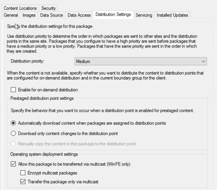

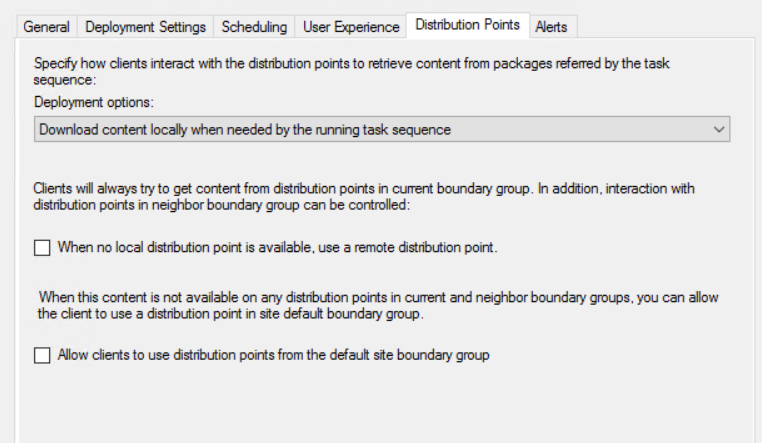

  3. Running version ConfigMgr 5.00.8634.1000 build 8634 and trying to test multicast on the same VLAN, but the task sequence fails with error code 0x800070002. It worked about 6 months back., but haven't checked it since and we've upgraded version since then. Checked the Operating System Image to make sure that Multicast is enabled, checked the Network Access Account is set, checked the DP multicast settings, and checked the TS for downloading content. See screenshots below. I'm probably missing something. Any ideas? Distribution Point - Multicast settings Operating System Images - Distribution Settings Task Sequence - Deployment Options Thanks!
