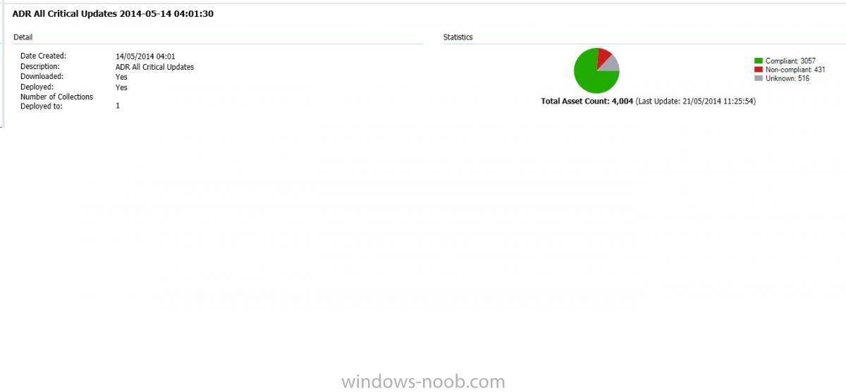

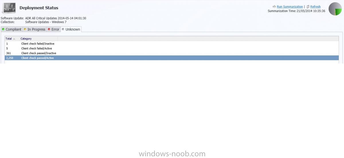

Hi, I have various update deployments and some of them are automatic rules etc. I have an issue where on a couple of the deployments the status doesn't seem to be correct in the monitoring tab (picture1) If I look in the software deployment tab it shows it shows what are presumably the correct results (picture2): Is there a reason why the 2 statuses don't match? It appears to be like this for another deployment too. I originally thought that it may have been because there were quite a few expired updates in the deployment but after taking them out it has not made a difference to what is displayed. Can anyone shed any light on this please? Thanks, Al

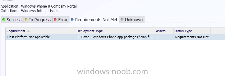

SCCM Intune Windows 8 phone enrollment
apug666 replied to apug666's topic in Configuration Manager 2012
I've resolved this - the app was set to required. This must have prevented the install. -
Hi, Can anyone help with this? I've setup a trial for windows intune, done all the prereqs etc and my test windows 8 phone enrolls fine and appears in sccm with no problems. The issue I have is that the company portal doesn't appear on th ephone and the applications seems to have an issue as shown in the attached pic. It is definitely a windows 8 phone - nokia lumia 1320. Can anyone shed any light on this please? Thanks in advance, Al
