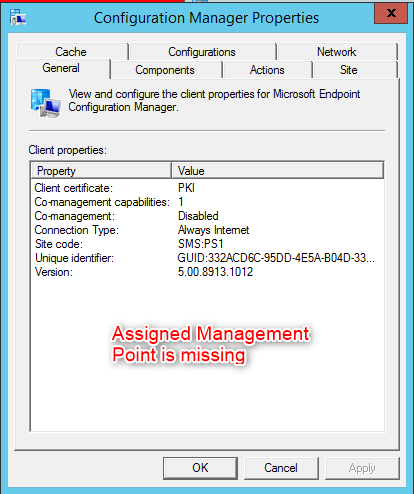

  2. Marc in another thread ? Thanks for the screenshot - I see that also here assigned management is not filled in or is that just when a client connects to 'Currently intranet' ? But that does not resolve my issue for bitlocker Unable to find suitable Recovery Service MP. Forcing policy non-compliant

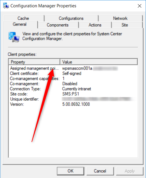

  3. Hey Niall, Thanks for answering ... Can I have a printscreen of your 'General' ? FQDN is automatically filled in ? Do you use CMG ? OUrs is a DP MP reachable from 'internet'

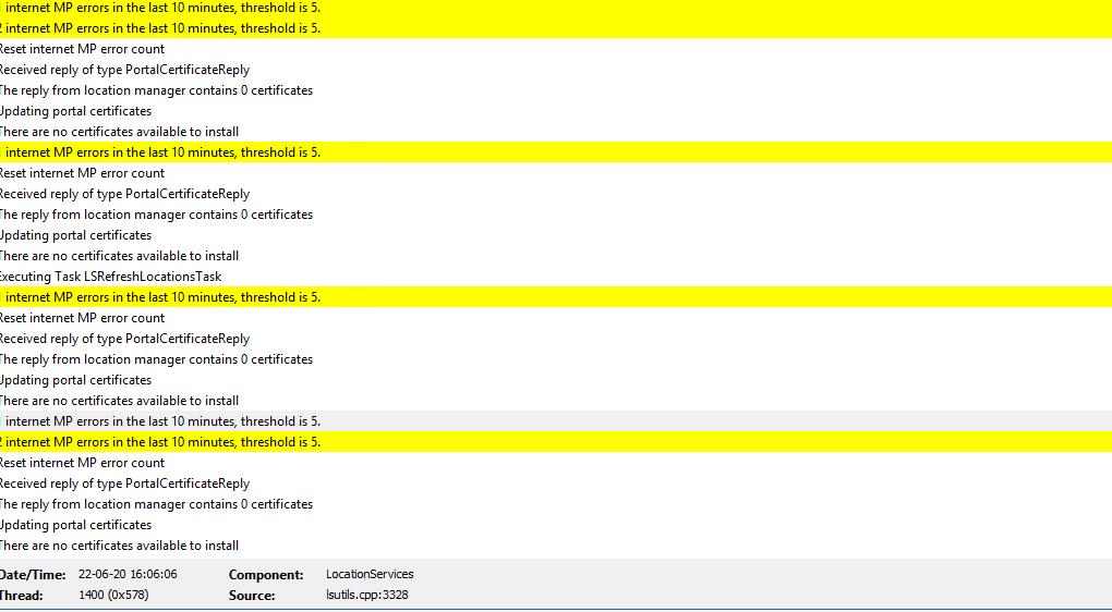

  4. Hello Windows-Noob I have implemented already 2 years ago IBCM - PKI infrastructure - however when I try to execute Bitlocker I 'm still getting following error Unable to find suitable Recovery Service MP. Forcing policy non-compliant. I always thought everything was going well - no issues with deploying software - no issues with policies/ configuration baseline - no issues with windows updates BUT we have a SCCM HTTP (lab) and there I saw that the client indicates his 'Assigned Management Point' and that is not the case with our non domain/workgroup machines. In LocationServices LOG there is the following error 1 internet MP errors in the last 10 minutes, threshold is 5. So my guess is there is something wrong !! I saw blogs on the internet for IBCM PKI enabled where Assigned Management Point entry is filled in. Anyone ?
