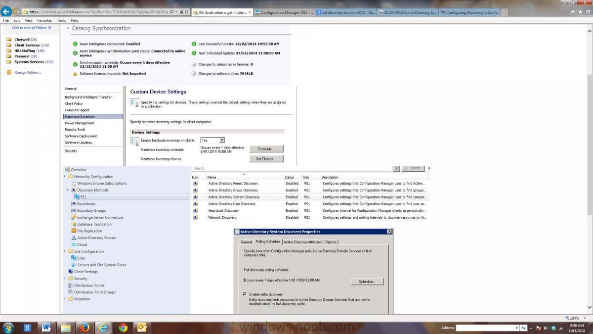

Sorry, not totally sure. But I assume AD (see attached screenshot)?
Is there a difference in timing between AD discovery and network discovery? I don't understand the difference
I'm a bit confused why do you say that you have discovery enabled at 11am ever day? you AD discovery is setup to run every 7 day at midnight and it look like you have delta discovery enable and the default is every 5 minutes.
When a new PC is created does it not show up within the All systems collection within ~10 minutes?

Clearly I'm struggling. I thought that the fact that hardware inventory was set to daily (under Custom Settings) was set to daily meant that hw inventory happened every 24 hours?

If you have you HW inventory set to daily then it will happen every day, once the CM12 client is installed.
BUT... That does NOT mean that it will show up within all collations within 24 hours. Hence the reason why I asked where are you looking for this details. Are you looking for it within the All Systems Collection?
