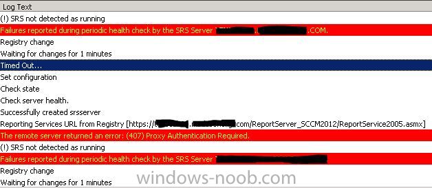

I got some issue when install Reporting Service Point SCCM 2012 R2, i'm using 2 server, this one server for SCCM and other server for SQL server, my SQL server already have 2 intance, one for SCOM and one for my SCCM
SCCM 2012 R2 = WINDOWS SERVER 2012
SQL SERVER 2008 R2 SP1 + CU 12 = WINDOWS SERVER 2008
this below is the log, i'm always try to looking for some workaround, but till now, i try to bypass connection between SCCM server and SQL server from proxy server, but still error. Anyone can help me ?
This error has nothing to do with CM12 it has to do with either your proxy server and how it is configured or how the client proxy setting are configured. I would look at the client proxy setting first.
Keep in mind that Proxy setting are user driven and therefore you will need to local at the local system account proxy settings.
ok Grath, i wanna say thanks for your advice...i would try, to check my proxy setting
