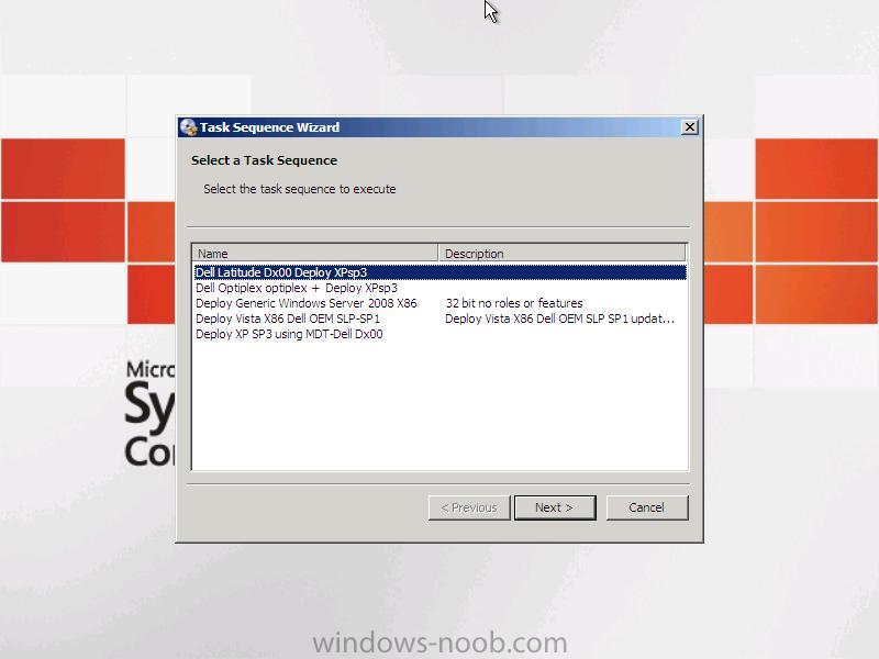

Hi
Just wondering if deploying multiple TS to the unknown Computer collection in SCCM 2012 works this way also.
I have just tested this by deploying 2 TS to the unknown collection . I have a test server on a hyper-v box at a remote site and have added the unknown computer collection to its DP group. It does not prompt me which TS I wish to install?
I posted a question in relation to this a few days ago but no-one has replied as of yet.
Thanks
Rocket Man

I have since created a new OS installer image(just a base install.wim) and distributed it out to 2 of my remote sites. I then deploy the 2 ceatedTS each pointing to each wim file to the unknown computer collection and make it available for PXE. (Both wims are distributed to remote site now)
I wait 5-10 mins before PXE booting the test VM at one of the remote sites...and still it does not prompt me to which TS I would like to install...it just wants to install the last TS I deployed from the 2.
Any ideas why this is so?
