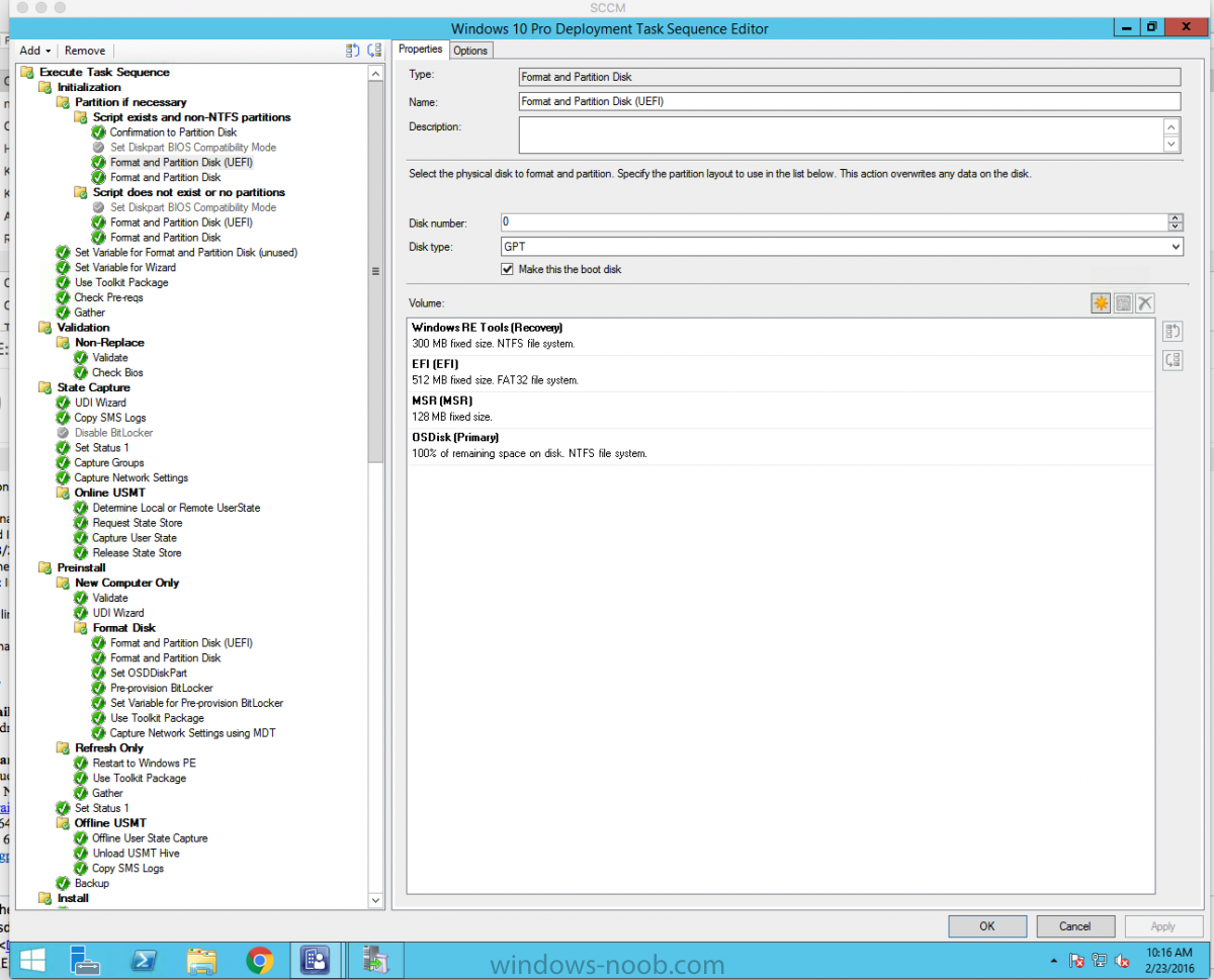

First off,
Thank you for all the how-to's. I was able to build an sccm environment with practically no experience.
I am able to push out windows 10 images using mdt task sequence but the drive does not get encrypted via bitlocker.
I have it enabled via the mdt task sequence but i am not sure what else i should to.
TPM is enabled.
Thank you.

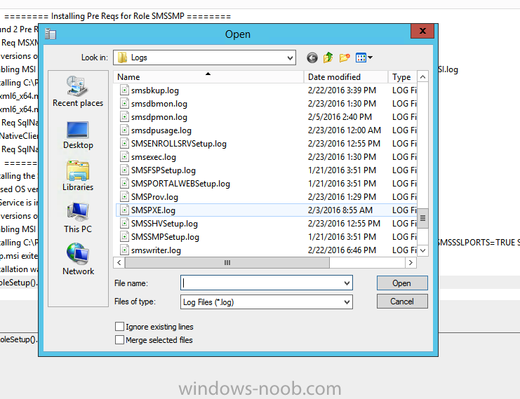

i don't see the enable bitlocker step at all in either log (parsing is not the same thing, it just means it's reading through the steps prior to executing the task sequence)
