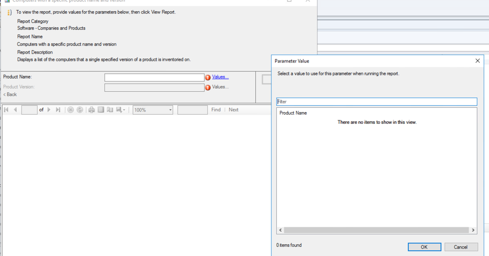

HI I have similar issue,
When i try to run a report tried to add the value but VALUE of the product Name is not visible. Please find the attachment,
First off that report doesn't use HW inventory. It use SW inventory. SW inventory is disabled by default as it is useless. https://www.enhansoft.com/sccm-software-inventory/
Instead use the ARP reports to see what is installed on computers.
