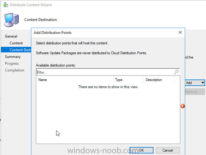

I updated the TS to change OU, but now i am missing DP from the "add distribution points" window.
Is this because: If the content is already on the DP, then that DP won't show up in the list.??
Thank you.
