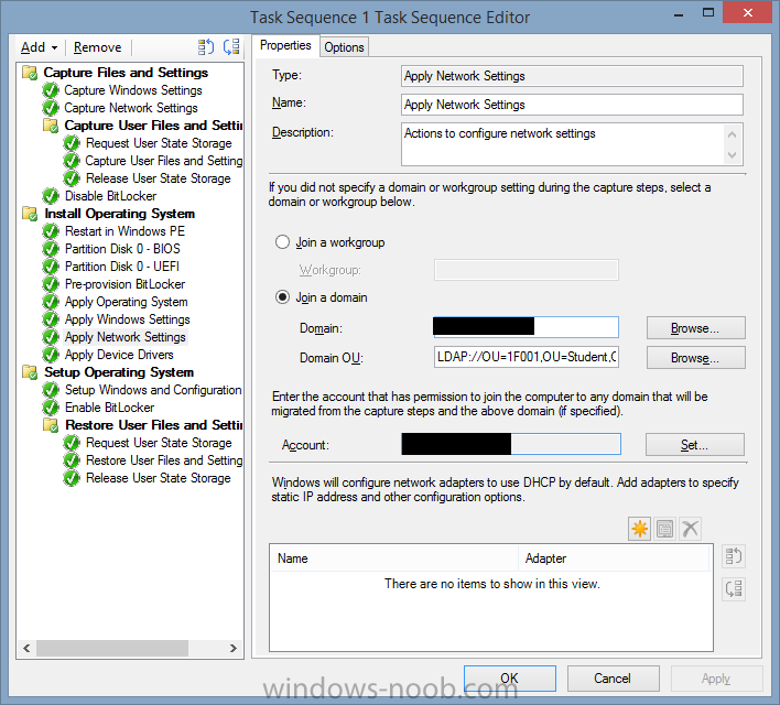

Just to add to this is it could be possible to create multiple "apply network settings" so in my case in a task sequence
apply network settings 1F001
apply network settings 1F002
apply network settings 1F003

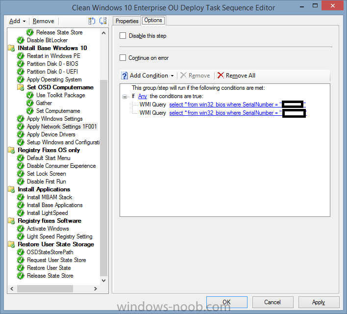

How could i use conditions so that if a Machine ID (Asset tag) is one of the following
AssetTag1
AssetTag2
AssetTag3
It is put in OU 1F001 as per the settings specified in apply network settings 1F001 (Join Domain and Domain OU)
Many Thanks ShadyCat

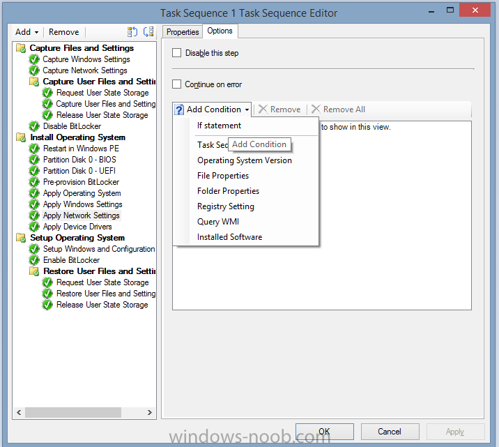

Just an update, I am looking at these conditions but it means i would have to create a wmi query for every workstation we have (about 1200)
Is there anyway i can achieve this by referencing a csv file?
Or is there anyway to edit the conditions using copy and paste for example?
