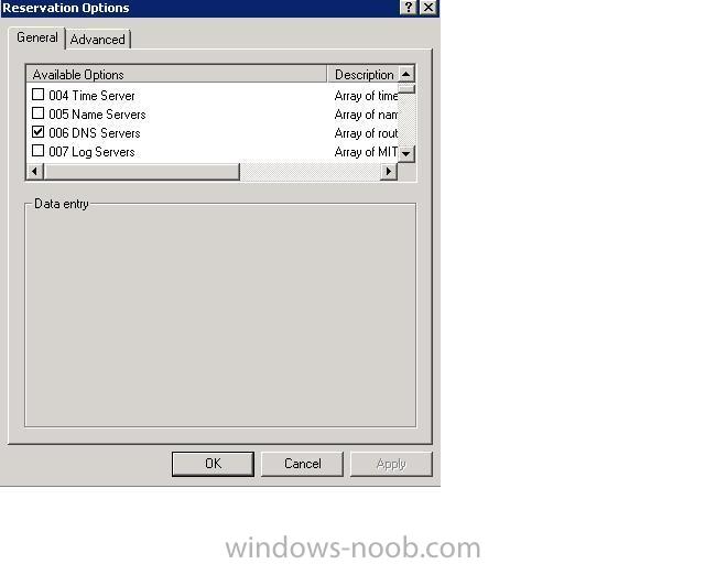

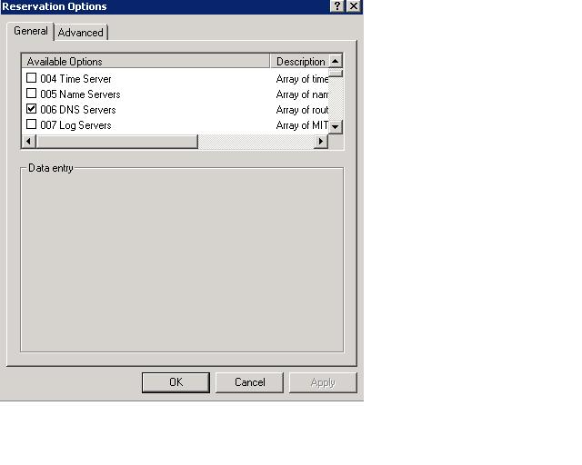

Problem : DHCP
Expl: as we work only in a fixed-ip environment, I had to set up my DHCP server with a few reservations within our scope, and put a fictive MAC-address to each reserved address. This because we have people here who take their laptops home and there they get an address from their DHCP. So when they come back to work, they'll have to get their fixed IP back in order for their laptop to function in our environment, and not an address issued by my DHCP-server.
So I configured one reserved address with the MAC-address from my client, and sure it PXE-boots. But what didn't I do : I didn't apply my DNS settings in the reservation options for the IP-address I reserved for this operation ... (see attached picture)
Even if this doesn't work, I'm still very gratefull to you for pointing out this error to me to get me a step further!!
