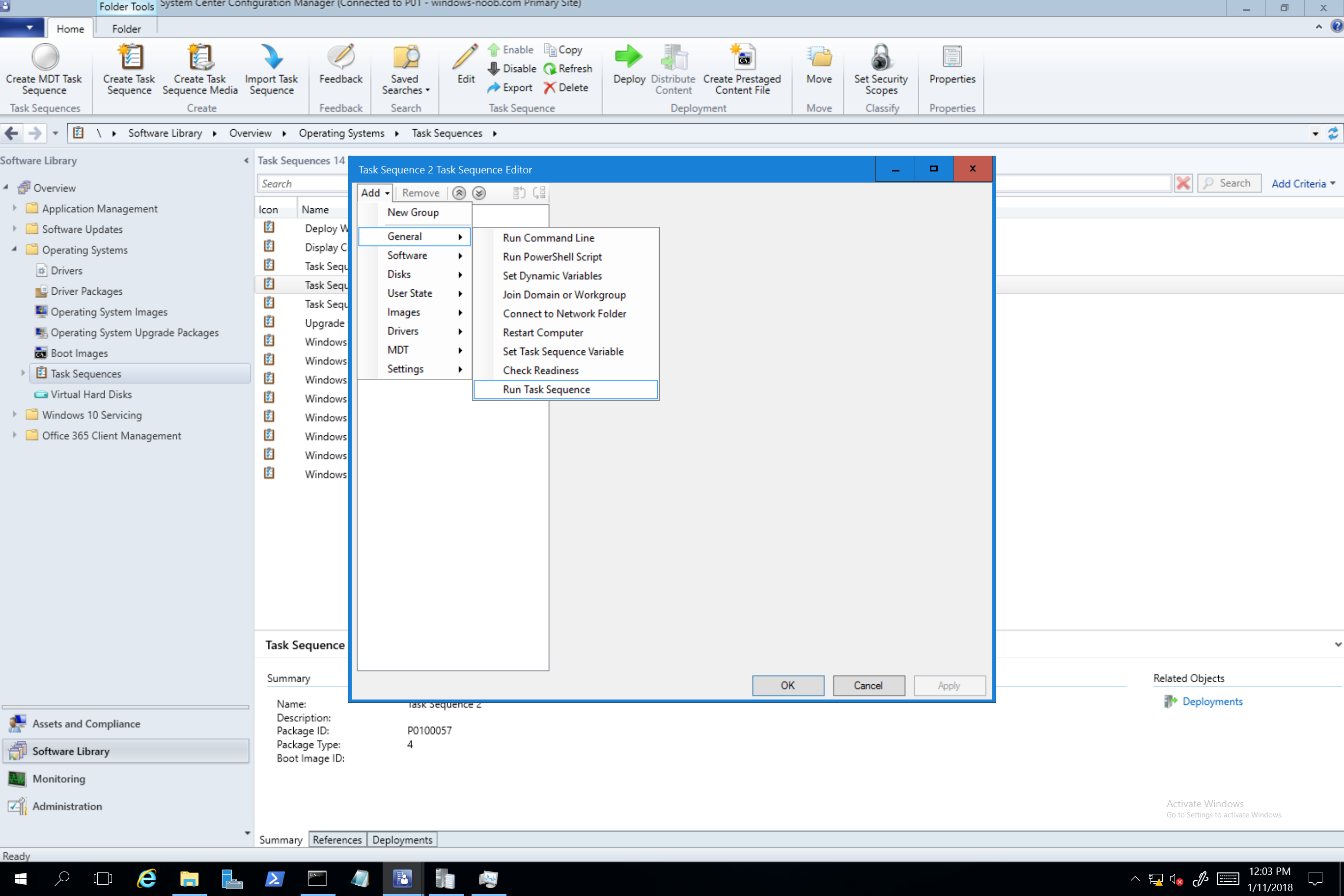

With CB 1710 we should be able to run a task sequnce from within a task sequence. I was looking for that today, and it's supposed to be under Add > General, but it's missing. It's not a big deal atm, but I am curious, do I have to do something to get that option?
Thanks,
Pär

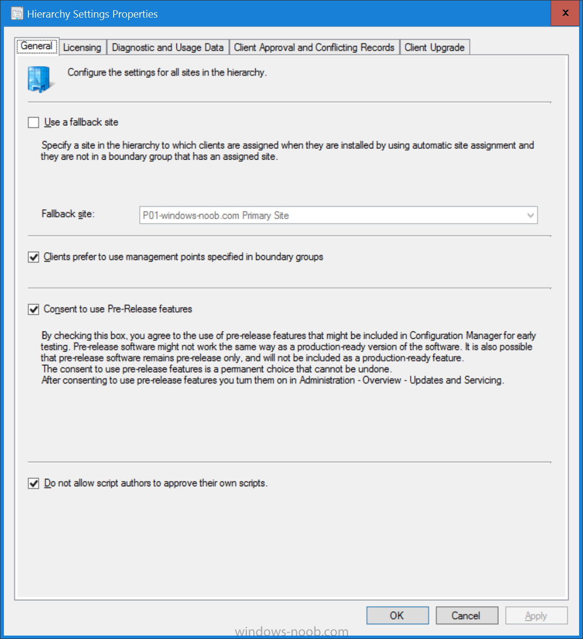

You first need to consent to use Pre-Release features as shown here.. (in Administration, Hierarchy settings)

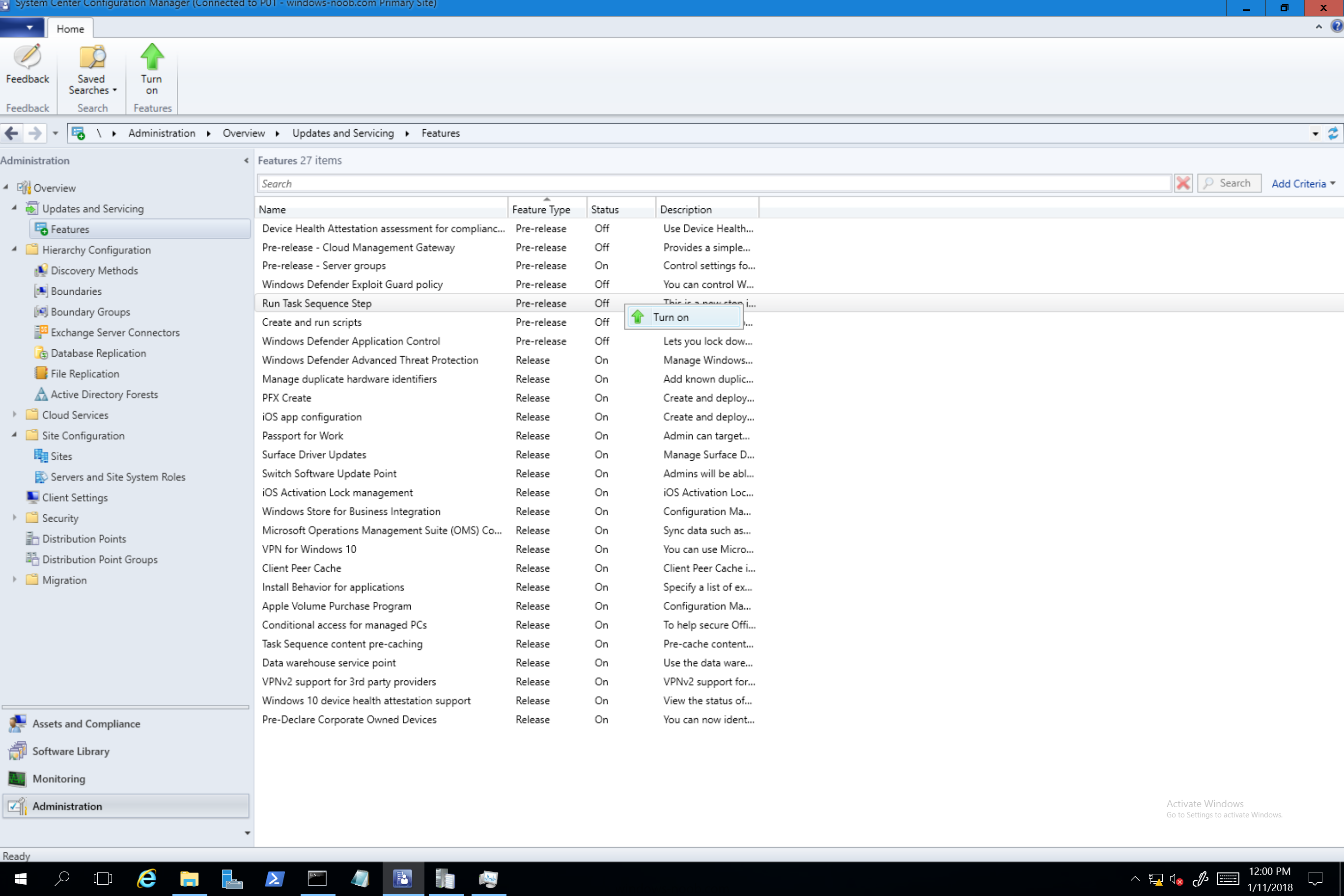

Once done Turn on the Run Task Sequence step
Then, close the ConfigMgr console, and open it again, and the new step will appear
