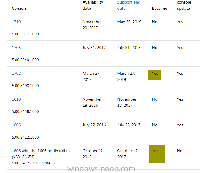

3. If it is Windows 10 Operating System, the Possible upgrade is needed with SCCM CB V1702 for Supporting Windows 10 Clients with Version 1709
Hence, We have Plan to upgrade the Operating System, SQL Upgrade.

Dear Admin,
I Understand now, that as per my Infra
It is required to upgrade my SCCM Environment to SCCM CB V1602 as Intial Level
Then
I must upgrade the Operating System from Windows Server 2008 to Windows Server 2012, SQL upgrade using
https://docs.microsoft.com/en-us/sccm/core/servers/manage/upgrade-on-premises-infrastructure#bkmk_from2008r2
Then, I must Upgrade the Configuration Manager CB V1602 to V1702 and So on.

If the Current Branch is upgraded to CB V1602 from SCCM 2012 SP2? If I Install the Role called SERVICE CONNECTION POINT
With that help of Service Connection Point? DO I get chance to upgrade from SCCM CB V1602 to V1702 Or Do I need to download the Copy of SCCM CB V1702 ISO File and Install it (For Upgrade). Please Suggest?
By Referring the following. Is that upgrade is Possible from
SCCM 2012 SP2 to SCCM CB V1606 (With Windows Server 2008 R2 + SQL 2008 R2 STD)
Windows SERVER 2008 Upgrade to Windows Server 2012
SQL 2008 STD upgrade to SQL 2012
SCCM CB V1606, Upgrade to SCCM CB V1702
After that using Service Connection Point further upgrade's. Is this Okay?
