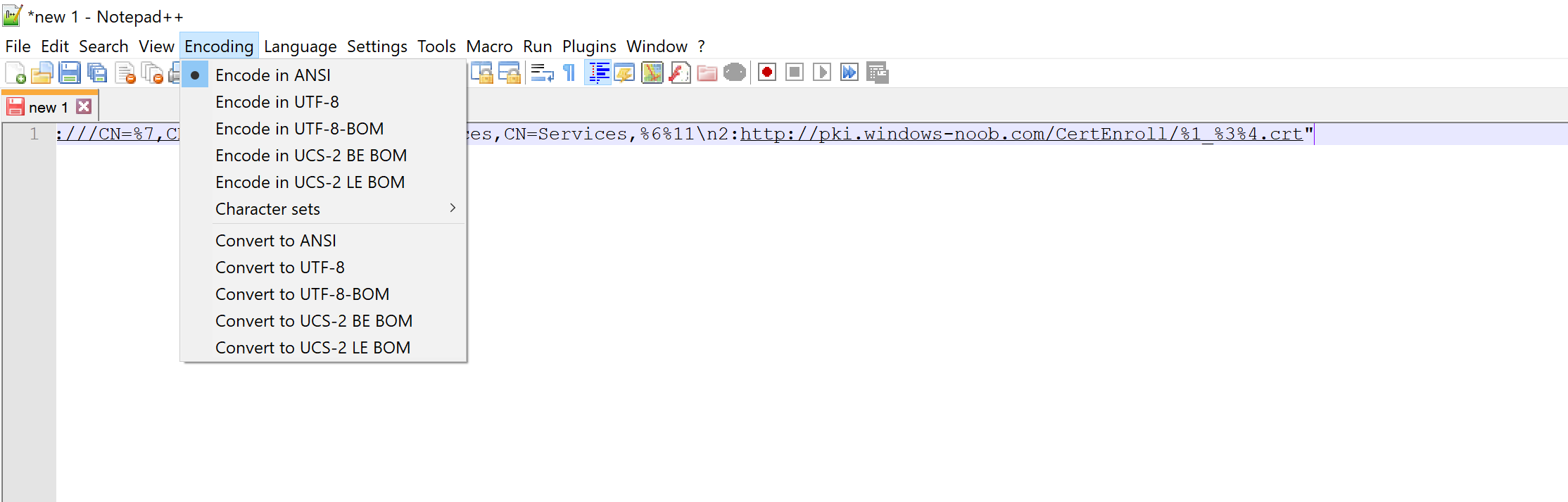

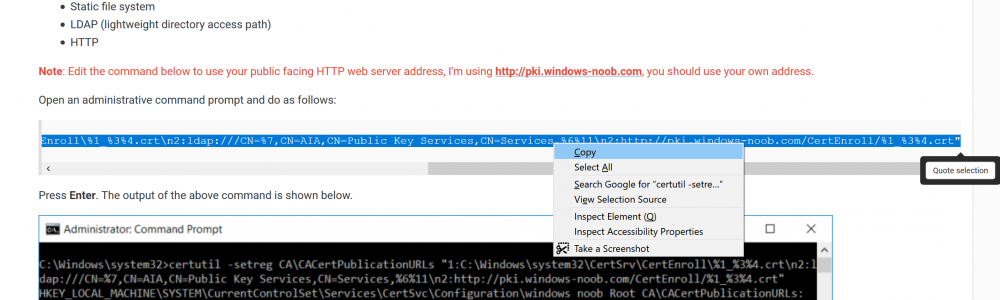

ok this is weird, i've looked at the first command in part 3 of step 4, i copied the text, and pasted it into notepad++ and even in ansi it shows Correctly ! but your paste has the hidden characters...
so what's going on, it looks fine to me now without me making any change, what browser are you using and how are you copying/pasting the text ?
here i copy the original command line
and paste it into notepad ++, and there are no hidden characters !

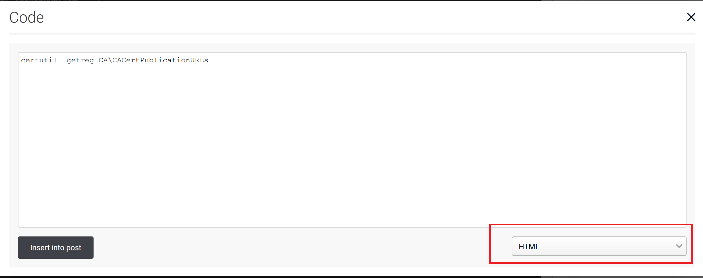

ok i've figured it out, the lines with invisible characters have the code set to 'html' where they should be set to 'no syntax highlighting'
