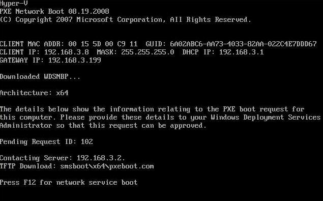

All of this data will migrate via scanstate in offline MODE while in Windows PE. So let’s get started with that and reboot into PXE to start the process. I’m doing this in a hyperV environment which is great for testing and I highly recommend you have a virtual environment for testing/demoing.

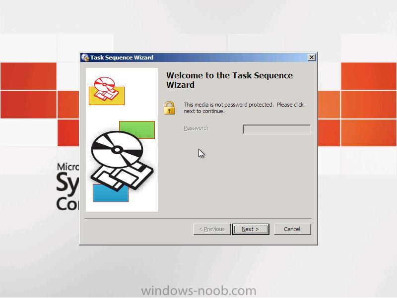

As the screenshot says press F12 for network service boot. The reason we are seeing this is because I have advertised Optional Task Sequences to my Migrate Windows XP to Windows 7 X86 collection. Having the task sequences optional instead of Mandatory means you get to choose which one you want from a list (provided that there are more than one Task Sequence). Once the Task Sequence wizard starts we can be prompted for a password, in this example we have none set so we can just click Next. If you want to set a PXE Service Point password then read this post.

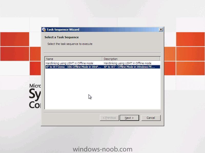

And then we see our list of task sequences, in this particular example only two optional task sequences are advertised to this collection, so that’s all we see. Select the appropriate one and click next.

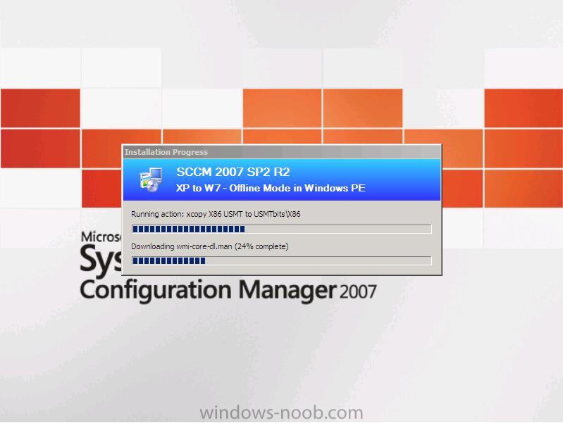

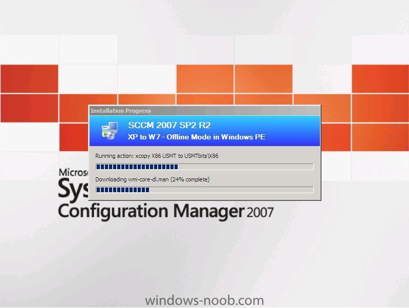

The task sequence starts and the appropriate variables are set, then folders are created and finally packages and files are xcopy’d into place.
Once everything is in place, we kick off scanstate in Offline mode by initiating the scanstate batch file which all takes place in the do X86 Scanstate step.

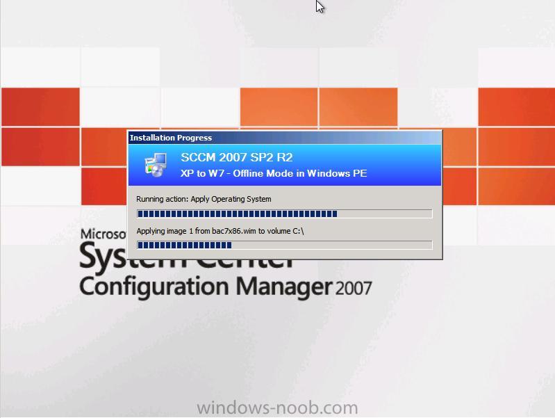

Windows 7 wim gets applied

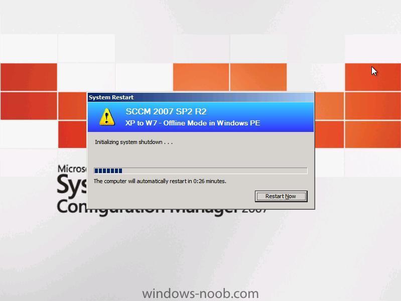

And then windows Reboots

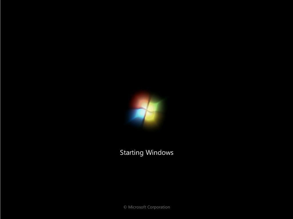

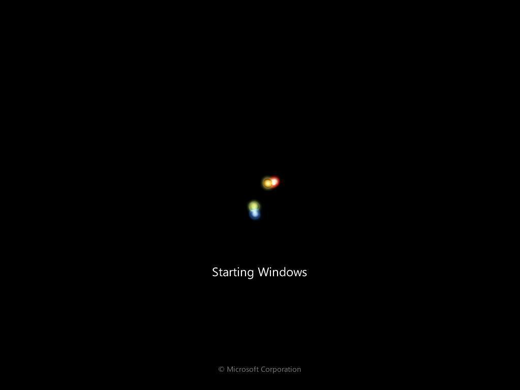

After the reboot we see the Windows 7 boot screen

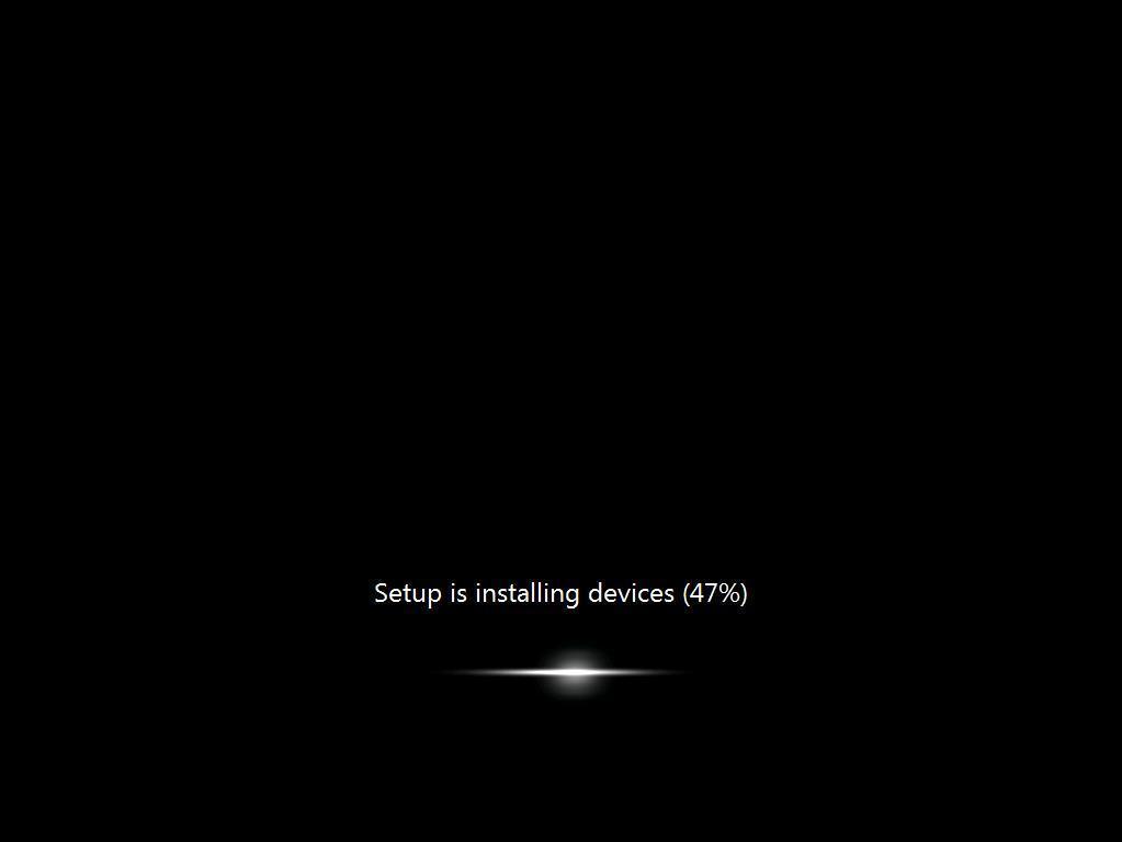

Windows setup starts installing devices etc…

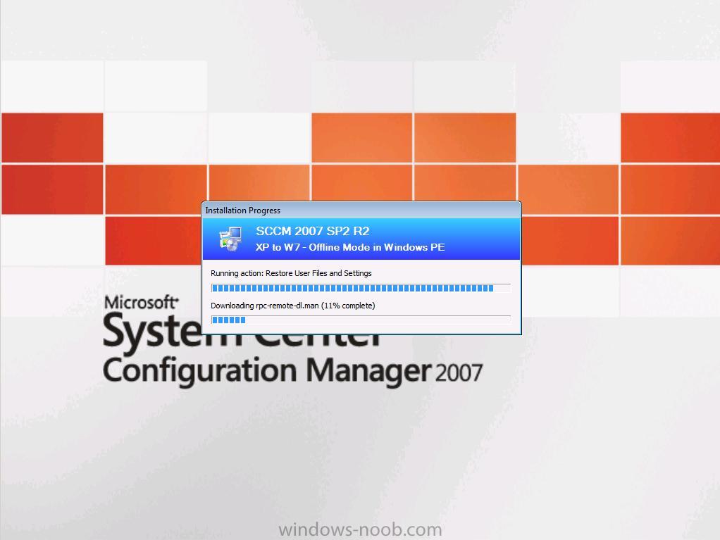

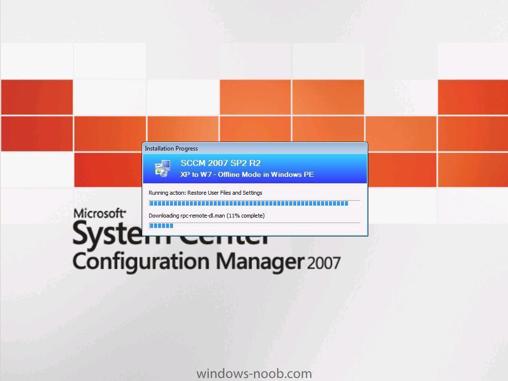

and then Restores all the migrated data (this bit requires that you set the following variable, otherwise it will fail with USMT error 38)
OSDMigrateAdditionalRestoreOptions=/Hardlink /nocompress

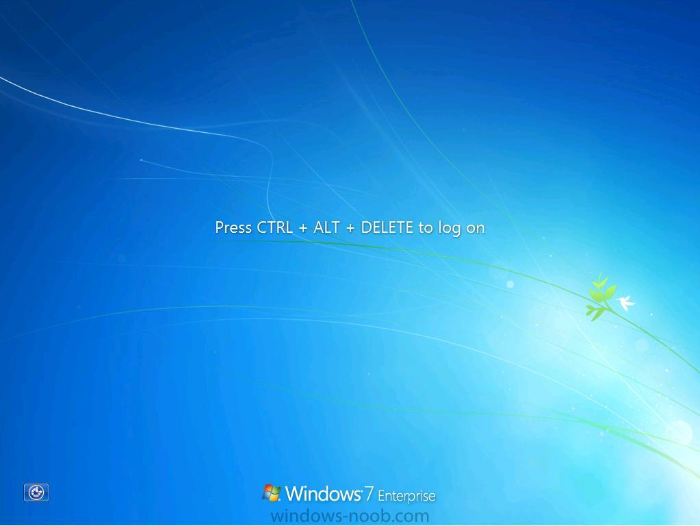

And finally we see the Windows 7 login screen.

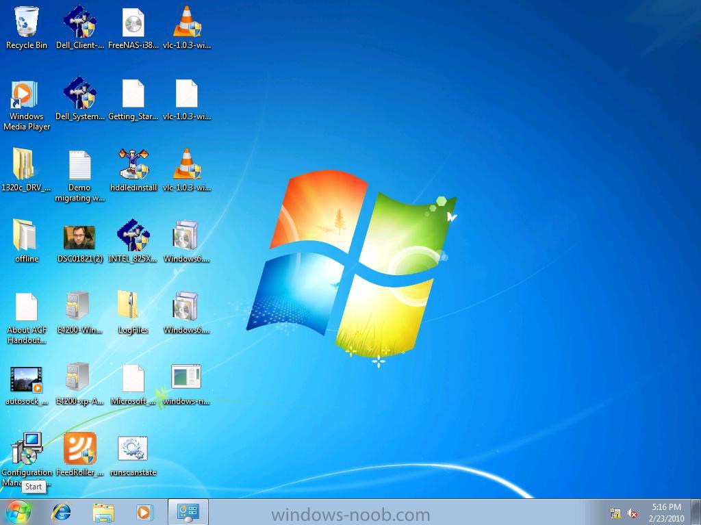

We login as the same Domain user that we migrated, (testuser)
And that’s it, the data is all migrated using Offline mode while in Windows PE. Cool huh ?
